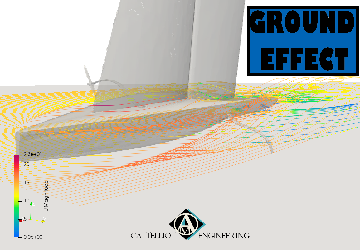

    Cool stuff. The spray coming off the leeward foil in the pic of Luna Rosa, and your flow lines at that area look very similar- and also the splashing at the aft part would seem to be in less wind pressure, again, as your simulation shows, unless I’m reading too much into it. Kudos. How high from the water is your simulation? I wonder if the LR has a sweet spot, as far as height from the water of the keel, and characteristics of airflow? Maybe a dynamic of boat speed, wind speed and sea state?
    I wonder how much difference there is between Ground Effect and end plate (keel touching the water) - my hunch has been endplate might help during takeoff, but possibly detrimental at speed?

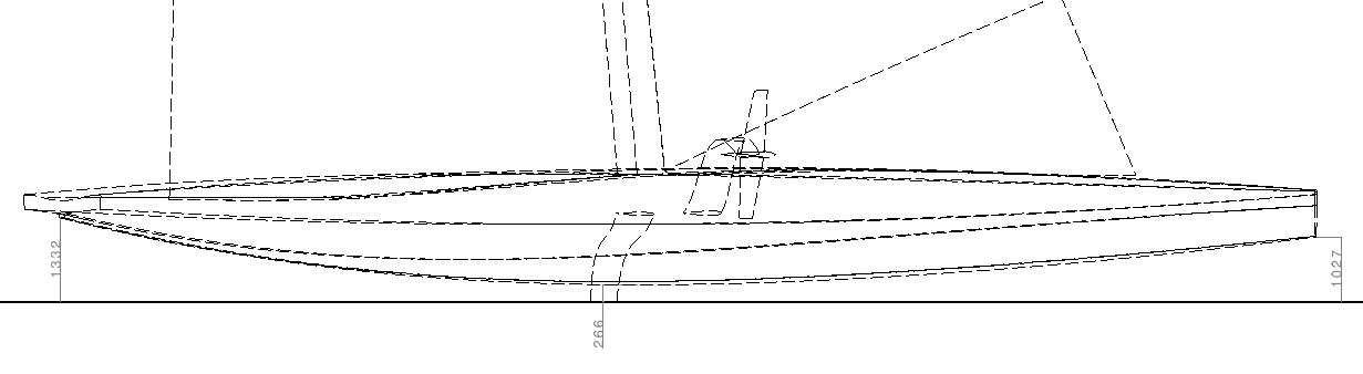

    Thanks, Paul. These are the heights that I used by now for the simulation :
    I think that I may be build a test matrix, to at least have an idea of how bottom shape and fly height may affect this ground effect. Let's see... How about this :
    └┬┘ └─┘ ├─┤ \_/ \--/
    3 heights : Touching the water, medium, Maximum
    3 apparent wind speed : 8kts, 25kts, 40kts​
    ISO Longitudinal Center of Gravity, Total Volume, Displaced Volume, Frontal Area​
    It may also brings additionnal informations to Wetfeet, if pressures are presented for both sides of the boat.
    It is sure quite tedious to mix aero and hydro calculations. In this small exercice, I wish I could keep the feet of this problem out of the water. Do you think the test matrix could at least be of some meanings ?

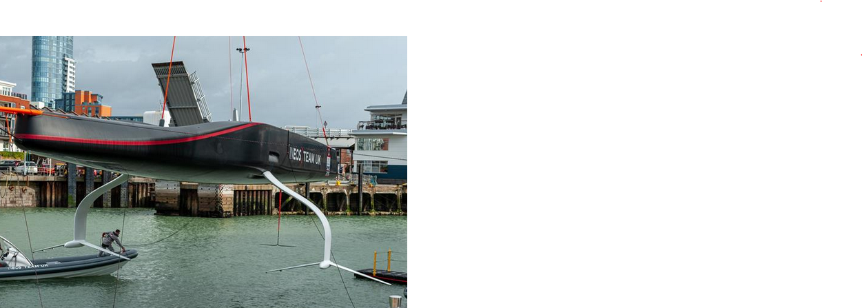

    And could not be but amazed by the evolution that has been made in the design of INEOS Britannia II
    Not to mention the test of a keel plate that has been performed between the two version :
    Considering the simulations that I've made so far, and looking at the work of the british team INEOS, I agree very much with your comment, Wet Feet. The Ground Effect and the reduction of the Parasitic Drag may have been quite an important amount of work ; in particular around the keel plate and the hull shape. What is the exact role of this keel plate ? I wish we could have some hints by flow visualizations. Comparing the simulations results with the work of "the Brit" will certainly be of a help. Stay tuned...

    Thanks for the link to that thesis which I will attempt to digest over a day or two.I am wondering whether the keel plate is performing the function of a "waterski" as the boat drops off the foils and as such helps to delay the dramatic increase in skin friction as the hull and foil arms descend.

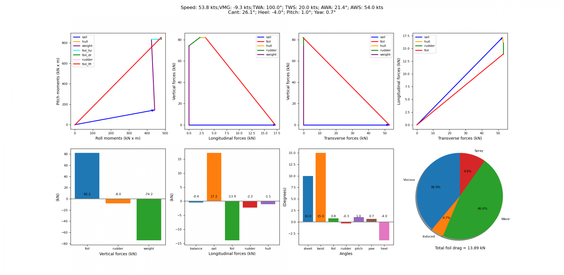

    If you look at the AC 75 drag breakdown attached, you will see that there is not much to be gained in the hull air drag. Foils are most important, even tha rudder twice as important as the hull. And of course, the "negative drag part", sails + mast.
    Alan Cattelliot likes this.

    The diagram is theoretical, from a VPP for a generic AC75 which corresponds fairly nicely to measured sailing data.
