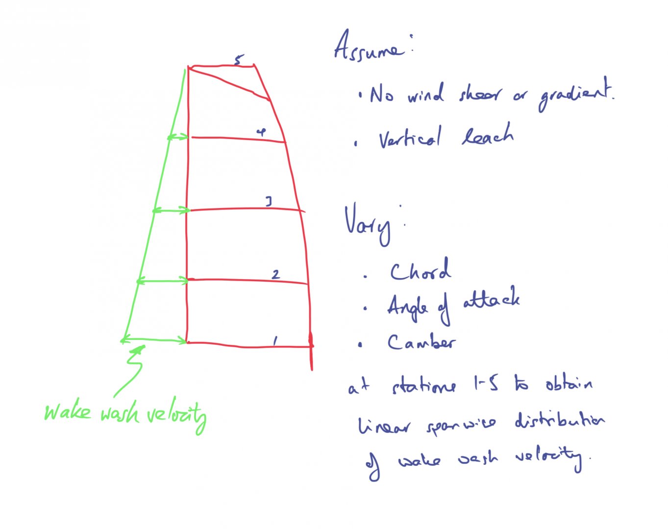

    Tom, does a spanwise linear wake wash velocity distribution also imply a linear variation of downwash angle along the span and a linear variation of induced drag?
    Does the attached sketch show what you mean for a simple case?
  5. tspeer
    Joined: Feb 2002
    Posts: 2,317
    tspeer Senior Member
    If the freestream is uniform, then linear wake wash does imply a linear downwash angle. However, if the freestream is nonuniform, then the angles won't be linear.
    The induced drag distribution is not linear because the induced drag is the product of the downwash and the local lift, and the lift distribution is not linear. Take the classical isolated elliptical wing, for example. The downwash is uniform, but the induced drag is not uniform along the span. Instead, the induced drag varies in an elliptical manner because of the lift distribution.
    Yes.
