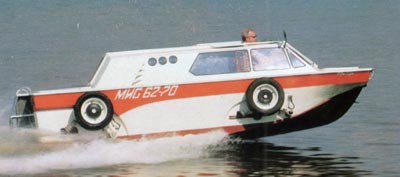

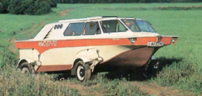

  5. Nnnnnnnn
    Joined: May 2012
    Posts: 60
    Likes: 1, Points: 8, Legacy Rep: 12
    Location: MOW
    Nnnnnnnn Junior Member
    some pictures as inspiration :)

  7. whitepointer23
    Brilliant. Do you have any info about it.
  8. Squidly-Diddly
    Joined: Sep 2007
    Posts: 1,764
    Likes: 133, Points: 63, Legacy Rep: 304
    Location: SF bay
    Squidly-Diddly Senior Member
    Yep, those pics by Nnnnnnn are pretty much it, although I'm not in love with the way they included the required headlights. Looks like the tires would double as boat fenders.
    Looks like they swing down and at least the rears have motorcycle type chain drive?
    I'm also thinking of more liveaboard lower preformance larger craft, and BARELY roadable.

  10. waikikin
    Joined: Jan 2006
    Posts: 2,378
    waikikin Senior Member
    Looks like it could be part of the thunderbirds range. Needs a number though.
