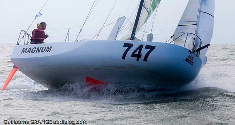

    I like the reverse bow as well-looks good. You might consider that in the Volvo 70's and especially in the Open 60's the daggerboards are angled opposite the way you show them so as to generate a bit of vertical lift. Three of the Open60's have even gone to curved lifting daggerboards similar to the ones pioneered in the ORMA 60 multihulls.
    I tend to like the reverse sheer too-but the waterlines -as shown- seem to be wrong. The reverse sheer on a low freeboard boat allows for decent freeboard midship when the boat is heeled-so not a bad choice technically.
    Best of luck-your desire to learn is admirable-keep it up and good luck!
    Pictures-click on the image for larger size. Note how the daggerboards on Groupama(VO70) are angled outboard at the top so that as the boat heels they will develop vertical lift as well as lateral resistance. On Virbac-Paprec III, the board appears as though it is angled in the traditional way(vertical when heeled) but because the board is curved(pix #2 and rough sketch 5) the board actually develops vertical lift when heeled with the board at a substantial angle(bottom of the foil inboard). I included a rough sketch of the difference between old and new straight daggerboard angles and another showing how a curved board can be angled inboard at the top ,like a traditional board and yet angled inboard at the bottom like the modern straight boards. An advantage of the curved board is that the angle of incidence of the vertical lifting portion of the board can be adjusted independently of the lateral resistance portion of the foil by simply pivoting the board top fore and aft.
