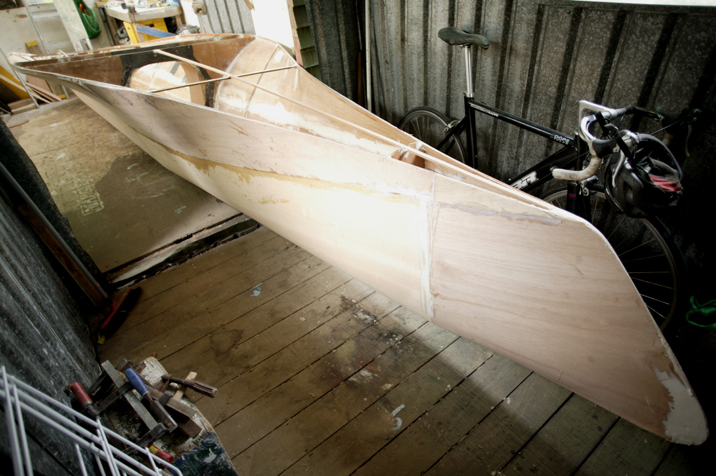

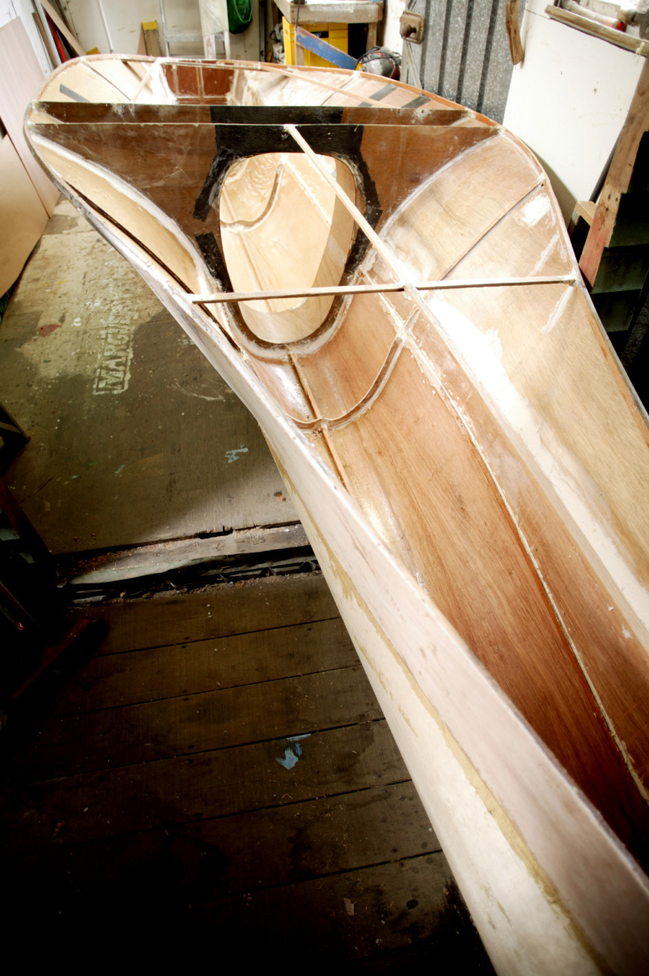

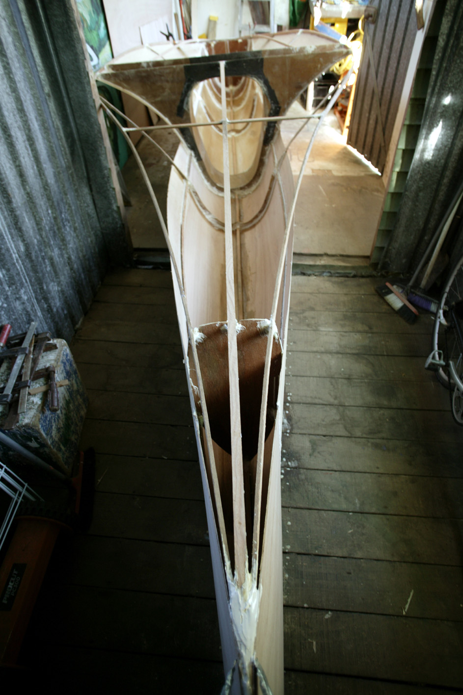

    The skeleton of Sid 650 lay untouched in shed for 3 months or so - but I did build the foils and T rudder; however got some 3mm ply and started skinning the framework.

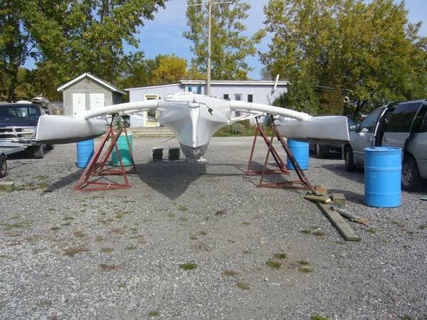

    photographs:
    John Patterson 6.5 - an inspirational design; Sid will be wider overall (7m) but similar main hull dimensions.
    Jacques mini-Transat 6.5 Charles design

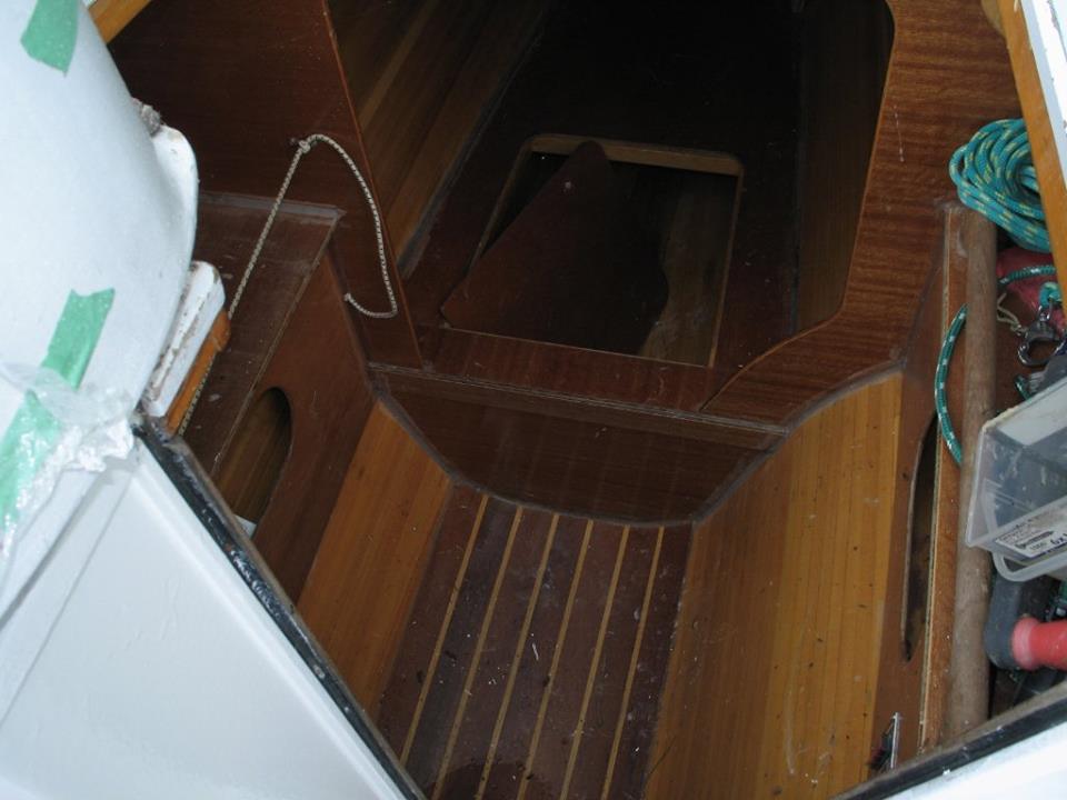

    The real beauty and "modern design" can be seen looking at her from front... see attachment. And it seems enough space under deck for one person at least (Source of pic: Tom Henry @ FB)

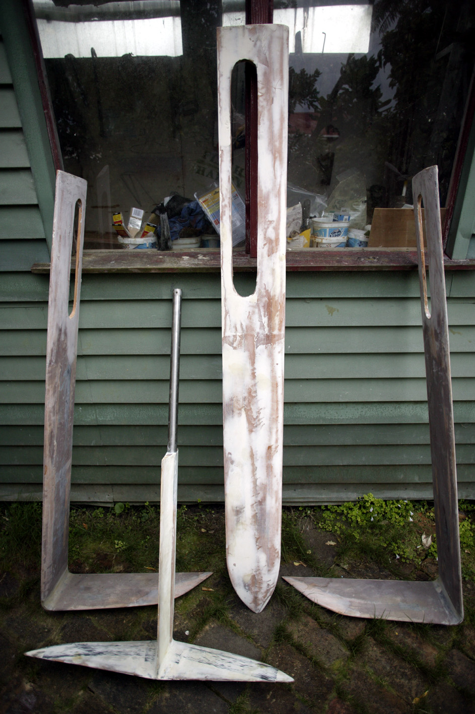

    Few more Sid 650 shots. Jacques came round yesterday ... long discussion of how to swing the main beam, thinking about many alternatives, one being reduce the beam to 6.5 metres and have it being able to be lifted out, stored on trailer beside main hull - another where don't have any floats at all, just a swelling at the top of the foils, my suggestion, sounds very dangerous - eh Doug Halsey? Have I your courage?

    Barry, thinking of very similar solution to yours at the moment ... but that for sure will change; (because I'm so fickle) will finish main hull first and then make the BIG decision.
    One alternative is to have a lower cuddy, half the height of the main beam, square mid section of the beam sits into female box across the hull in front of cuddy, there is a tubular bearing (which also carries on top wing mast male bearing) - that allows you to lift the beam halfway up and out of the female box so the beam can pivot to fore and aft for trailering, sitting on top of the low sized cuddy. Simple enough??
    That way I don't have to connect the cuddy to beam (so beam and cuddy pivot as one as formerly planned) - cuddy is fixed ... and no waterproofing problems compared to earlier idea.

    Here are the various foils.
