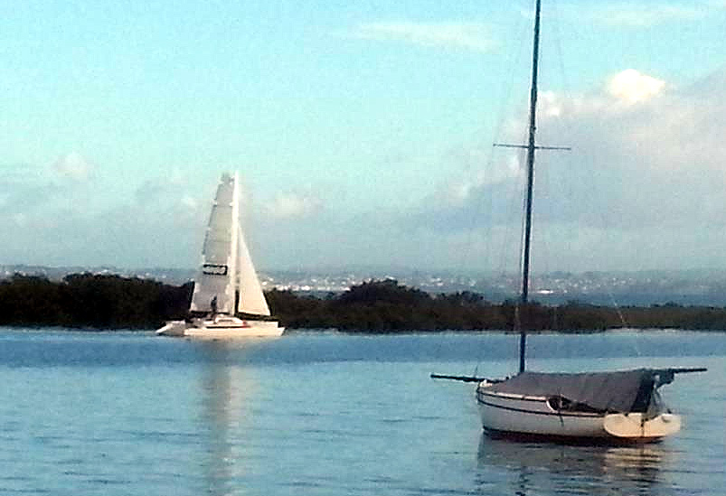

    Sailing on big Sid, (11 metre Groucho) a couple of weekends ago with Jacques de Reuck. in very light, actually non-existent winds but lightweight Groucho (650kgs) just slid along at 4 and 5 knots.

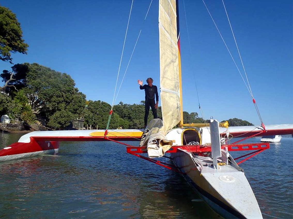

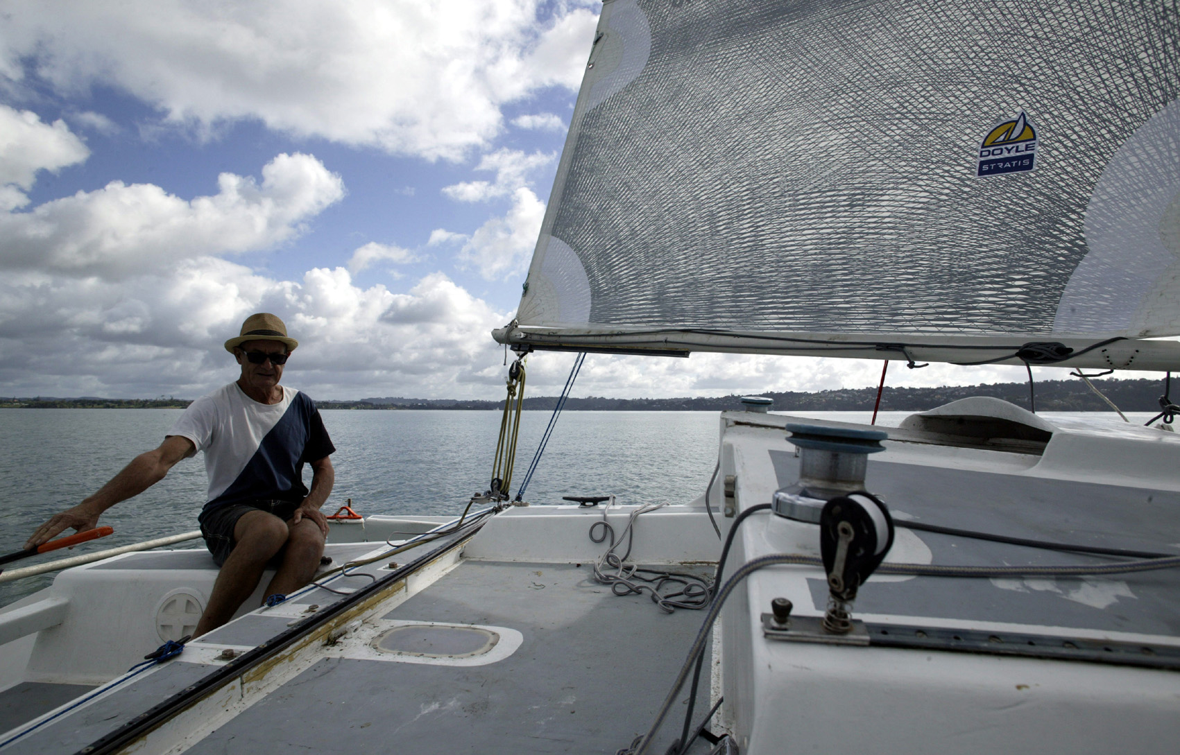

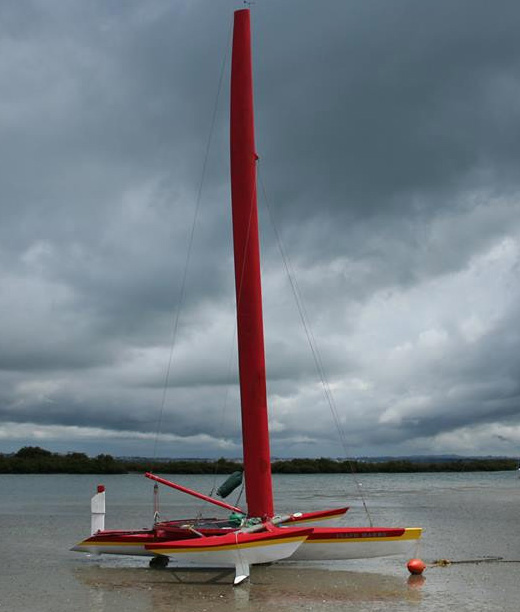

    Well today I went sailing on Jacques' Shifty (radically altered Farrier 24) with Flash Harry's old mast (plus added carbon) with a beautiful new Doyle main; first sail with this setup - and Monsieur J was very happy and impressed. We had an old jib as a make-do headsail until J receives his new Doyle flattie ... but what was really impressive was dropping the jib later when wind increased and sailed una with just wing mast/main; Shifty immediately began to point maybe 5-8 degrees higher along with acceleration.
    No-one here in Auckland believed me when I have/had repetitively bored them years past that a wing mast/flat main will way outpoint conventional setup.

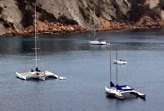

    Oh yes, Stuart Rogerson, the original brains behind the French Golden Oldies multihulls, visited and we sailed on Groucho a day or so before said cyclonic winds arrived, crappy weather with rain but he was flying out next day so sailed reefed down and he steered for some time; Groucho behaved decently and went okay. Stuart and his son Zack repaired the famous VSD Kelsall trimaran and also the Charles proa Tahiti Douche. You'll know all about that proa, no?
    Here's also a shot, after the ones of Shifty, of VSD and Tahiti Douche at Ibiza, where Stuart lives ... and regularly does the trip up to south of France for Golden Oldies regattas.

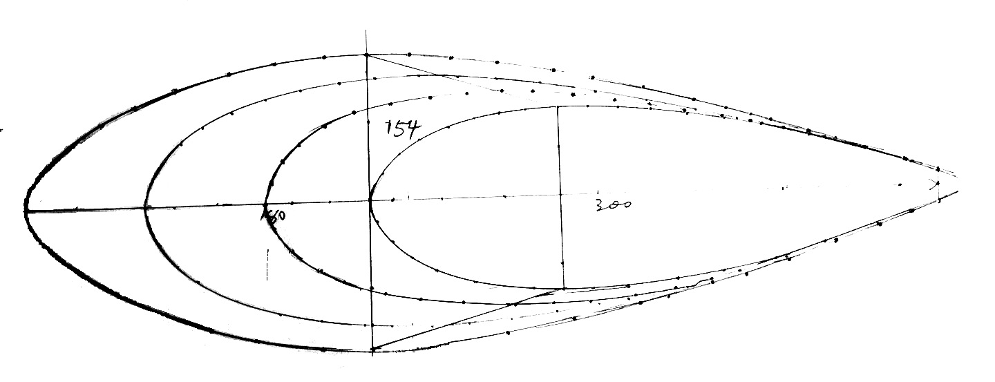

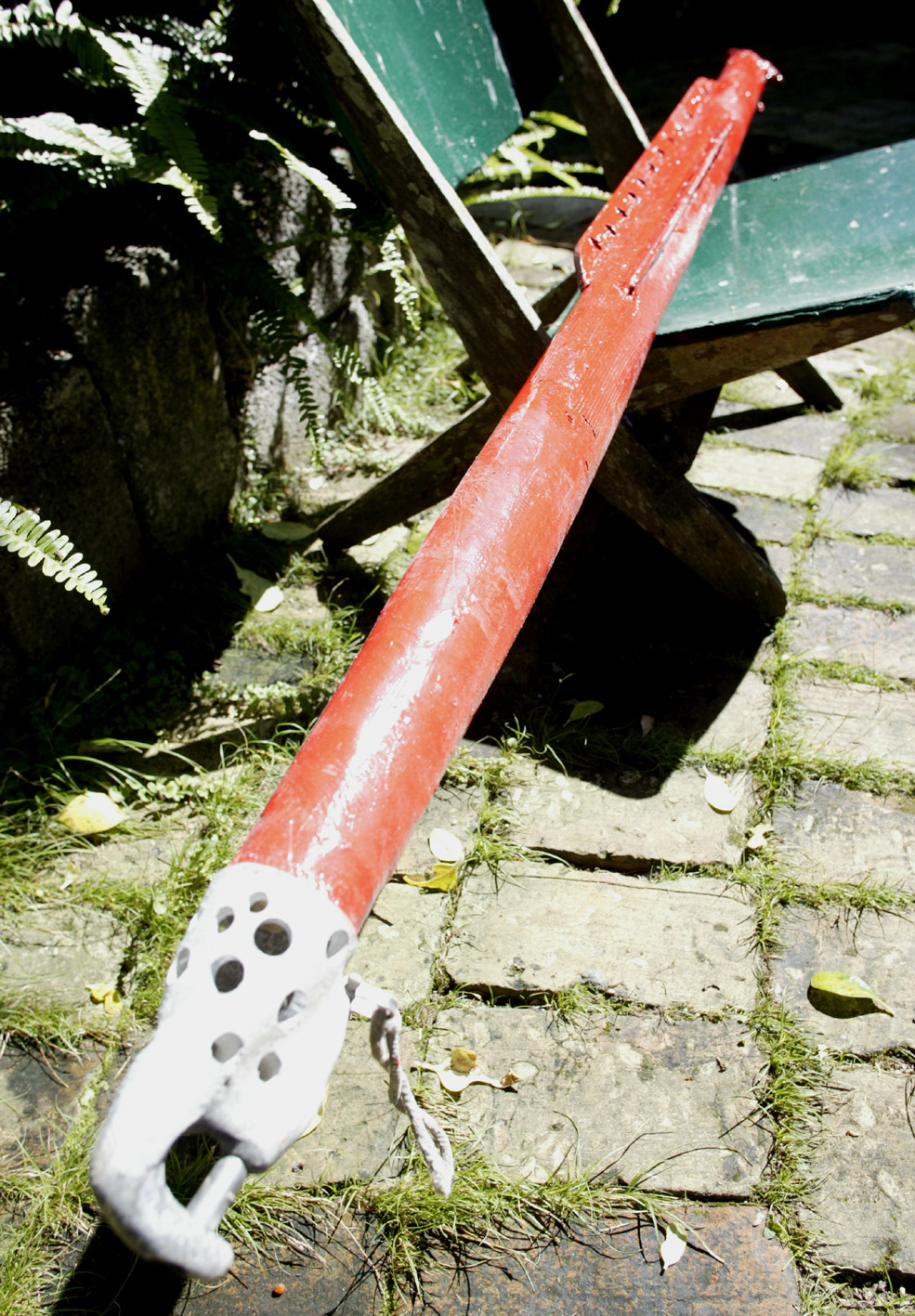

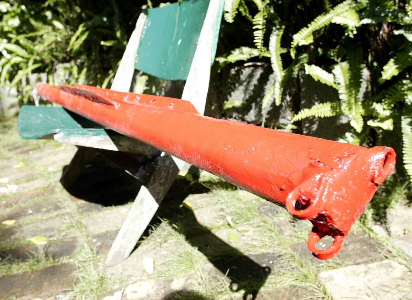

    Increased the height 300mm of Flash Harry's/Shifty's mast to 9.3 metres; straightened the above hounds curved luff and bent back the above hounds leading edge, (see photograph of original shape) cut and paste job, some fiddling and cheating but looks fine now.
    Yes, will also cut and paste Sid back together, coming along slowly, will go down this afternoon when tide drops.

    Nothing special about my booms; this is the 650's, bent ply (actually it might be thin alloy tube) with carbon laminates and stiffening flanges. It is Flash Harry's old one with some adaptions to fit the 650. If you use alloy the first stiffening laminate HAS to be glass, then the carbon.
    The wing mast cross section is Sid's 11.5m x 500mm - which would be fine for a 13 metre version. Lay three layers of uni directional carbon each side at thickest mast area section for extra stiffness. The near central I beam is 4 mm ply with flanges where the bent ply skin is attached. If you can be bothered searching "alternative to marvelous B24" thread, you'll find more information. Otherwise send me an email: coxcreek@slingshot.co.nz.

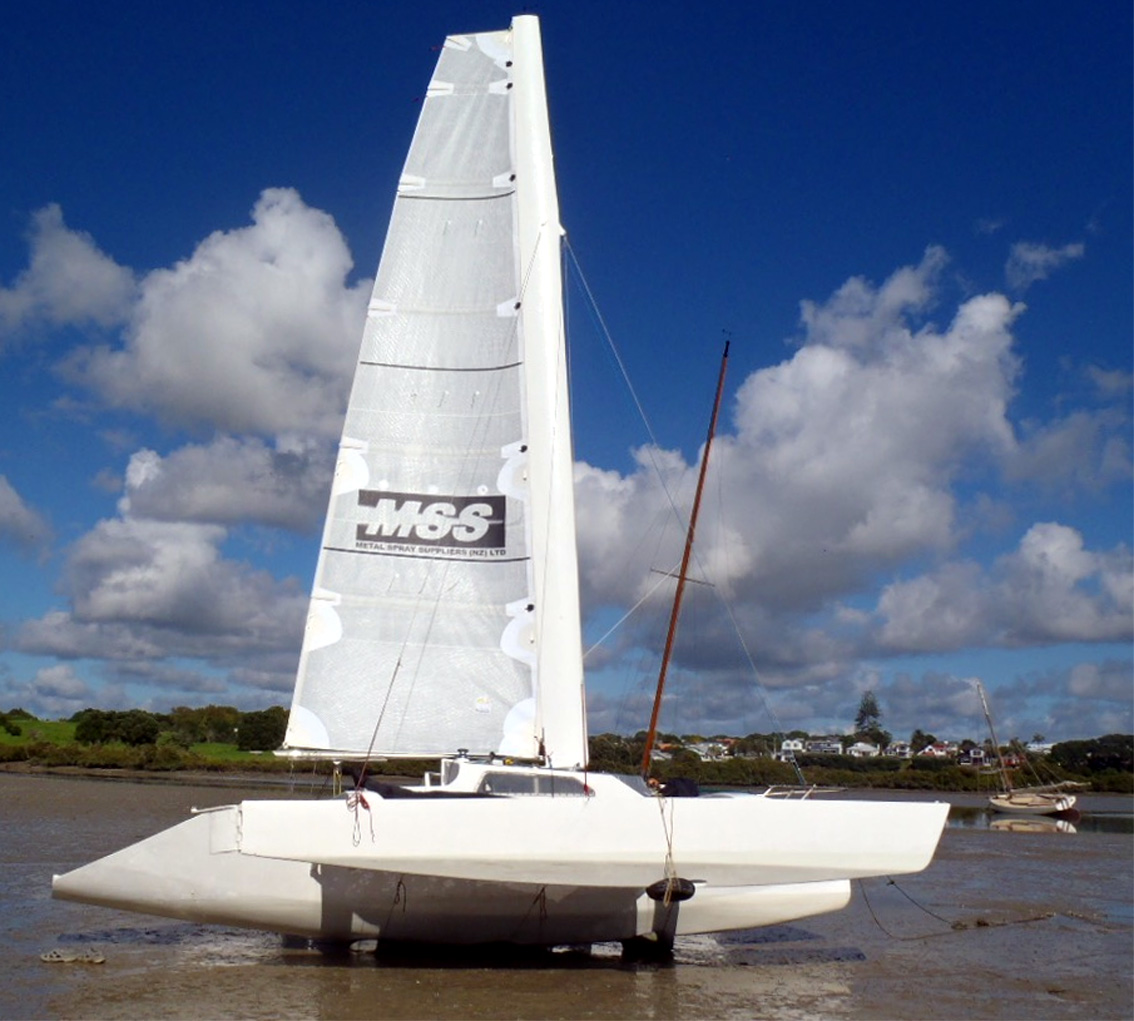

    Here's a recent shot of Groucho in Auckland's superb weather (mostly, in between cyclones) - getting the main up the 6mm bolt rope track requires concentration and careful feeding.
