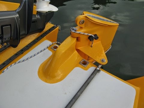

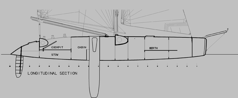

    Hi Corley
    I like this rudder on a dutch fsr 32 farrier. It kicks back if you hit something, and slides up and down like most dagger rudder blades. I hope my picture is attached and shows what I mean.
    nelson

    Hi Nelson,
    Thanks for the suggestion but this design isn't really suitable for a transom mount rudder. It could use a breakout or hinged cassette inside a slot though which Kurt has drawn I am intrigued by the hinging transom idea though.

    Hi Corley
    Yes I have thought about this before. The problem I can see is that the rudder blade has to be straight forward for the cassette to swing back if you hit something or the cassette has to extend down past the hull enough for the rudder to clear the hull if it is turned while hitting something. I had not considered the swinging transom.
    If Gary is building more interior space he must be planning to sail further afield. More chance of running aground. I definitely like the kick up option.

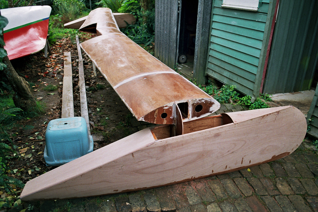

    Got to remember it's only 6.5 metre overall and down below, although I pushed myself to make a larger main hull, is still like living confined under a coffee table. You could sleep okay and sit with head out of hatch. It is live with what you've got.
    The concern of hitting ground with rudder. We sail a lot in the extensive areas of upper Waitemata which is full of reefs and shallow banks; that means keeping the sloping dagger well down as a feeler guage because it is deeper than rudder. We are talking of water depth of less than waist height. And so far after decades of sailing here, we have survived okay. You need to know where the shallow ground is of course. Also clear water is definitely a help. I would rather the feeler guage dagger than the complications and messiness of kickup rudders - which are not much use on T foil rudder designs anyway, in fact bit of a curse.
    Here is an early (grainy film) shot of Sid and Power of 2, tide around a third of the way out; you can see long Meola Reef starting to show in distance; this is the area where we day sail.

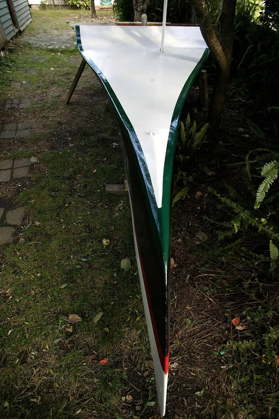

    Gary Baigent Senior Member
    Got some paint on the 650.

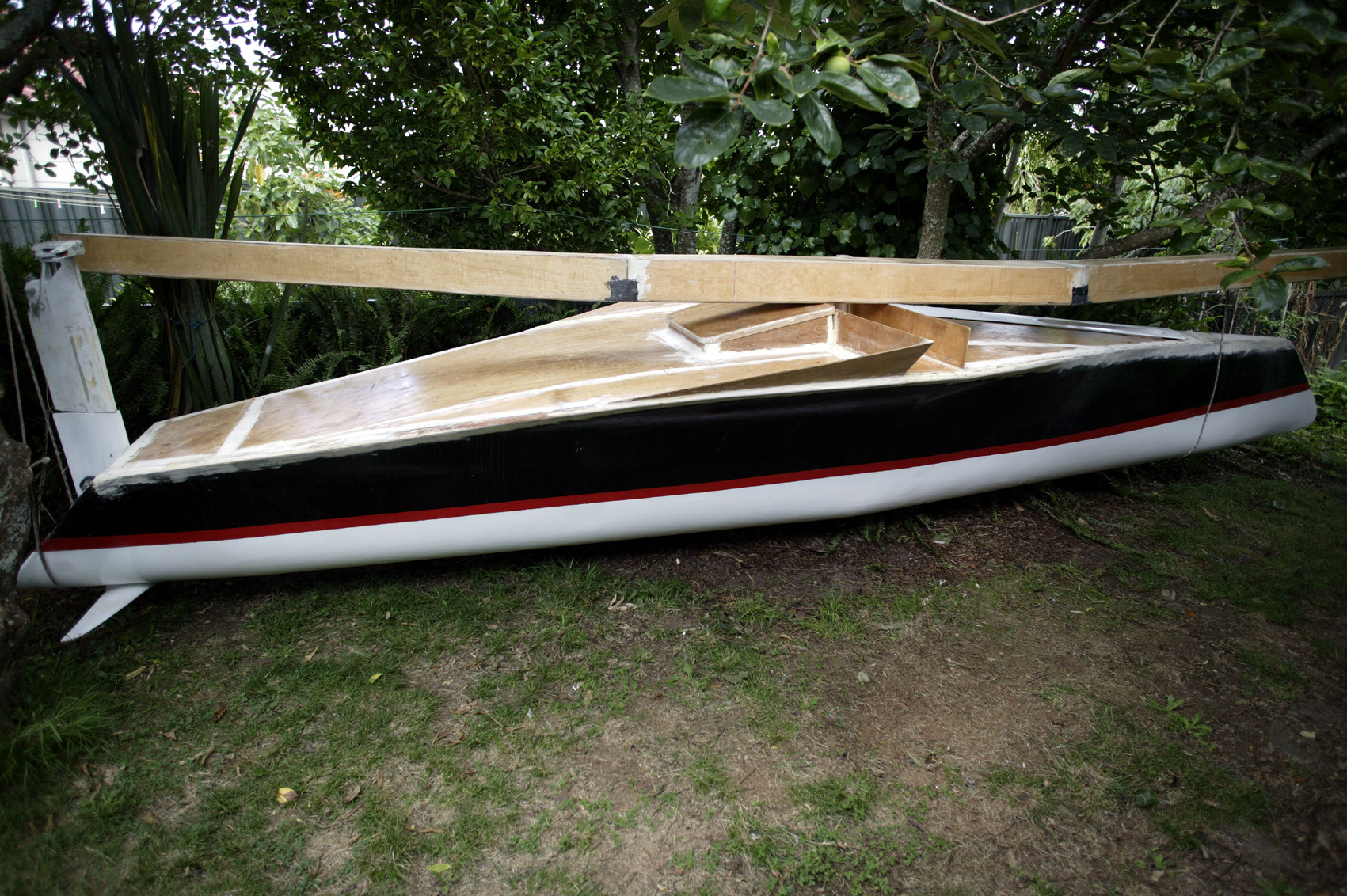

    santacruz58 Senior Member
    New paint
    Looks good Gary. Looking at the way your beam mounts, I take it you aren't going with the rotating bearing and beam mount. I am guessing that you just want to be able to take it out of the water in the fall and not have to worry about having it on the mooring as you have enough boats to look after.
    No, I'm persevering with the movable beam. Means to swing it requires lifting up from the U beam nest/base and swinging it fore and aft. The male bearing is tall enough to retain the pivot point position. Mast of course has to be lowered first. The floats will have to be small and the foils lifted or removed, haven't decided yet what I'm doing there. How about two sets of foils each side, no floats?

    Hi Gary
    Will the beam be light enough to move with one person?
    Nelson, you're talking about Nelson (province) where I come from and the area you're interested in is Abel Tasman National Park and maybe also the harbour on west coast side named Westhaven. For sure, beautiful areas but it is not bad up here in Auckland either with Hauraki Gulf, Coromandel, Bay of Islands (see photographs of Rawhiti - where I lived for a year). However, I think you're meaning the north east top of South Island and that is the Pelorus and Marlborough Sounds. You get no wind or savage williwaws there, also a fast tidal current at French Pass. There are famous etchings/drawings of early ships going sideways through there.
    The beam is easily lifted by one person. However to lift it from the bed requires walking round to both sides, levering a little each time and placing blocks until it clears for swinging. With two people is much faster.

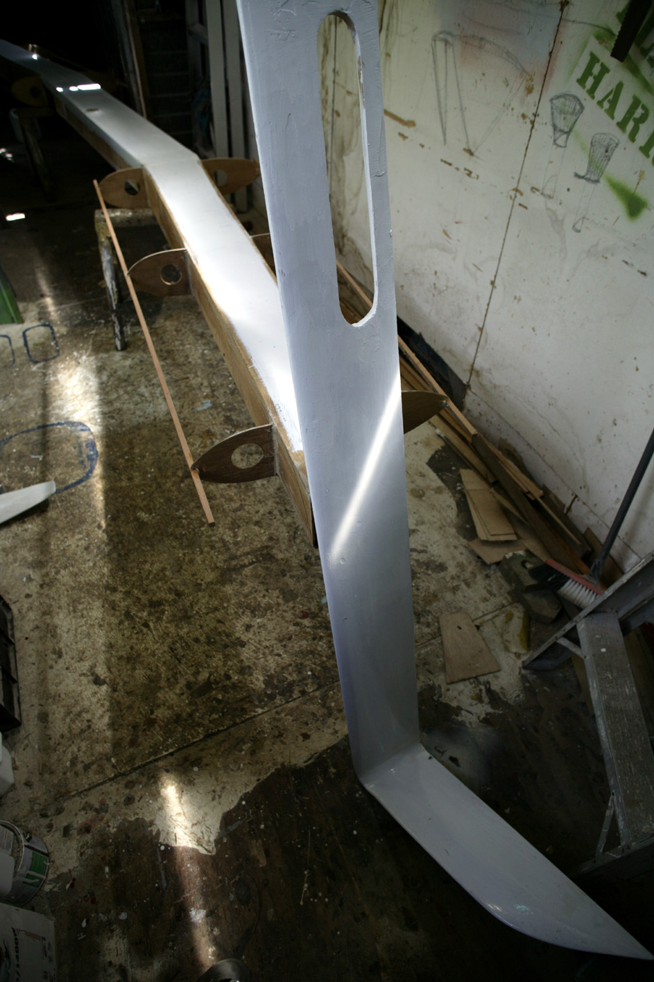

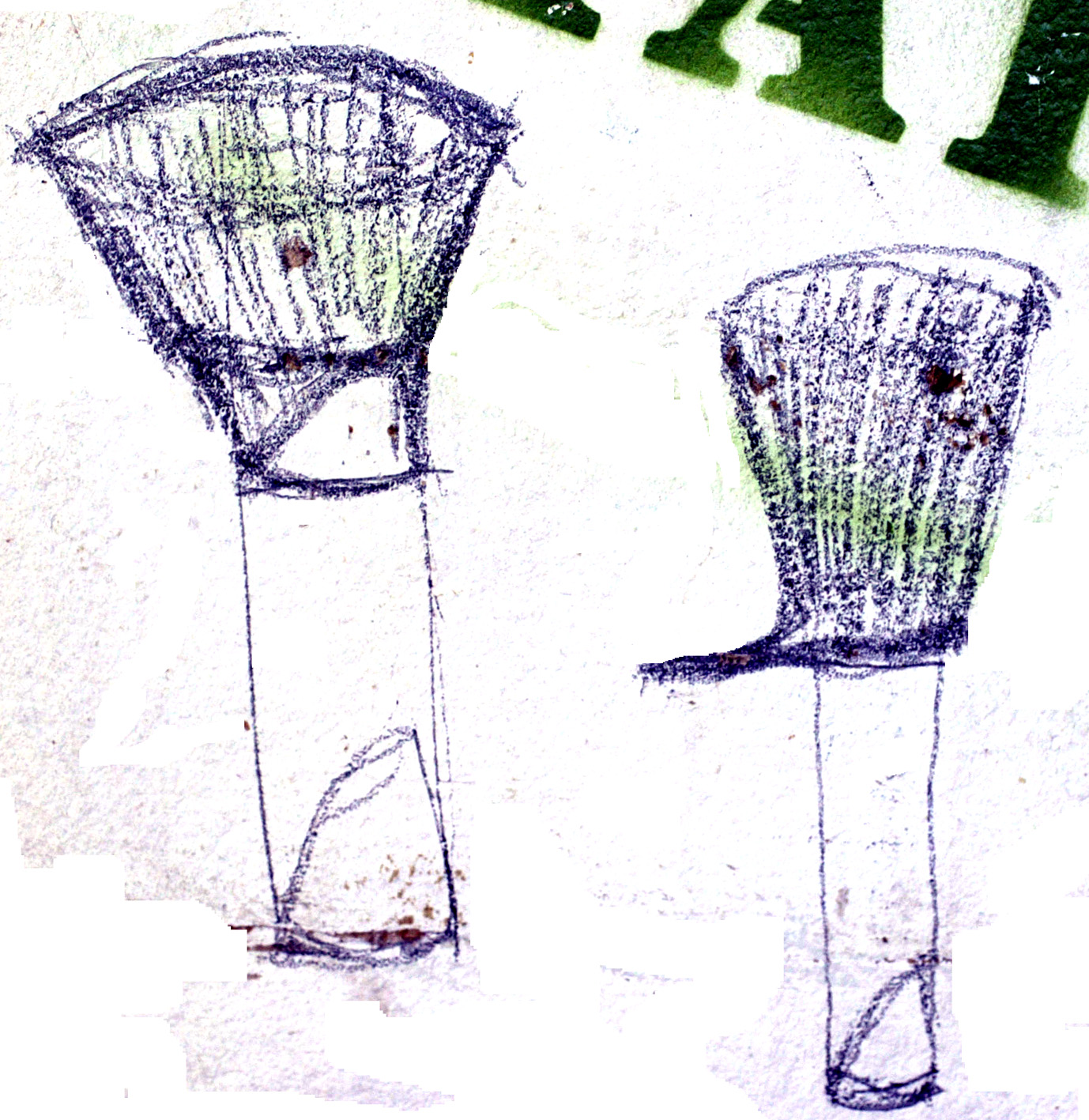

    Graffiti ideas on my shed wall: how to connect foils/floats to beam - how to keep weight down - how to not bury foil/float in hard gusts?
    left and centre: swelling case and double foils - right: single foil and planing base to upper fat section, planing shape set at 5 degrees attack or so. - far right: loose mockup, foil will be set lower than pictured.
    Also the lifting section foils could be either facing out (as I have in the sketch) or facing in (I can switch foils round from port to starboard) - realized that when foils lifted and the beam swung fore and aft for transporting, they won't foul bow and stern of main hull - even if facing inwards. Confused? I was too for awhile.
