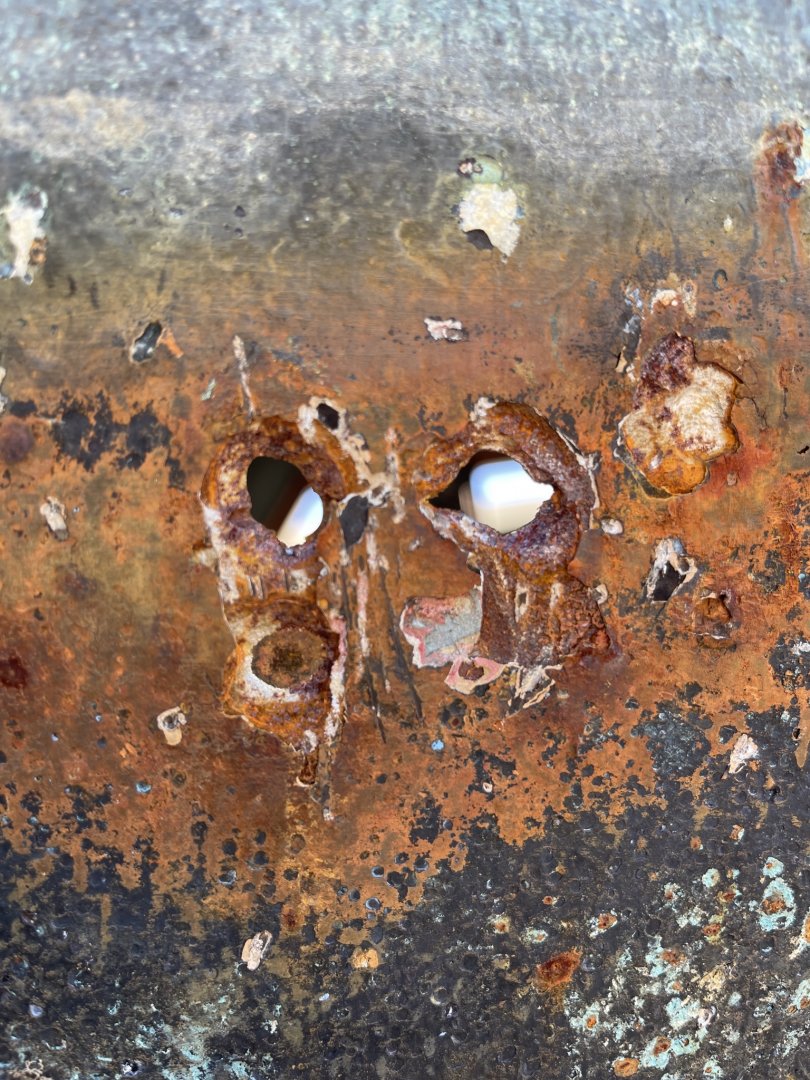

    I am the new owner of a 1956 steel ketch I am starting the restoration on.
    The hull suffered quite a bit of galvanic corrosion in the form of pit corrosion which have turned into localized holes in several dozen places. One of the zincs is basically brand new, even though it was replaced at the same time as the one on the other side of the hull. I believe this zinc is not making electrical contact with the hull, and so the hull was under-zinced for a period of time.
    I am looking for steel scantling reference so I can determine when to replace plating, or when to weld up the holes in "good plate". I have a survey from 20 years ago that claims the hull plating was done in 3/16"(4.7mm). I have a racing survey document from the Koninklike Verbonden Nederlandsche Watersport Vereenigingen from around when the boat was built that claims the plating is 3mm.
    Ribs are 40x40 T shaped 4mm thick at 600mm spacing.
    I am going to ultrasound survey, as well as drillbit survey the hull and want to know what my replacement minimum thicknesses would be. These minimum numbers are obviously different depending on the original hull thicknesses. So I figured I would try and get some understandings from you all on typical scantlings for this size of vessel as I have seen a range.
    I am not sure if the hull is corten. Later model from 1968 was advertised as being built in corten, but I don't know how to test this without sending off a sample to a lab (has anyone done this?).

    Can you supply some more information about your 42' ketch please, and ideally post some photos of her for reference?
    Including some photos showing some typical corrosion pits / holes?
    And some exterior / interior photos - including the bilges.
    What do the bilges look like generally - are they very clean and well painted, or rusty and corroded, or somewhere in between?
    Steel boats usually rust from the inside out, and you do need to pay particular attention to the bilges.
    And what is the condition generally of the 40 x 40 x 4 'T' section bent frames? Are they rusty, or clean and well painted?
    The 'several dozen' localized holes in the shell plating worries me - that is a lot. Can you roughly gauge what the steel thickness is in way of the holes, prior to drilling / ultrasound testing?
    Re the KVNWV survey claiming a hull thickness when built of 3 mm, I would be a bit skeptical about this. Possibly for the deck (but thin plate there is a disadvantage re flexing when people walk on it), and I would have thought that the topsides would be at least 4 mm, and the bottom at least 4.7 or 5 or even 6 mm, and the keel itself a fair bit thicker, never mind the relatively close frame spacing of 600 mm.

    Overall interior condition including the bilges is very clean without visible rust weeping etc. The interior was removed 8 years ago and inside was primed and painted in preparation for an interior build that didn't happen. I'll be inspecting this further this weekend and can take more photos of the pitting / holes as well as measure the thickness of the plates in the areas of the holes.
    Here are a couple of initial photos.
    more hull hole pics in a few days.

    Ultrasound generally says 3mm thickness!
    There are quite a few localized bad areas that I’ll have to chop out, and quite a few holes I will need to fill, but generally the plates are still 3mm.
    I will be removing the concrete / iron ballast as well and putting lead down in the keel for peace of mind. The previous owner was concerned about the ballast situation and I want to remove that worry. Attached are some photos, including the largest hole I have found.
