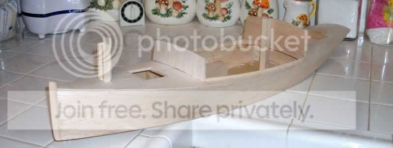

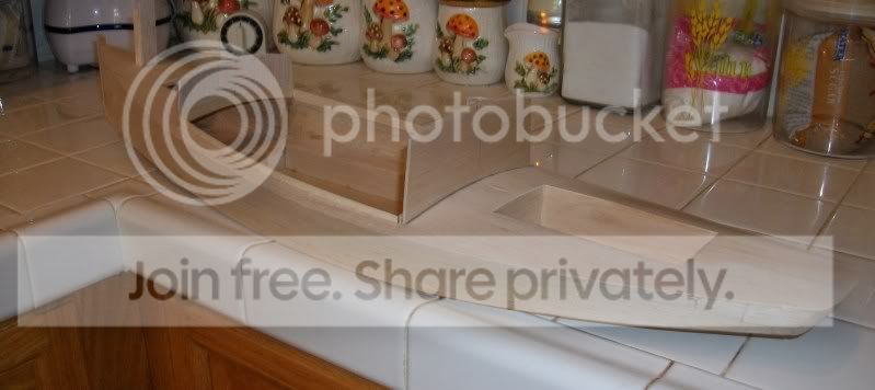

  3. troy2000
    Joined: Nov 2009
    Posts: 1,738
    Likes: 170, Points: 63, Legacy Rep: 2078
    Location: California
    troy2000 Senior Member
    Yikes! I figured 5 foot headroom would look bad; I had no idea just how bad.
    Looking better in the pictures below; needs more crown. And maybe needs to be cut down a tad forward -- so the lines of the cabin don't point off into the wild blue yonder, instead of being level with the waterline or sloped a little towards the bow stem.
    As a matter of fact, the whole cabin trunk may need to be cut down, if the boat isn't going to look like a floating board with a shoebox on top. But I'm dealing with a flat-bottomed, shallow-draft hull that doesn't have a lot of freeboard. So beyond a certain point, I'm just going to have to accept less than ideal aesthetics...unless I build a pop-top cabin. Once the sails are up, it'll probably make the cabin look a little lower anyway...and of course, contrasting trim top and bottom on the trunk sides will add horizontal stripes. Like the mother of a tall, skinny girl, I'm convinced horizontal stripes will help....:p
    Take a closer look at the last two pictures, and you'll notice I installed carlins clear around the cabin well (is that proper terminology? I dunno. How about "the hole in the deck the cabin trunk is going to cover"?). The trunk sides will be outside them. I think that's not only a strong way of doing things, but a more watertight way. On the real boat, I'll probably set corner posts first. With the model, I'll box in the trunk first, and trim the carlins to make room for corner posts inside after the sides are up. Then I'll shave the exterior corners back until I'm into the corner posts a little, and laminate an outer corner piece to cover the raw edges of the sides. I'll wind up with a cheater's version of rabbeted corner posts, notched to set both inside and atop the deck.
    That isn't a very clear explanation, is it? Ah well, I'll take pictures.
  4. hoytedow
    Joined: Sep 2009
    Posts: 5,854
    Location: Control Group
    Why not turn the 5' cabin into a tent? It would only look bad when you are sleeping and who cares then?
  5. troy2000
    Joined: Nov 2009
    Posts: 1,738
    Well, that was the idea I was kicking around with a pop-top cabin. The cabin would be about half as tall when it was down, reducing windage and looking better. I could either have the upper half overlap the lower half when down, or just have the upper half be canvas. With the sliding hatch open, we could reach the beer and the stove anyway....
    Eh. I think I'll just continue with a a solid cabin, for now.
  6. hoytedow
    Joined: Sep 2009
    Posts: 5,854
    "I could either have the upper half overlap the lower half when down"
    The lower half could be the canvas part.
    What do you think?
    That would save weight and give cleaner lines above deck.

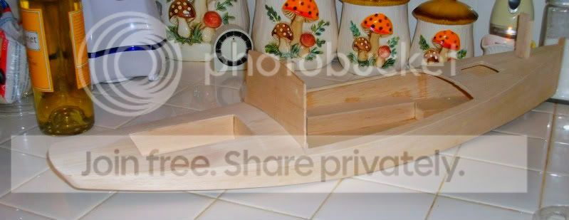

  11. troy2000
    Joined: Nov 2009
    Posts: 1,738
    The second attempt, in the lower pictures, is about four foot two inches at the sides, with a six-inch crown. I think I can increase the crown and cheat the sides down a little more, without seriously affecting headroom.
    The sliding hatch is going to be at the galley to the port side, anyway. And the head will be across from it, on the starboard side; there's where I need to keep sitting room.

  13. Angélique
    Joined: Feb 2009
    Posts: 3,003
    Model is looking good Troy....!!
    About the headroom............
    32'5" Sharpie Ketch Two Lucies
    by Robert Beebe.
    Headroom between beams 4' 5". That looks to be the highest as it can be without looking bad for a 32' 5" V-bottomed low freeboard* sharpie.
    Two Lucies has a interesting 'flush side' cabin. See the book 'Fifty Wooden Boats' or the digital study plan ($ 0.99) to see it.
    Ted Brewer's 32' Mystic Sharpie has 4' 6" headroom between beams.
    Good luck!
    Angel
    PS - *your freeboard looks to be lower.
  14. troy2000
    Joined: Nov 2009
    Posts: 1,738
    Yep, my freeboard is definitely lower. On the real thing, I'll consider raising it just a few inches. For now, I'm going to increase the crown on the model, which will lower the sides a little, and live with it. I think when I've added trim to the top and bottom of the trunk; a gunwale, rub strip and toe rail; coamings; and a two-tone paint job, it'll look a lot better.

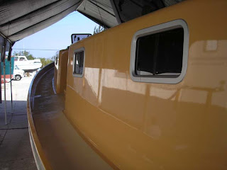

  15. Angélique
    Joined: Feb 2009
    Posts: 3,003
    That's how Reuel Parker deals with it here. (Go back to see it - "Older Posts" - "Older Posts" - "Older Posts" - etc.)
    [​IMG] - [​IMG] < Click.
    First pic came from here.
    Good luck!
