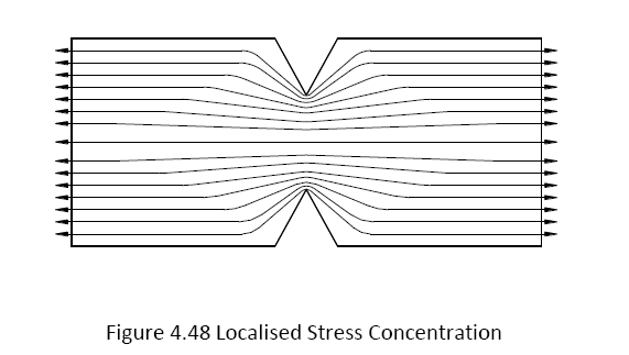

    A notch is, as described, and creates simple localised stresses as shown:
    The reasons why on a virgin sheet of ally, a notch/scratch will cause a failure is because of what the notch does on a microscopic scale. In a nutshell, the flexing of the ally causes the atoms to pass over each other on what are called 'slip planes'. Ally has many slip planes because it is a FCC atomic structured material and is easy to slide/glide on an atomic scale and thus susceptible to fatigue. The constant movement creates intrusions and extrusions that slowly propagate. The very basic mechanisms of fatigue (without going into details).

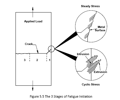

    It starts by:
    and then becomes:

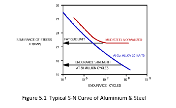

    Ally has no 'fatigue limit, unlike steel:-
    Thus any stresses from a continually applied flex no longer has an effect is not applicable to ally. Thus the more flexing the lower the stress for the alloy to fail.
    Fatigue requires an initiation point, a void, to start. A notch or scratch etc provides this 'initiation'.
    Rewedling or poor welding etc, mearely reduces the localised hardness of the alloy. The lower the hardness the lower the yield stress.

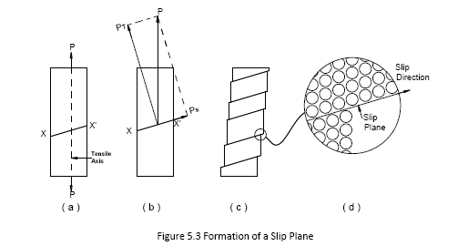

    Workhardening, or also referred to as Strain hardening too, is a mechanical means of increasing the strength of an alloy.
    Ageing, uses the metallurgical effects of heat on the alloy.
    A weld uses heat, the heat is changing the atomic structure and its material properties. The heat also introduces foreign materials, usually unwanted, into the alloy matrix. Constant reheating of ally lowers the localised hardness, which lowers the localised strength. Thus, all these conspire to i) lower the strength, so it fails at a lower than designed value) and ii) reduces the fatigue life as many sources or sites of crack imitation have been produced.
    A stress concentration is merely that, a change in localised stiffness of the weld bead above that of the surrounding area.
    This influences the stress around said SC so that higher stresses are experienced at the SC, the oversized weld bead.
    Not at all, im sorry if you took it that way. Merely applauding your efforts to describe in simple terms, a very complex mechanism.
    A void does not cause a stress concentration! It creates a site of crack initiation…which leads to failure by fatigue. It is a totally different mechanism at play.
    It is not the stress per se, but the strain.
    It is the strain amplitude that is the important feature in movement along slip planes regarding fatigue.
    It leads into complex issues like cyclic strain-strain curves and shows that deformation takes place at roughly constant values of stress and leads into persistent slip bands (PSB) etc etc…but I digress…

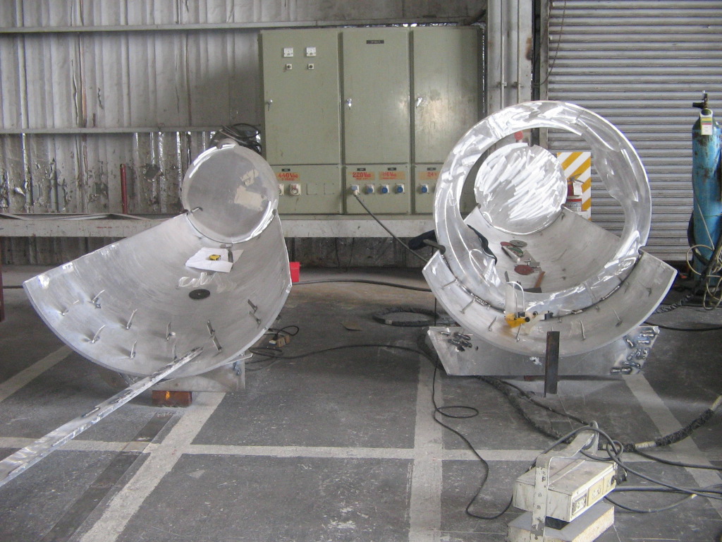

    Great advice, I just ordered a sheet of 20 by 8 aluminum. Good thing is that I will not have to butt weld the bottom of the hull together since it's such a long sheet.
    The plan is the use the template and cut out the aluminum. Once that is done, the plan is to cut out a peice of 2 by 10 of timber with the correct curvature of the hull bending the aluminum hull over the timber. While the timber keeping the curvature correct, I will then place aluminum sheet on frame with timbers attached. Finally welding in to place.
    What do you guys think?
