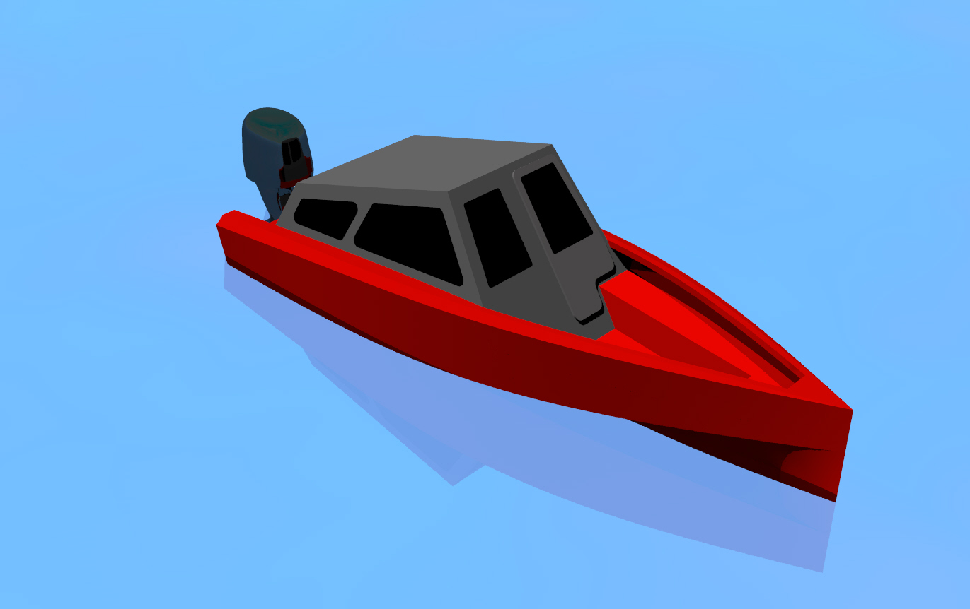

      Sean... when are you gonna make this thing.. I wanna see it in action.:) ohh and what kind of outboard?

      Model is a Honda posted by a member - but in my mind it is a BIG BLACK MERCURY...
      Everything remains - 'in my mind'...
      Still needs a 'moon roof' and study on that stupid door...
      Also radius on front windows vs. sides...
      Thanks...
      I believe this thing will go very well in a straight line - but will carve a wide turn...
      Very Dodge Charger or Super Bee...
      SH.
    • blared
      How about Otto's or Buzzi's ASD design on the sides, Otto always says it makes a difference ? Are you planning to make a deep v hull or straight bottom like the vintage racers ? AUTO TAB CONTROL (ATC) SYSTEM might solve your problem also when you are taking those tight turns.. But it's up to you ... I'm cool with that drag racer sytle too :D

      Hello...
      Blared - well I can get 3/16 Aluminum 4 x 20 sheets for $7.50 a square foot - delivered - guess I need to do some nesting for this...
      I love aluminum...
      CUT FIT MIG TIG DONE...
      Not to mention all the extrusion shapes that can be shopped up...
      SH.
