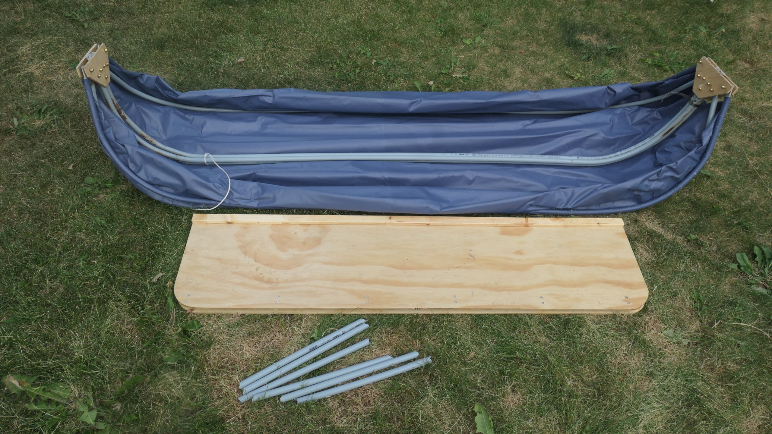

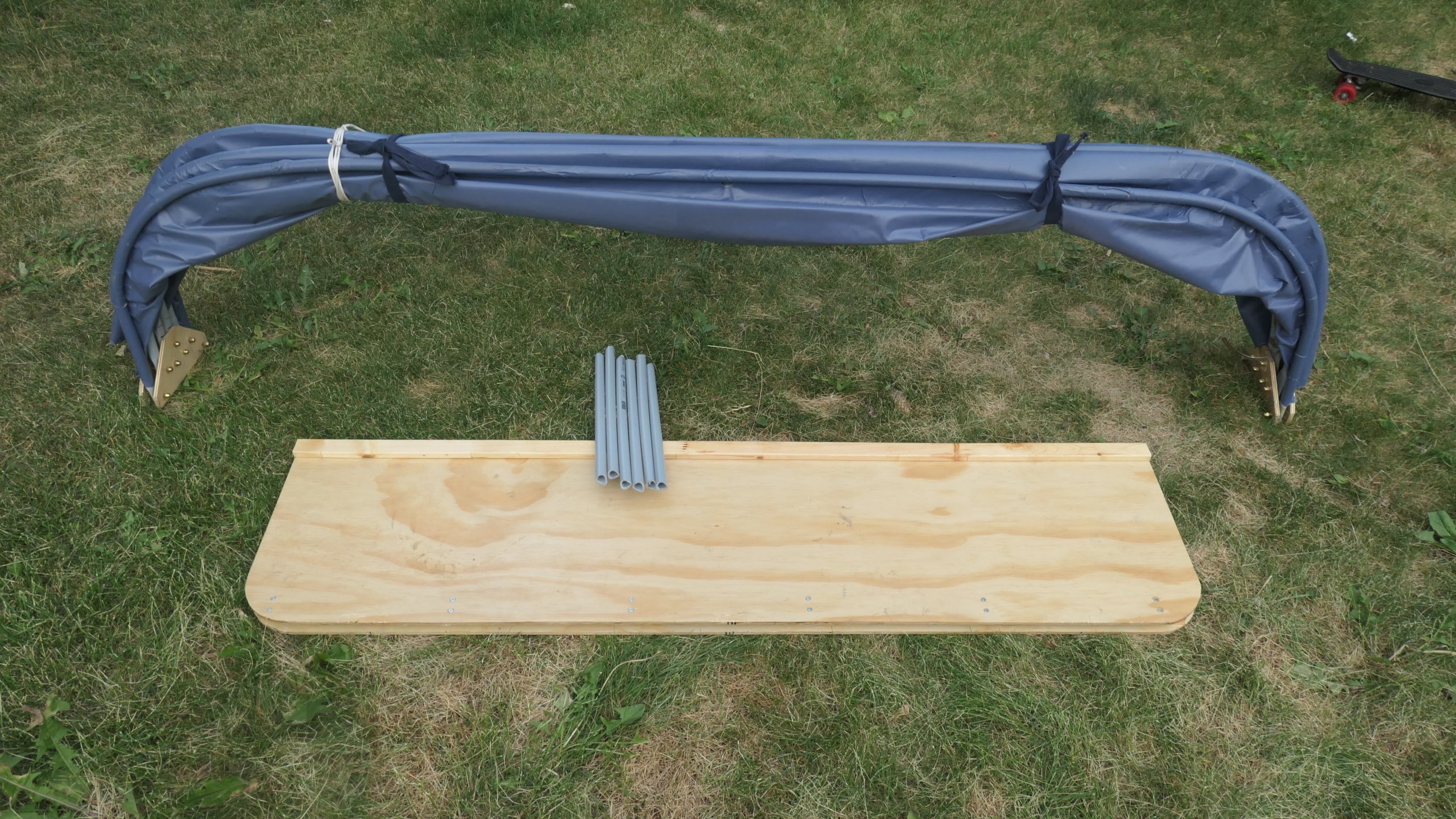

A small folding boat, created in a fit of cabin fever early in the pandemic

PVC conduit frame

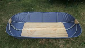

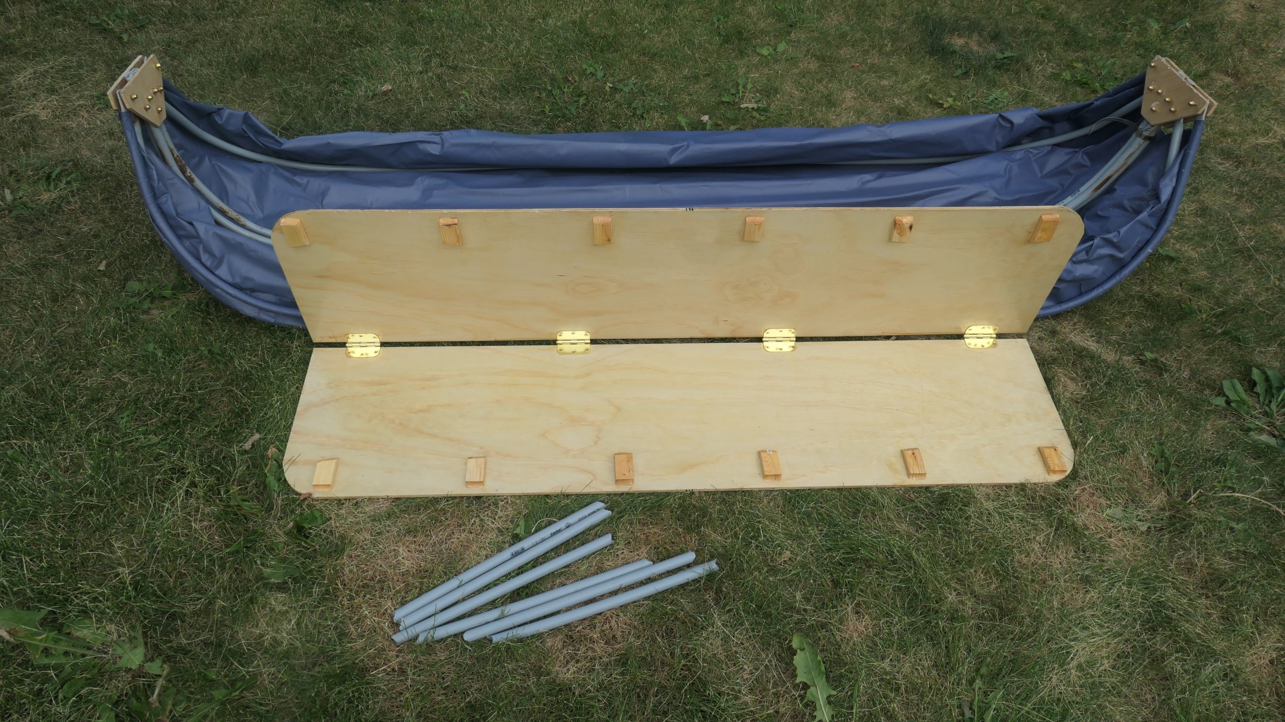

Plywood floor

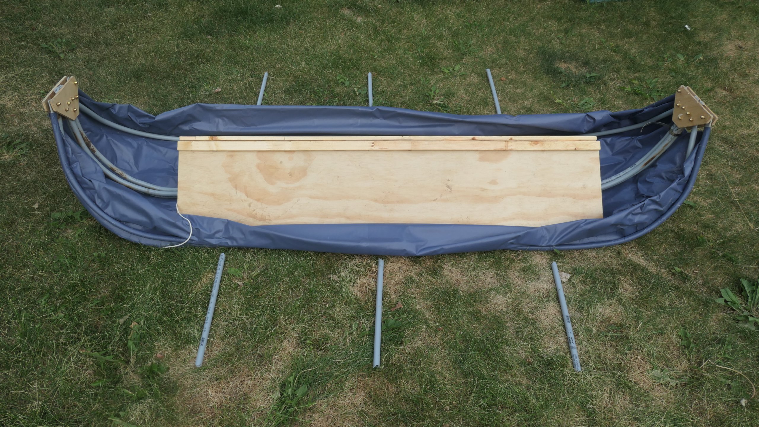

Ribs are also PVC conduit

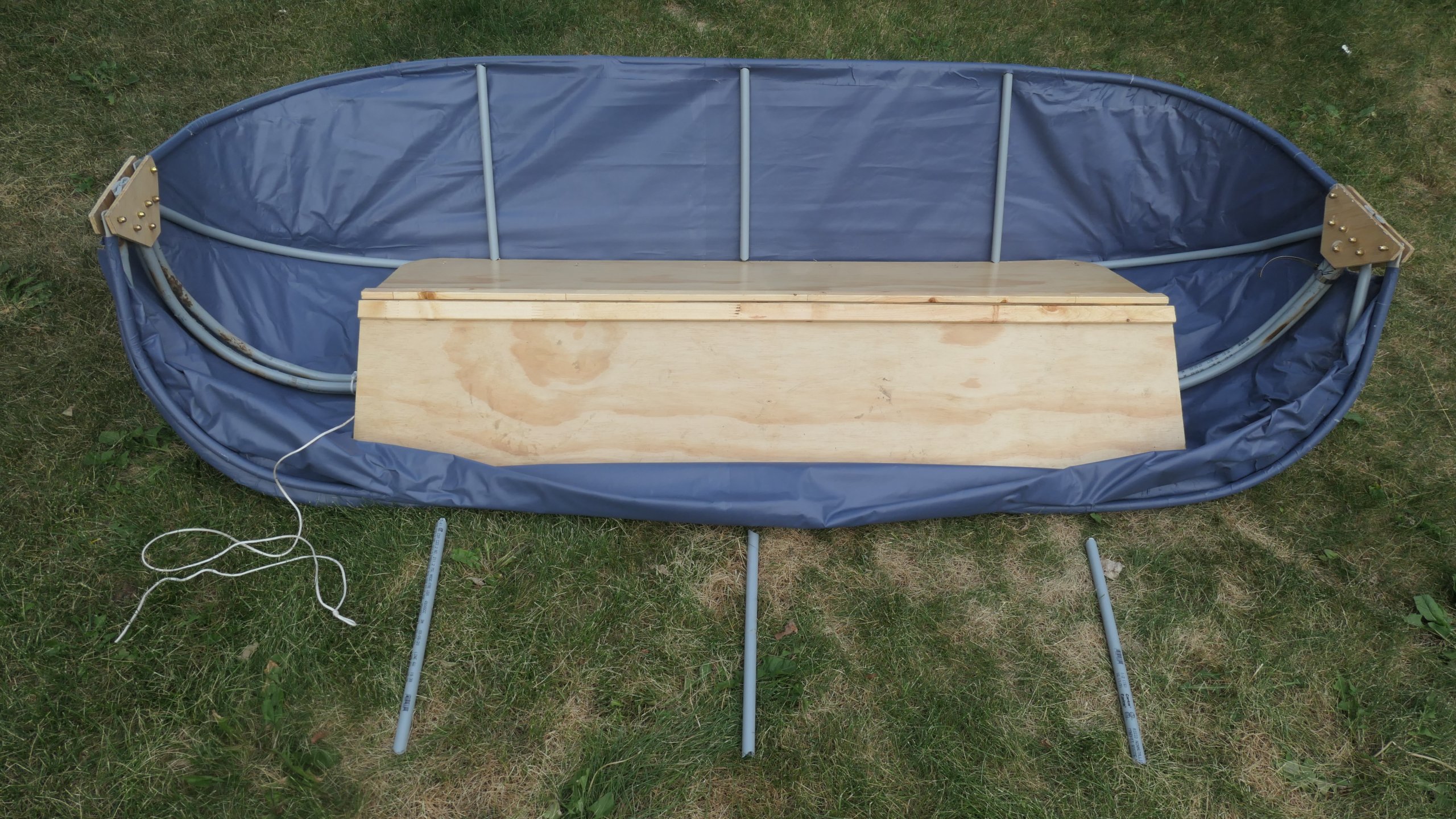

Floor spans chines...
355
18 Nov 2022
Coracular
Cicada
0 x
...and rests on keel

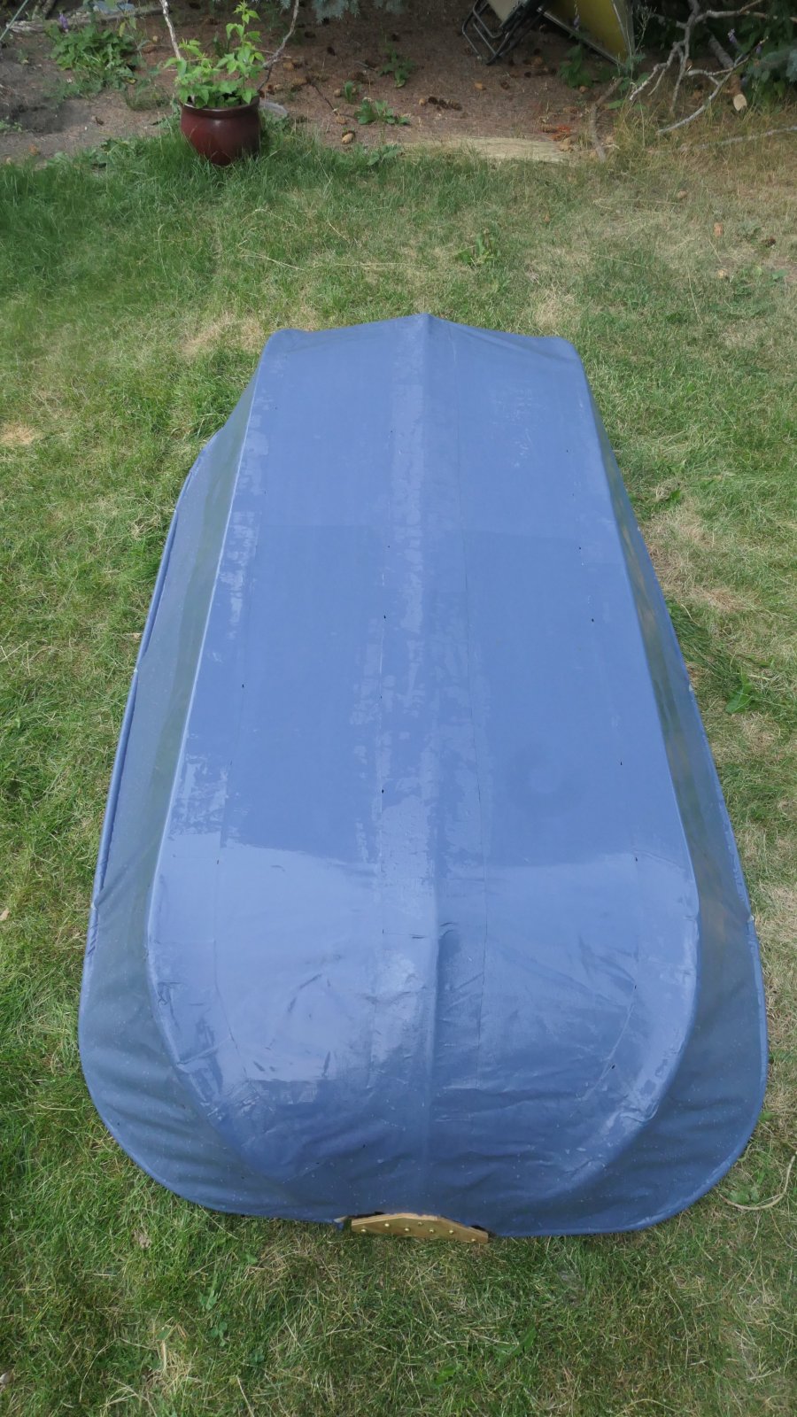

Skin is under tension, floor and frame handle compression

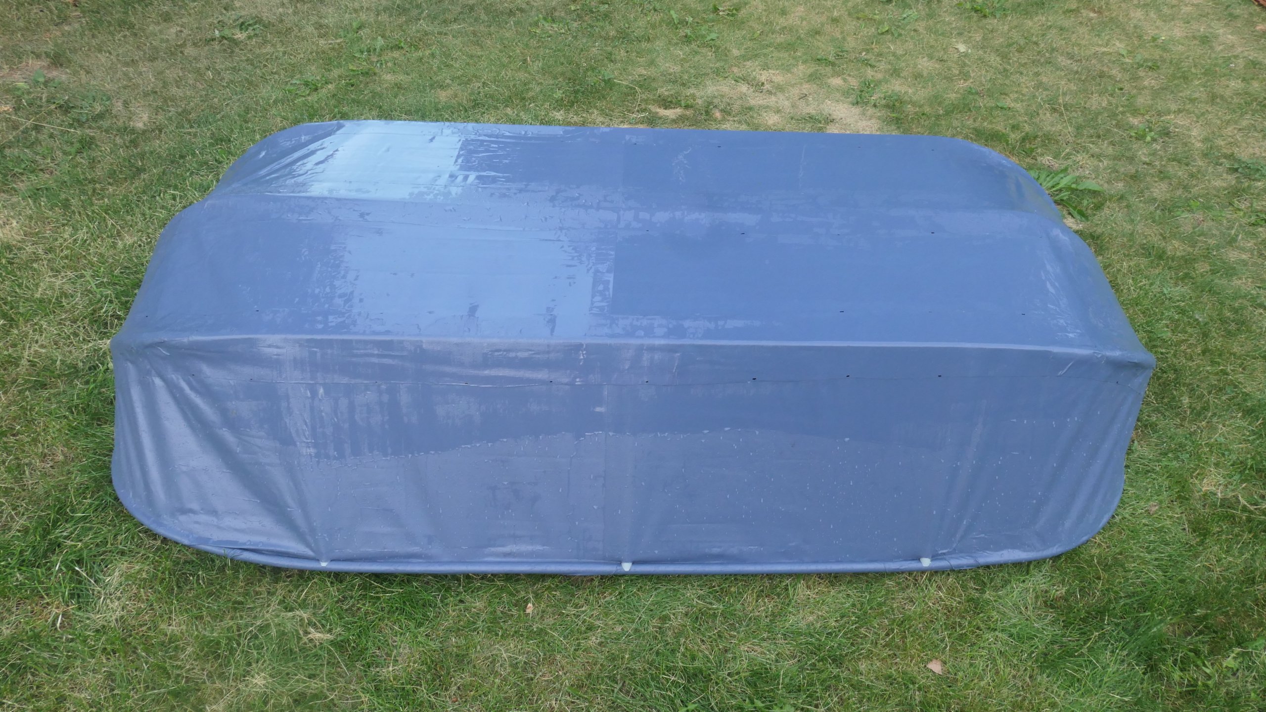

Fit the skin to the frame

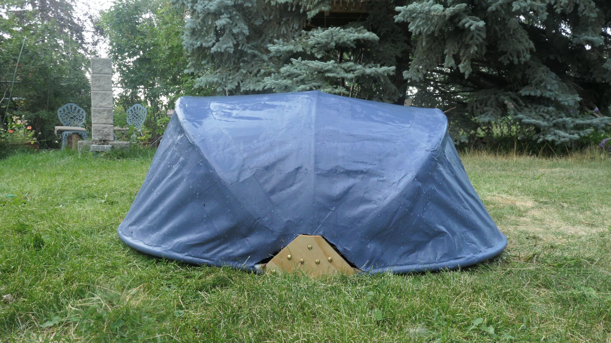

Ends fit to frame

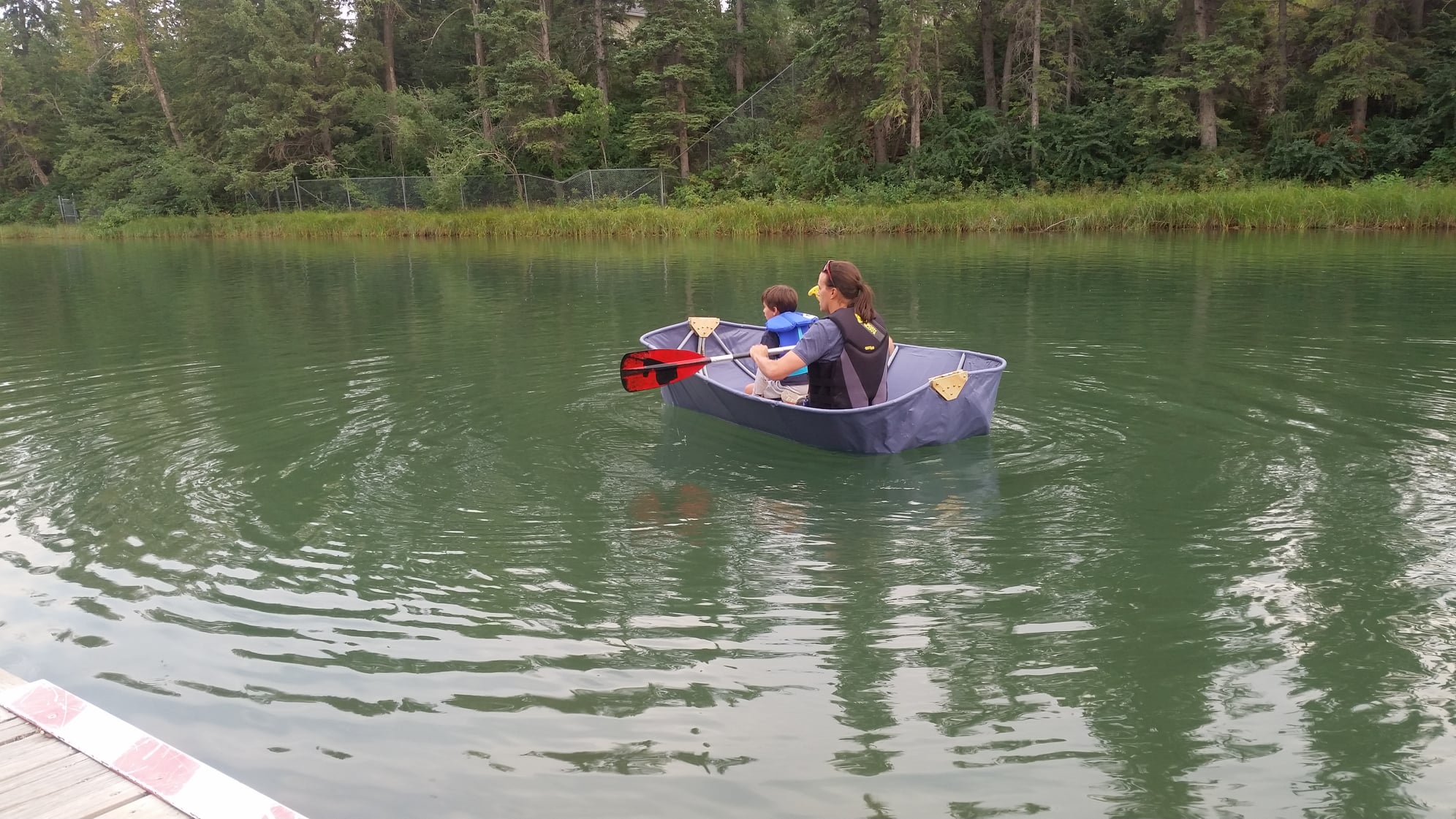

First on-water test

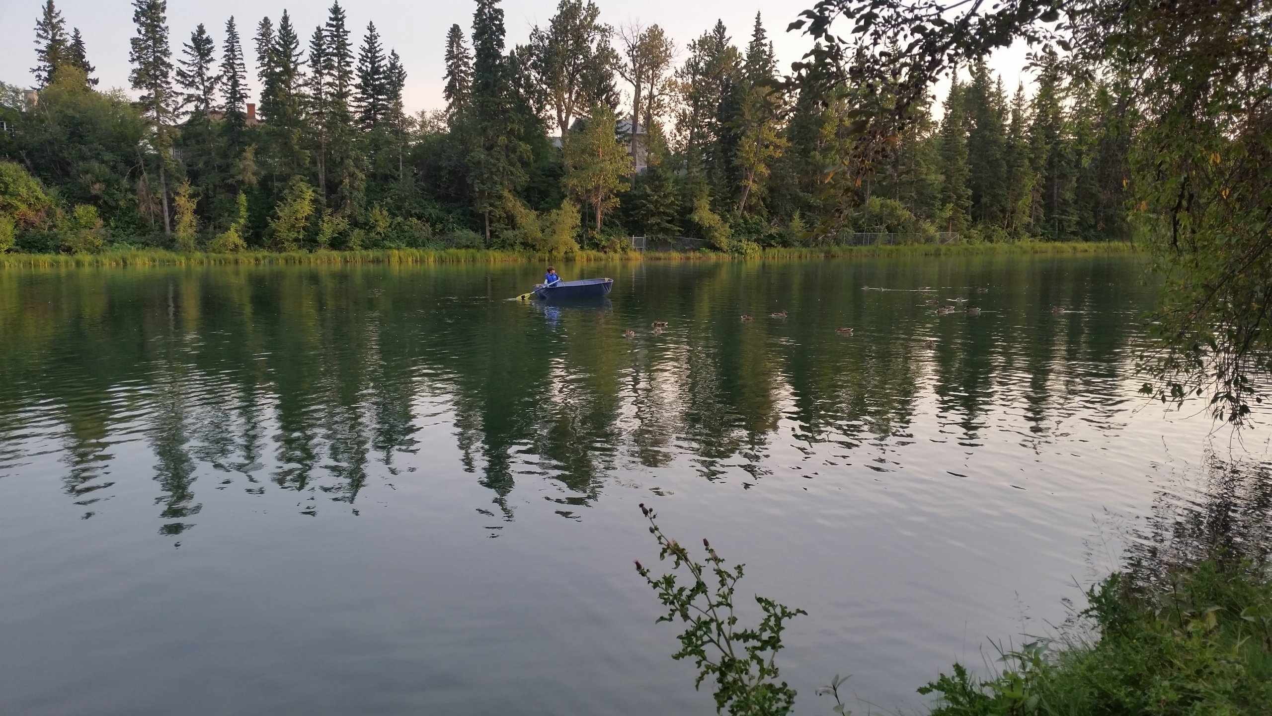

Paddling
