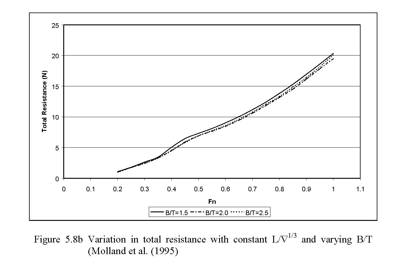

    In a previous discussion under the thread title "two hulls which has least drag". I sketched two hulls, both with the same displacement, wetted surface, waterline length and both with semi-elliptical cross sections and circular arc waterlines as viewed from above. Some time after this discussion petered out I got around to running the Michelet drag prediction program for the two hulls, but with a rather less extreme difference in B/T than I originally considered. The results are below.
    Comparing these Michelet results with those from Moland as referenced by Ad Hoc I note that the effect of B/T on total drag as predicted by Michelet is considerably more than for Moland's results. Also, whereas Moland indicates a wider shallower hull to have slightly less drag than a deeper narrower hull Michelet predicts the reverse.
    At, say, 5m/s, a fairly typical speed for a 10m LWL multihull in good conditions, Michelet predicts 7.7% greater total drag for the wide shallow hull than for the deep narrow one. I would say that such a drag difference is not insignificant in the context of competitive yacht racing!
    I do not know how Michelet works so I have no idea how suitable it is for this kind of drag comparison, I am just stating the results so that Leo or others can decide whether they are relevant.
    One point that I would make is that increasing B/T with constant displacement and constant LWL increases the hydrostatic pitch stability of the hull, for small pitch angles, in direct proportion to B. Both the Moland results and the Michelet predictions are for calm water but if one hull were to pitch more than the other in rough water this would also affect the comparison. I suspect that it would be a complex exercise to predict how pitch stability impacts on sea keeping and in turn on the extent to which sea keeping affects performance, both by direct effect on hull drag and by effect on the rig. However, catamarans with low pitch stability, e.g. narrow beam canoe stern hulls, do have a bad reputation for pitching.

    If i look at the Series 64, using your values of length, displacement, speed and the variation in B/T, there are differences.
    If I take a few spot checks, the Series 64 shows a range of 2-4% difference in B/T from 2 to 4. Whereas over a consistent range the results you obtained from Michelt is 7-9%. I assume you kept the transom immersion the same with your 2 hulls?
    I would suggest that at higher Fn's there is less correlation. than at lower Fn.s Im sure Leo would like to comment?
    It still figures in well with the results by Warren et al. Where they conducted a very similar exercise. Keeping all parameters the same, but varying the hull shape. Not as easy as it seems.

    I chose very simple hull shapes with canoe sterns for this exercise. That way I did not need to consider whether or not Michelet would be including the immersed transom area in the hull wetted surface or whether Michelet was making good assumptions about flow separation at an immersed transom.
    The two hull shapes I used are shown in the pictures below. The yellow parts are above the waterline and so are irrelevant to the hydrodynamics. You can see that if you split the grey underwater part of the narrow hull along the centreline then rejoin the two halves you get the underwater part of the wider hull. Hence it is certain that these two hulls have the same wetted surface so, not surprisingly, Michelet did predict the same frictional resistance for the two hulls.
    Sea keeping is digressing somewhat from the original thread topic, but I do wonder how to interpret your graph for Accelerations vs Length. The graph shows data for two hulls which have slightly different values for Lpp/Disp. Are these two hulls the same displacement but different LPP, or are they two hulls having the same LPP but different displacements, or are they two hulls differing both in displacement and LPP? I think this does make a difference to how the graph should be interpreted.
    Suppose for now that both hulls have the same displacement but differ in length. The graph shows that the longer hull has lower vertical accelerations across a wide range of wave height. I dont find it at all surprising that a longer hull has lower vertical accelerations, after all if we consider a hull long enough to span many wave lengths pitching will become insignificant. The magnitude of the difference in vertical accelerations for only a fairly small difference in Lpp/disp is perhaps more surprising, but this data does not include any information about the wave encounter frequency or the natural pitching frequency or pitch damping of the two hulls.

    But it still does not address the inconsistencies with published data at the higher Fns.
    The nomenclature used by the author is that of the normal L/D ratio. I'm sorry I assumed you would understand this, since data pertaining to hulls is, in general, referred to by the length-displacement (L/D) ratio....unless otherwise noted.
