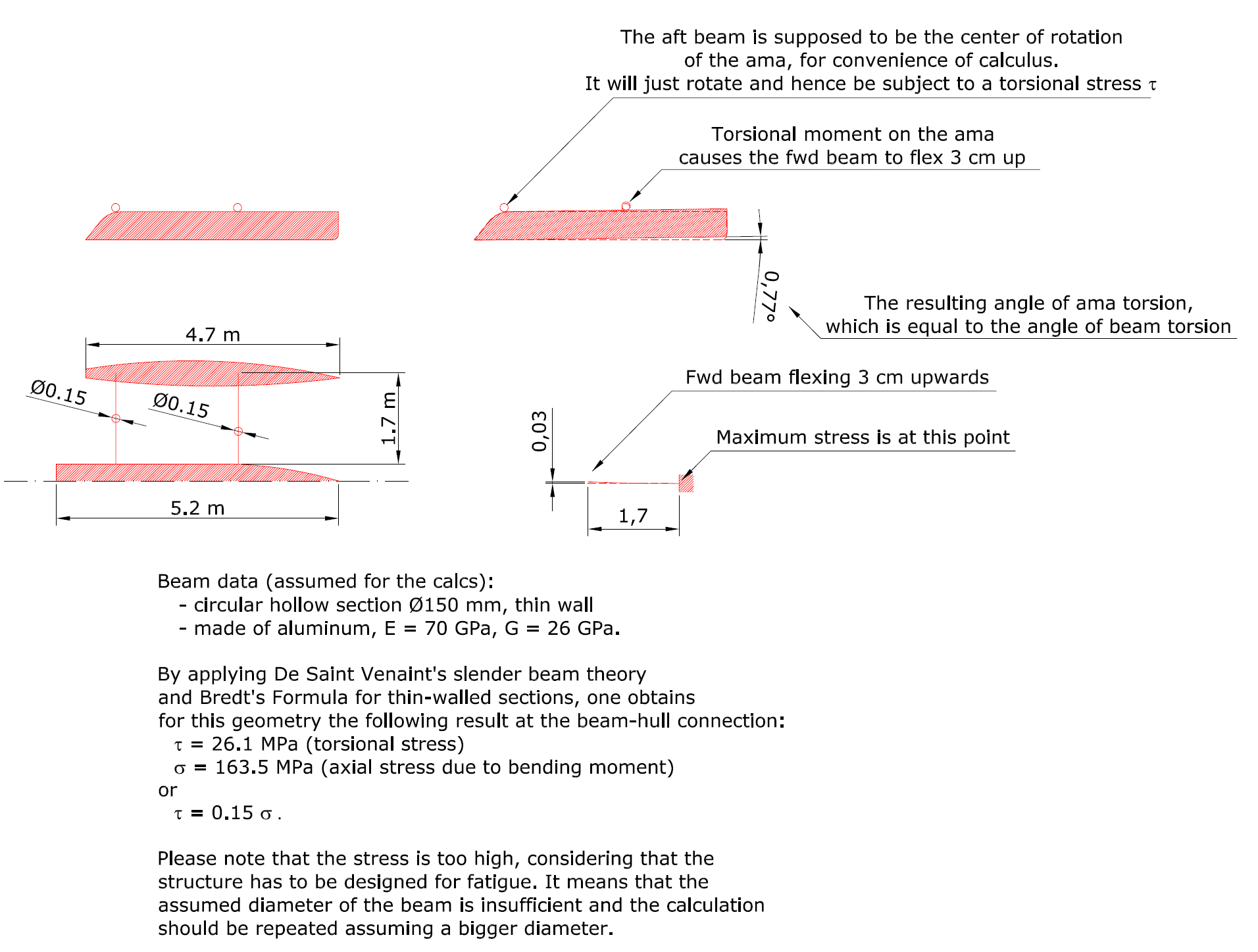

    A picture says more than thousands of words, so consider this trimaran by Michael Waters:
    http://www.smalltridesign.com/W17/study-profile.html
    I have choosen this one because it states all the most important dimensions and it's proportions can be considered typical. Differently from the Waters' design, i have assumed crossbeams made of aluminum circular bars, to simplify the calculations.
    Imagine a moment in which the ama is twisted upwards (passing through a wave crest, for example), while the rest of the boat is leveled (that's a conservative situation).
    The explanation of my previous post then is given in the following attachment, made upon dimensions of the above tri:
    The resulting torsion stress is 15% of the bending-moment stress. So, while one could take the torsional stress into consideration for a detailed design of the crossbeams, in reality the exact value of the real forces acting on a seaway-going trimaran are unknown to us, so the actual significance of results which include that additional 10-15% stress is questionable. It makes much more sense, imho, to consider just the bending moment stress in this case, since it is by far the biggest factor, and then apply a guesstimated safety factor (which you'd have to apply in any case).

  15. DCockey
    Joined: Oct 2009
    Posts: 5,229
    Likes: 634, Points: 113, Legacy Rep: 1485
    Location: Midcoast Maine
    DCockey Senior Member
    Thanks for the example.
    Based on the photos it appears that the Buccaneer 24 has a lashed connection between the amas and the beams which may allow some relative twisting motion between the beams and amas, particularly for large pitch angles of the amas relative to the center hull. If so the torsional stress in the beams will be significantly reduced compared to a fixed connection with twist in the beams equalling the "pitch" angle of the ama relative to the center hull.
