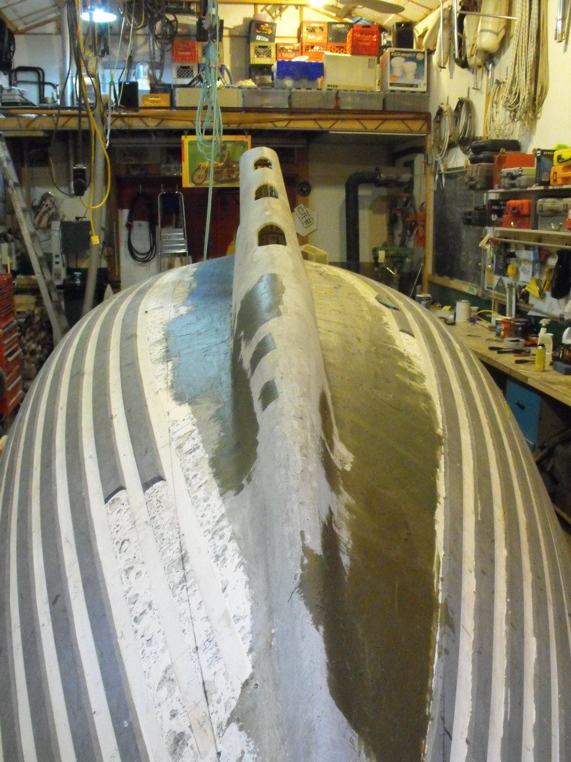

    Over the past couple of days I managed to steal enough time to get back on the build and fill in the worst of those damaged areas as a result of the overly aggressive removal of the factory installed rubbing strakes. You can see one side required more filling than the other as a result of using the air chisel verses hammer and wood chisel. After a somewhat tricky learning curve i have developed a technique of removing the strakes that results in very little shock damage to the hulls outer FRP laminates. My next work will involve a rough sanding to level and shape the filler in prep for the keel to hull glassing.

    As Peg says, "It's looking good." :)
