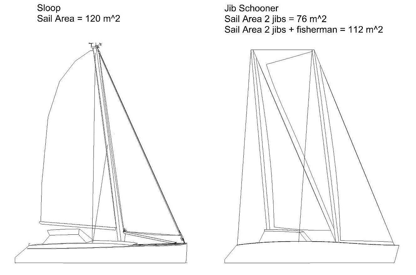

    50’ Jib-Schooner Sail Plan, Aero Analysis
    Dear forum members,
    I’ve recently been sent a proposal for a jib-schooner sail plan for potential use on a new 50’ catamaran, …and asked to comment on its feasibility and attributes.
    Along with this request there was included a CFD analysis that had been performed by Doyle Sailmakers. (attached)
    Not being that knowledgeable myself about these CFD techniques and interpretations, I thought I might post this info on these forums for some comments by those knowledgeable members of this forum.
    BTW I have asked permission of both the vessel’s designer and Doyle sailmakers to post this material on the forum, and been given the OK
  7. brian eiland
    Joined: Jun 2002
    Posts: 5,067
    Likes: 216, Points: 73, Legacy Rep: 1903
    brian eiland Senior Member
    Just to start the conversation I might add a couple of my initial impressions.
    1) This jib-schooner’s rig with its two parallel ‘headsails’ is somewhat analogous to the two parallel headsails* of my aft-mast rig,…and/or the twin headsail rig of this CFD/Windtunnel study carried out in Italy. The Italian test rig with two overlapping headsails proved to be pretty productive upwind, even besting the standard sloop rig.
    Wind tunnel and CFD investigation of unconventional aftmast rigs
    Doyle’s test on this jib schooner rig is hinting at the same.
    ….and this is accomplished with 37% less sail area than the sloop utilized in the comparison study,…interesting
    But I also noted that this comparison was made at 20 knots AWS. I’m pretty sure at much lower AWS this jib-schooner would NOT fair so well,…just not quite enough sail area for those lighter winds. This presents their need for that fisherman sail.
    2) Aero drag of 2 bare mast. I am particularly sensitive about this issue, seeing as to the number of persons who have questioned me about this issue with my single bare mast on the aftmast rig. This jib-schooner has TWO such bare masts in its ‘non-fisherman’ configuration. This would seem to product a lot of drag force, particularly in relation to its relatively small sail area of just two abbreviated jibs.
    And I would ask the experts if this CFD analysis by Doyle properly accounted for this extra drag of the 2 bare masts. :?:

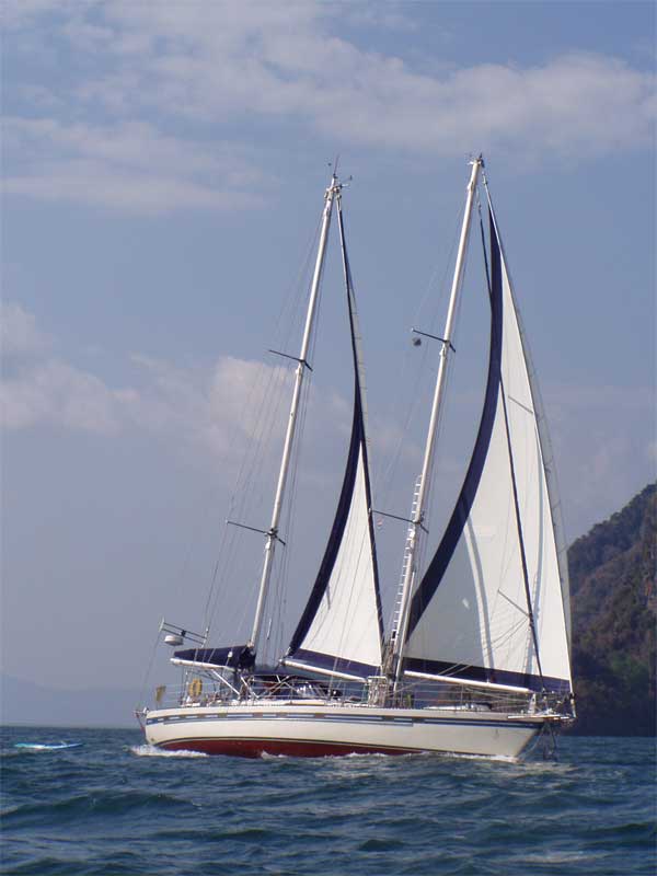

    No takers on discussing the jib-schooner sail plan arrangement/aero characteristics??
    On another forum there have been several submissions of similar style rigs on large monohulls. Here is one:

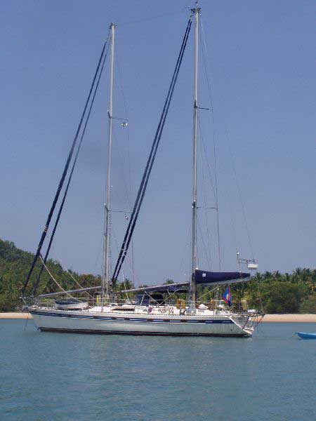

    And here is one I posted a few years ago on this forum.
    Tayanna 55

    Looks like both vessels were interested in NOT using a big traditional mainsail, and substituting a roller furling second jib in its place.
    I talked about this on my website, and on this forum,...having run across a similar thing years ago with an old Outisland 41 ketch conversion.
