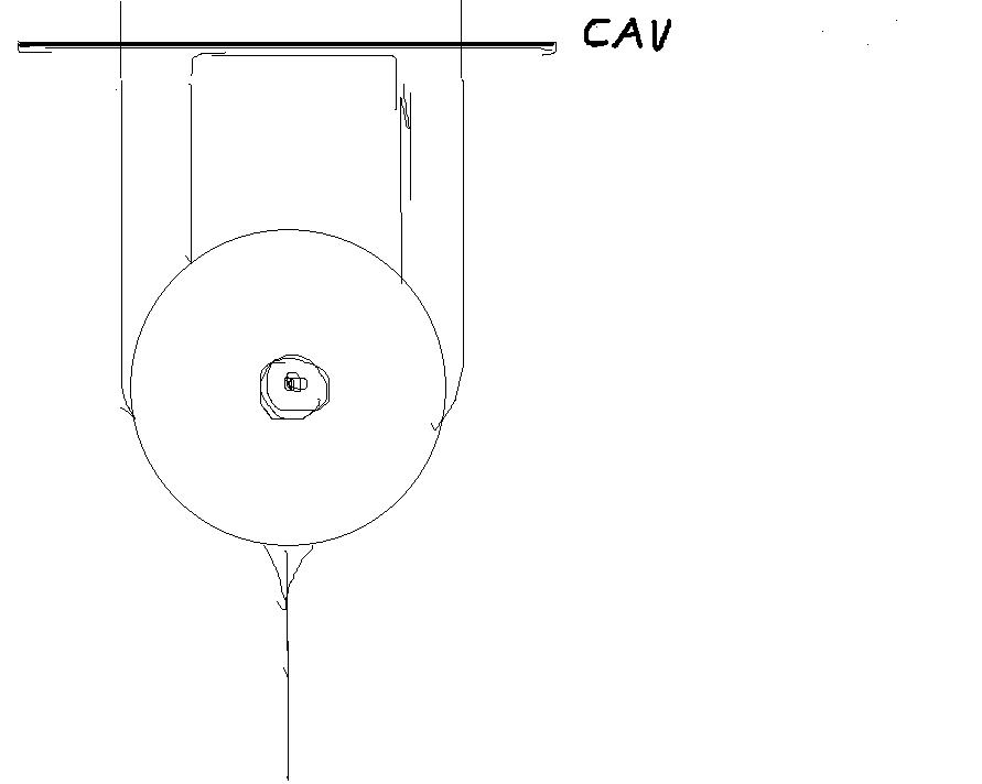

    With the belt drive, instead of forcing it into a narrow central skeg, might it be better to have two separated skegs meeting the gearcase bore at more or less a tangent to the outside circumference, one carrying the belt on its downward travel, the opposite side the upward travel ?
  4. Mr Efficiency
    Joined: Oct 2010
    Posts: 10,386
    Mr Efficiency Senior Member
    Something like this:

    I am shocked from Mr Efficiency or all people - a high drag bottom end with reduced belt contact angle and really hard to install the belt. Just joking. They where not satisfied with that and look what they have done.
    I'll stick with OXE on this one.
    OXE is very very cunning.
    It achieves something the Merc and Volvo has not done. The elimination of the highly loaded pinion tooth in the bottom end.
    Konrad expect 2,000hrs out their units (actual service may be considerably higher depending on use profile). But this is 4 to 5 x Merc. expectations in same service.
    So now OXE is looking at 5,000 or 10,000hrs from a diesel drive. When you look at lifetime costs it starts to make serious sense to burn less fuel, run longer and harder for less money.
    What do you think?

    Good idea. If the 2 legs were streamlined foils you might have a combination of drive leg and twin rudders. Low speed steering may improve . It would have to be a split case to enable belt fitting but I think mr e is really onto something here. There should not be any more drag than an inboards skeg.
  7. Mr Efficiency
    Joined: Oct 2010
    Posts: 10,386
    Yeah, fitting the belt seemingly would require a split case. I know next to nothing about belt drives, maybe this would allow more contact surface, assuming that is beneficial..
