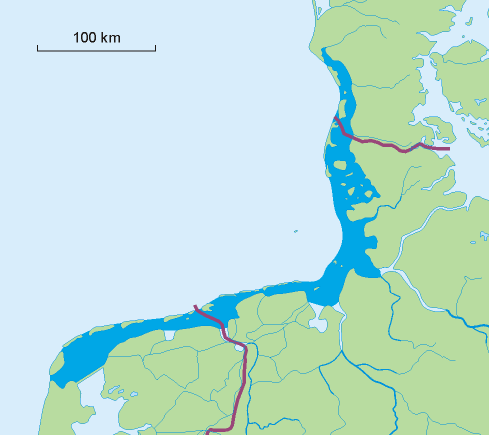

    Any idea about her seaworthiness on a larger sea or ocean without the constant possibility to seek shelter if there's a poor weather forecast ?

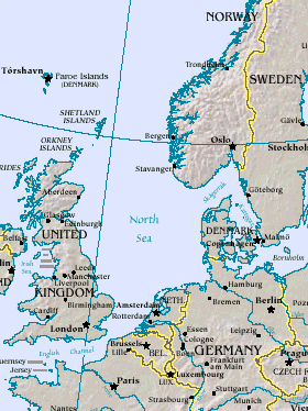

    P.S. - some info about the Wadden Sea, which is the area of intended use
    The first map dark blue part is the Wadden Sea, length ± 500 km, average width ± 20 km, forming a shallow body of water with tidal flats and wetlands between the islands and the main land. The first map scale indication is in the North Sea.

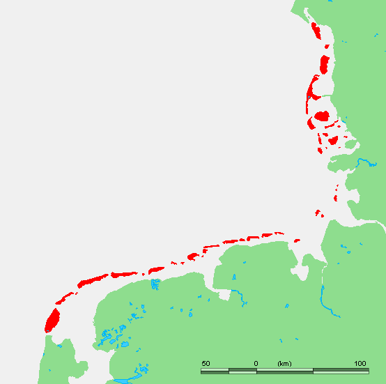

    [​IMG] - - [​IMG]
    First map from left to right to above: The Netherlands, Germany, Denmark.
    Below in red the Frisian Islands, aka Wadden Islands, aka Wadden Sea Islands.
    The islands shield the mudflat region of the Wadden Sea, of which large parts run dry at low tide, from the North Sea.
