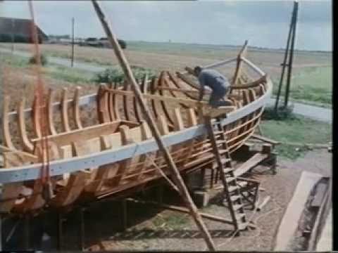

    P.S. - For comparison: the 1912 built MK 63, a traditional fisherman Botter of the Zuiderzee.
    - - - - - YouTube Screenshot - - - - -
    [​IMG] From tree to Botter, displays the traditional build of an solid oak Botter.​
