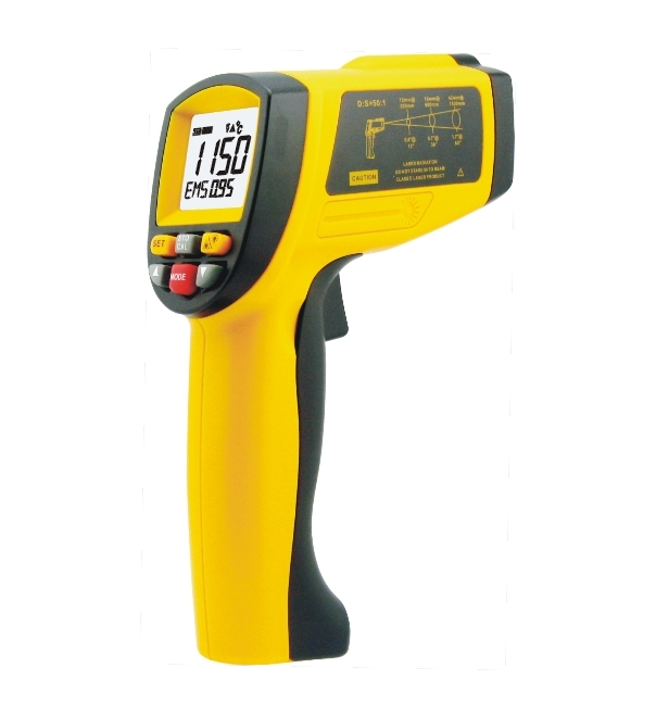

    For approx. 10 EUR you have an infrared thermometer that enables you to read local temperatures and find "hot spots" without touching anything.
