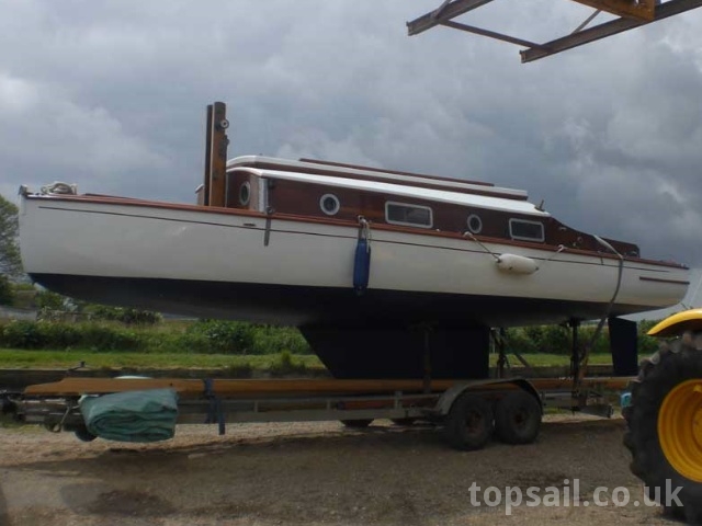

    I've no idea what a 14ft tug would be for but these type of boats, a Norfolk Broads River Cruiser Class http://rivercruiser.org/
    often have an engine in the bow forward of the tabernacle / lifting mast foot, with a long shaft up to 25ft to a prop just in front of the rudder.
    This is to allow for more cabin space, it's quite successful. long shafts from the bow are not a new idea.
    (yes I know this one hasn't got an inboard fitted but it's the best picture I could find)
