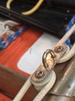

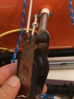

    I should have take pictures before I took this stuff apart.. but I didn't and I'm trying to re-rig the main sheet.
    The way I did it just doesn't look right to me..but I can't find a clear picture of how anyone else has it.
    so this is the picture tour,
    I have a figure 8 knot in my line, and it comes in through an eyelet on the traveler here:
    (I don't recall the line being run to this before but I don't see anywhere else for it to end)
    It runs from there up to the forward of the two blocks on the boom:
    it then runs down to this double block ( I ran it through the top):
    Then back up to the boom to the aft block:
    Then back down to the lower block on
    Then to another block on the barney post and to the cam cleat,
    This doesn't seem right to me even though it might work. Do you know the proper flow for this line? Do you have the same setup?

    Grabbed a quick picture. The boom is always rigged up like this and ready to go. This is the way I've been running the main sheet. To the right is forward, and that middle block connects to the traveler car. The line on the left runs through the block on the barney post.

    Just re-ran it. It now looks like:[​IMG]

  7. Canracer
    Joined: Aug 2009
    Posts: 620
    Location: Florida
    Canracer Senior Member
    That's the way. You might shorten the tail that's hanging from the becket knot. It could jam in a block and cause an issue on the water. Another thing to consider; the ratchet block is easy to get turned around the wrong way (always worth double checking before heading out.) Because the boat is tippy by design, it's not easy to correct little mistakes after the boat is launched. And I've made a ton.

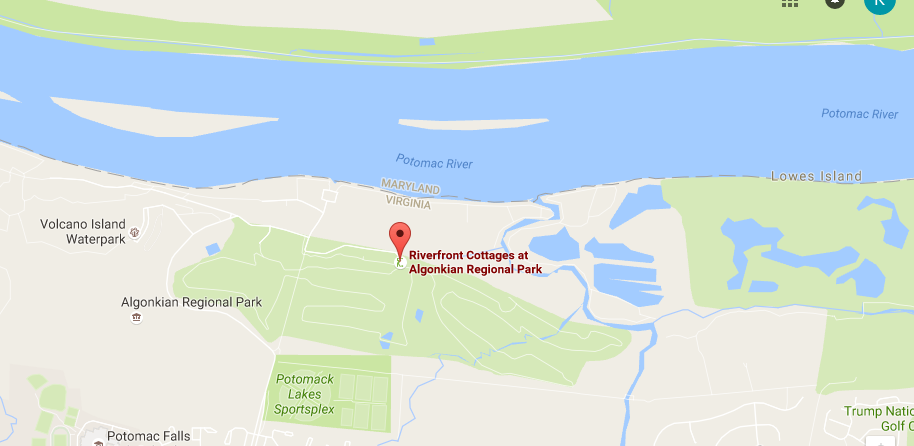

    The wind was perfect for what we had in mind. It was blowing 4-6 knots from the east. This is good because we were sailing on the Potomac but not south of DC where it's deep and wide. Up here it's pretty narrow and shallow, but it's not far from home and ramp fees are friendly for frequent visits.
    I've had the boat there a couple of times, but last Wednesday ,when that picture was taken was the best so far. The boat ramp goes into the water right between those two islands, just to the left of the red pin. I've tried to sail around the westerly island a couple of times but with the wind coming off shore there was always too much wind shadow from trees I guess. Well not that evening! We made it around the island and had fun tacking back and fourth in that area between the islands. I had the three youngest monkeys with me, number 3 and number 5 had been apprehensive but ended up having a lot of fun. If there had been more wind I think they would have been scared. That's Number 4 waving and smiling. Clearly he's not stressed.
