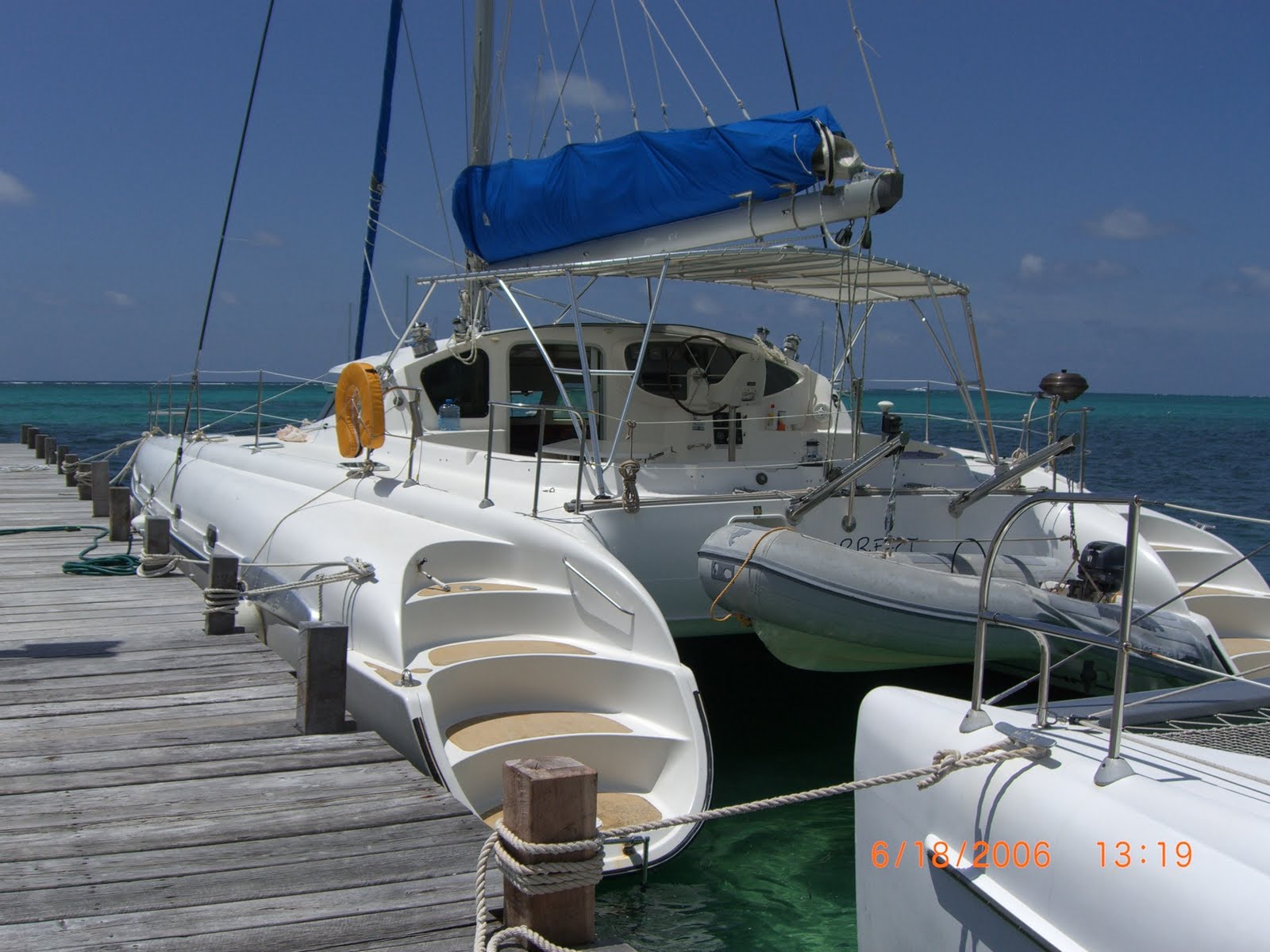

    By the way, found this pic in the internet: http://4.bp.blogspot.com/_ZsjySuynQ...6qtFIsVk/s1600/23 6.18.06 Goodby Puurfect.JPG
    and I think that guy has found a very nice and elegant solution for the tender. No need for support posts and columns. It also avoids complications with the main sheet traveler, which regards your question in the post #34.
    Perhaps you too could take it into consideration?
    Cheers
  7. oceannavigator2
    oceannavigator2 Previous Member
    Yes, that is the normal, traditional way to do it. The roof and support posts are already in place (scrap timber posts until I get the real ones. boat is not in the water).
    Since it already has posts and a roof, I would like to use this existing structure to raise the tender.
    The advantages over the traditional way in your picture are:
    1) The tender can be raised a full 2 meters higher which eliminates any chance of it being caught by a wave.
    2) The "view" from this sheltered area under the roof is not cluttered.
    3) Better diving from the roof! :p
