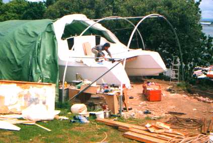

  14. Richard Woods
    Joined: Jun 2006
    Posts: 2,209
    Likes: 175, Points: 63, Legacy Rep: 1244
    Richard Woods Woods Designs
    Barry
    No thats not how I would do it. When I said "planks" I meant something like 20ft x 8in x 2in
    Its a bit of a fiddle jacking it all in place but once done you have: on the ground two long planks, on those the rollers laid across them. Then two more planks on top. Then the boat, well supported by chocks and sitting on the top planks exactly as though it was on a concrete floor, so no excessive point loads
    in effect I have made a roller bearing slide. I can then push the boat along with my hand. I have found that it is tricky to stop it moving because of the momentum
    of course I'd really need two sets of planks each longer than the boat so I can keep it moving without rejacking
    thats how we launched the boat shown in the first photo above. In this photo you can see the boat in our garden a few hours earlier. In the back ground you can just see the water behind the trees, about 10ft below a small cliff. We had to pull the boat out backwards, turn in 90deg and then slide it over the bank. All done by four people (2 men 2 women) no cranes, forklifts, heavy lifting needed. No damage - and the only stress was in our heads
    that has to be how they built Stonehenge and the pyramids. The films showing hundreds of slaves pulling on rollers just sitting in sand is not how to do it!
