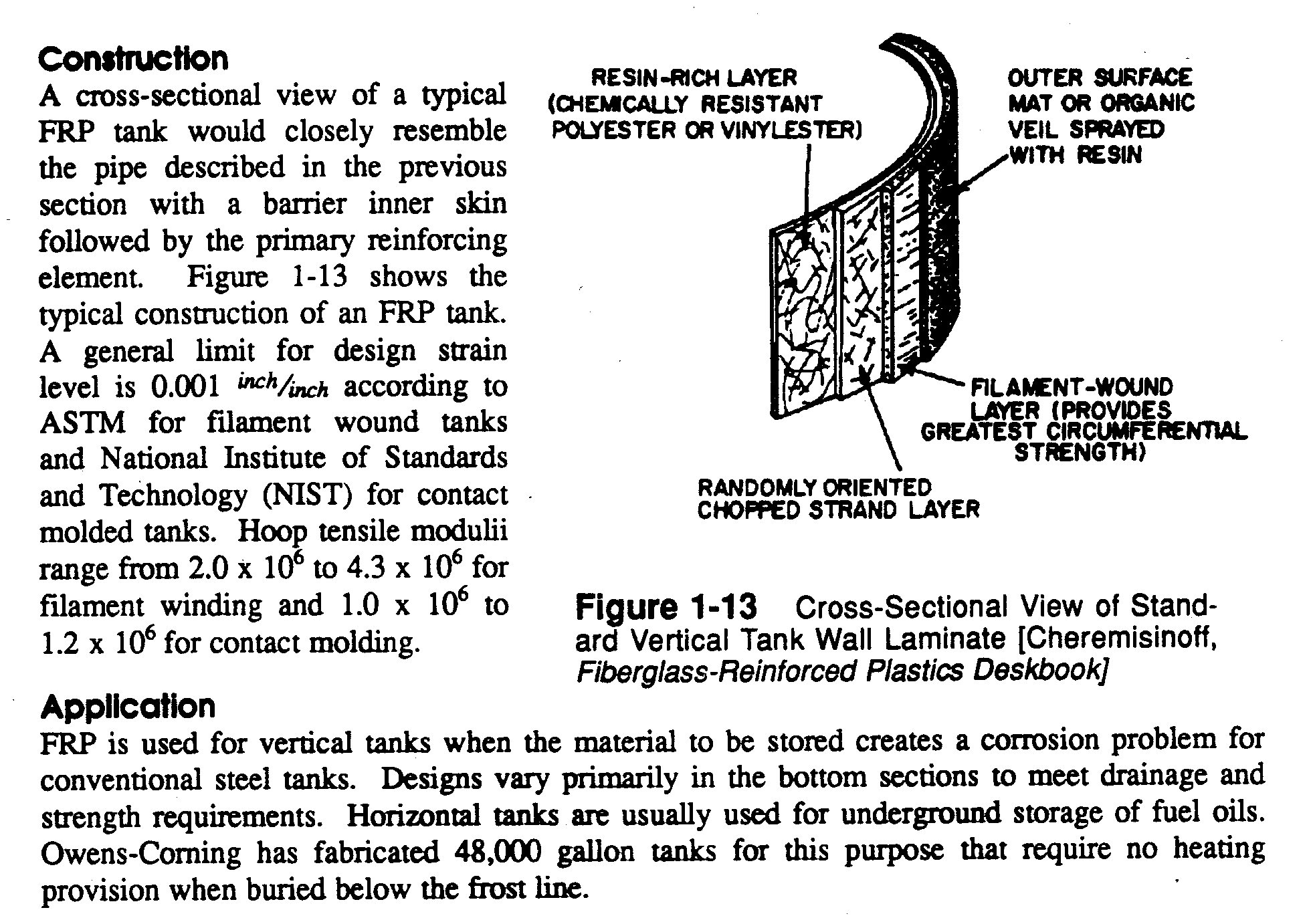

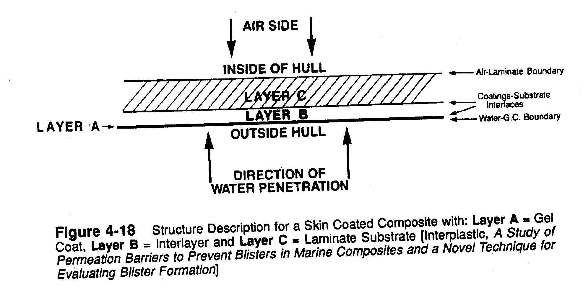

    You misunderstood what I wrote Groper. Substituting a sanding primer in lieu of a gel coat is a bad idea. When the surface is in constant contact with water, a resin rich layer is used as an outer layer as a barrier. As I have stated, gelcoat is not the best as it has a lot of solid content. Pure resin is the best.
    In commercial applications such as water pipes and tanks, a resin rich layer of veil or surfacing mat is used in the initial layer (inside, where it contacts with water), followed by a light CSM.
    Sanding primer contains a lot of soft solid particles to make it easy to sand. In some cases, microbaloons is used. It is not a good water barrier. Images from Marine Composites.
