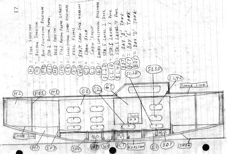

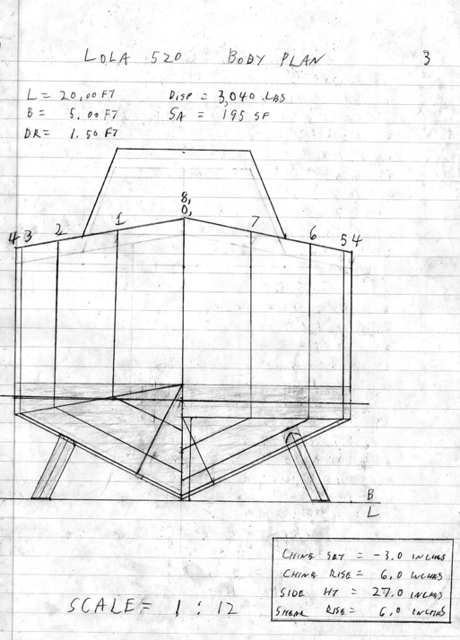

    Although I admire Sven greatly, he apparently lacks understanding of some fundemental peinciples of boat design. He apparently does not know how to calculate initial stability or the effects of moving weight on trim. His biggest mistake seems to be puting his deck work stations too near the ends of his boat.
    A more central cabin would have worked much better. His plan of manually moving his masts, while on deck himself, also seems to be a predictably bad one. A 41 inch wide deck and very low initial stability is an overboard waiting to happen.
    Devising a way to strike and set sails remotetely is one suggestion I would like to make for any future boats. ExLex was also rediculously underpowered. I came up with an S/D of less thean 4.0 for the fully loaded ExLex. It should have at least double that. It may be possible to set up a brail system for the balanced lug sails, so the booms could be pulled up to the yards with single lines to the aft work station. If ExLex were to be salvaged I would recommend using three sails as a working rig, making the boat a tiny three masted schooner. The booms could be lengthened from about 1.42 m to about 1.85 m, which with the same hoist, would increase the SA to about 7.8 sm. SA could then be reduced by first striking the center sail, then later by striking the end sails and resetting the center one. A storm sail could be set from the center mast. The main idea here is to keep the single heaviest objet on the boat, the skipper, as close to the center of the boat as possible at all times.
    The Steering problem could probably be solved with slightly less tight fitting pistons. The over all weight of the boat could be reduced by removing maybe half of the stores and having them shipped to a stopping off point along the voyage's way. If this plan were implemented, it may not be nessessary to lengthen any spars.
    Attached are some sketches of a design which is similar in intent to ExLex. L520da.png L529ba.png
