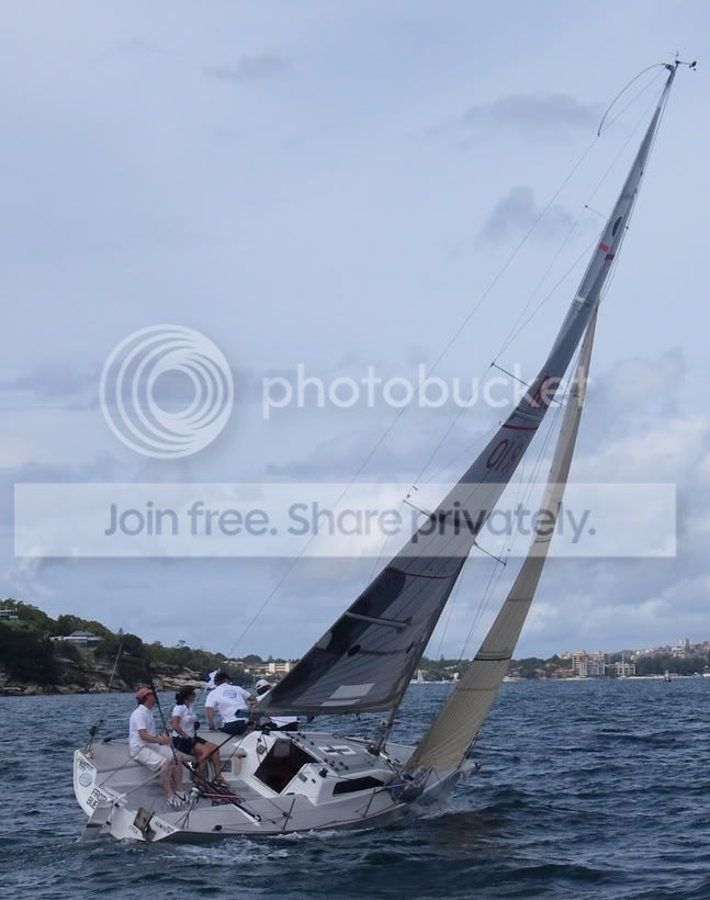

    Nope the (faster) Rockets are round bilge like the 840 above, i sail one in Sydney
    the chine 780 surfing there is rocket-ish for sure, a forerunner home chine home-build
    the lines planis the waterballasted 6.0 mtr i think
    There is also a TY, roomier round bilge performance design called the Young 770, which has more freeboard than the Rocket, and more interior comforts
    Rocket 780 below

    Gybeset, the chined wave surfing boat, Sew Easy, is a 6 metre stitch and tape design. I did a boat test on it years ago and that shot is from the article - and the lines plan is from the 780; again I did stuff on that design too.
    The round bilge design in the large photograph looks very neat and that must be a smaller version development of the round bilge 840. I'll ask Jim next time I see him. Cheers.

    Comment from Jim Young:
    That is Signs of Life, one of the first round bilge 780’s, cruising, lift keel 780 and there’s a racing 780 Rocket, my New Zealand boat.
    The Young 840 I designed for my son Frank, and one of his requirements was that it fit into a shipping container - so it limited the beam to 10 feet. It would have been better if I could have gone out another foot, or even to 12 feet and that would have made it a lot faster boat. But never mind, that 840 I owned, Young n Frisky, was a really good little boat and the fastest for her size during the time I raced her. Then I finally got sick of Wednesday night racing, and so I sold her. Now the centreboard weighed with the ballast about 1000lbs and we had to raise this on a winch by hand – which was very hard work. So I thought I couldn’t sell the boat with that arrangement and went and bought a little electric winch and a battery. All you had to do after that was fitted was press a button and this heavy keel would go easily and painlessly up and down. I should have done that from the word go. That’s how far you will go to save weight.
