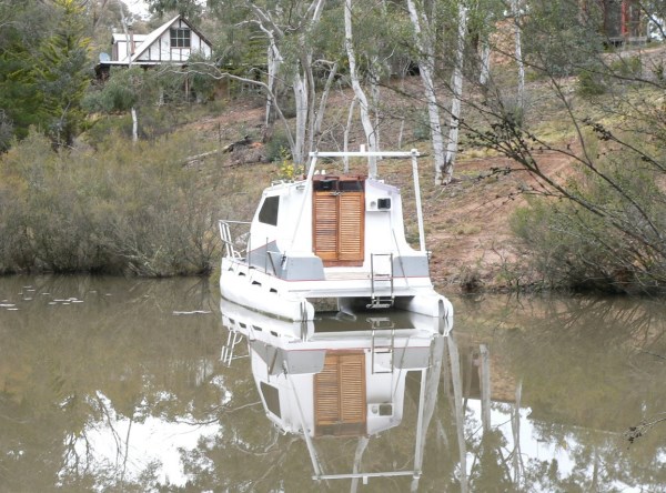

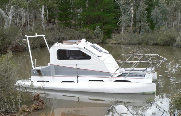

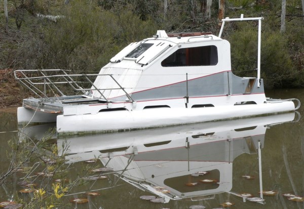

    Some may remember how this project started - my trimaran was torched after having had most of the expensive stuff stolen. I recovered the amas and some other gear, then bought lots of stuff second hand and cobbled together a little in-shore cat - big enough for me and the dog. Total cost around $3k including a lovely skiff mast and rig and a Honda 8Hp outboard (neither fitted yet)
    I wanted to check the floatation level and resolve any launching issues before braving the bloody terrible bush roads and having gawkers (stink-boat drivers and the public) hassling me. My dam in the bush was an obvious option.
    First the good news:
    It floats
    Even on the designed waterline
    Yes it is fairly (well, very) ugly, but think of it as a sailing caravan with bunks, a small galley, porta-potti and stereo.
    There are no stink-boat drivers waiting on the launch ramp yelling "come-on get on with it" and therefore, no-one gets abused or punched
    Now the bad news:
    The aft trailer roller is too high to clear the fore-beam when launching - that means some major design changes to the trailer. That aft roller may have to be made telescopic and a second winch added to pull down/raise the bow of the boat during launch/recovery
    The welds holding the rollers to the trailer base frame are not strong enough and need reinforcing webs
    The fore-beam of the boat must be reinforced with straps onto the hulls or the upward pull of the mast could tear it loose
    On balance, putting "BITZA" into the dam was a good move because I would hate to have made these observations on a public slipway. Of course, getting the bloody thing OUT of the dam again will be quite another challenge.
