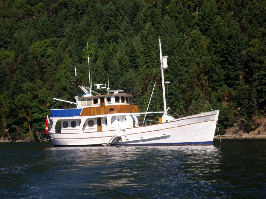

    A 492ft boat with a 125ft thingy on the back is not much different to a 55
    romsdale trawler with a pilot house 10ft off the water plus 7ft headroom (17ft ) similar to a nordhavn 55 23ft above the water and they are still floating around
  4. nzboy
    Joined: Apr 2011
    Posts: 154
    Likes: 4, Points: 18, Legacy Rep: 36
    Location: nz
    nzboy Senior Member
    Another Romsdale still floating upright
