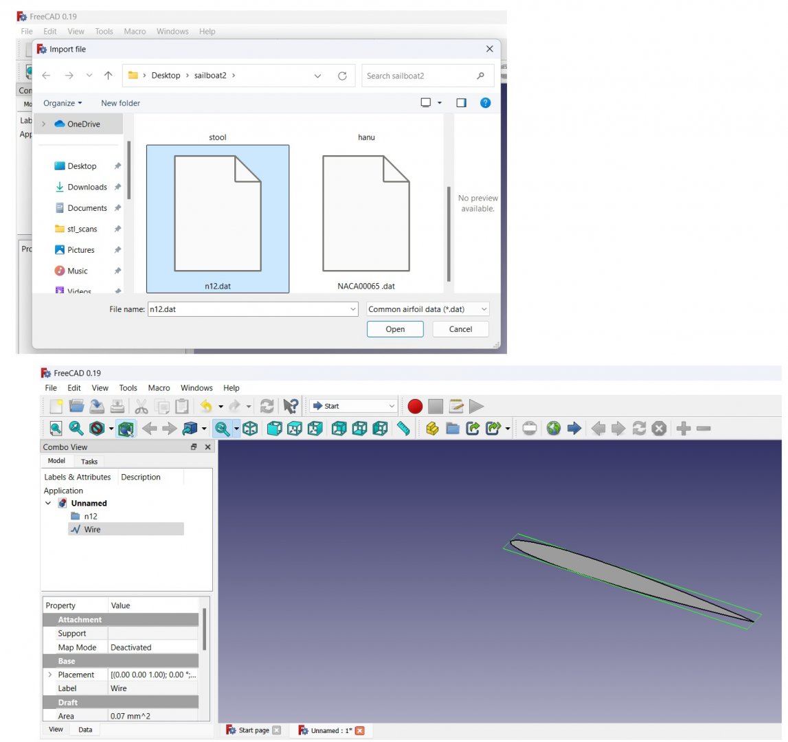

    If you have it in FreeCAD format, I'd like to see how you created if.
    This is a quick exercise I did in FreeCAD watching a tutorial, it's OK as far as it goes, but I have to learn how to plot the exact foil section I want. Just tweaking a bspline seems a bit hit-and-miss.

    FreeCAD should be able to read in airfoils in the *.dat format.
    https://m-selig.ae.illinois.edu/ads/coord/n12.dat copy the text and save as a text file with the extension .dat
    @ Zoro the foil you attached above looks nice, eventually you will want it not to taper to zero at the trailing edge.
    Zoro likes this.

    Yes, that seems to have worked. I think I can generate .dat files on that NACA foil website. Now I just have to workout how to use the import properly. More vid tutorials!

    There is an add on for importing .dat but it gives the panelled surface that aerodynamicists regard as normal in their field.I find the two rail sweep rather weird in operation but it does work in it's own way.I find it a bit slower to use constrained points in construction mode on the Sketcher workbench and to locate a spline through them if I want a single surface.I have had luck with scaling and locating these sections along the outline and then lofting through them.For the tip fairing I have sometimes used a narrow extrusion of the profile-say 2mm and created a fairing between the bottom of the foil and the edge of the narrow strip with G2 or better continuity to the foil and G0 at the narrow strip.In hindsight I would have used an upswept arc at the bottom of the rudder head, using a rise of maybe 80mm across the chord.I have been learning Frecad for a while as the Path/Cam workbench is useful for generating toolpaths for my hobby CNC router and vastly cheaper than a seat of Mastercam.For surface blending,this video may be useful

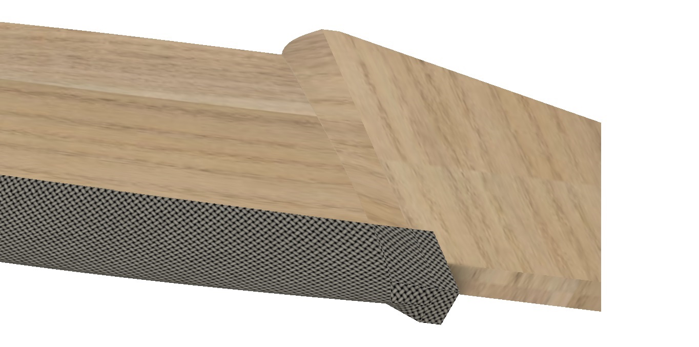

    If you do manage to cover your rudder in one operation,it may be possible to ignore the suggestion to use blunt trailing edge.I have found that adding a slightly flexible support inside the vac bag,but outside the release film will support the trailing edge laminate.With the thinnest sensible trailing edge you can reduce the possibility of a humming rudder.It isn't the easiest thing to get a rudder as large as you propose to use bagged within the working life of the resin,but with a well briefed helper it can be done.I hope the attached file explains sufficiently.
    Zoro likes this.

    If one did a hybrid molding technique like Wet Feet shows in the PDF above, the trailing edge would not need a pre-wrap and maybe not even a post-wrap.
