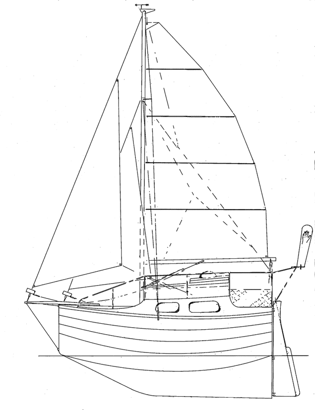

    Here is a plan for "Heron" by William Garden. This better illustrates the tunnel design. It humps up over the propeller to provide clean flow. It does have vertical sides and would not be too difficult to build.
