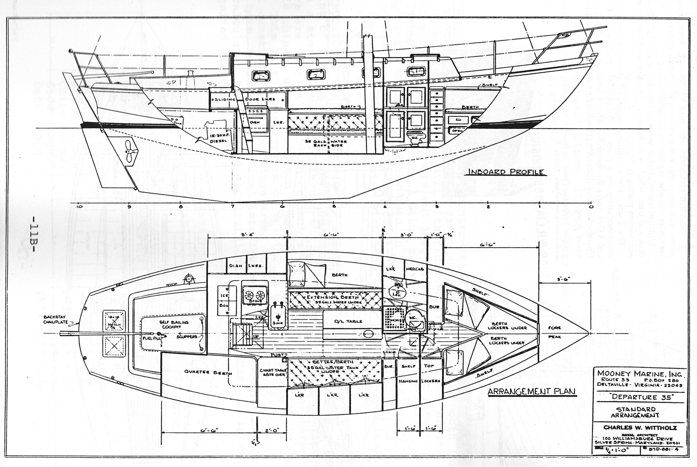

    And this is the later steel Departure 35 with outboard rudder, this was done for stock builder Mooney Marine Inc in Deltaville Virginia.....LOA 35'0", LWL 27'10", Beam 11'0", Draft 5'0", Displacement 16,480 pounds, Ballast 5500 lbs, 586 sq ft sail.

    Tad
    That's the boat in your last post. If it was a production boat that would explain why there's no lines plans or offsets in any of the drawings people have.
    It's all very helpful. Thanks.
