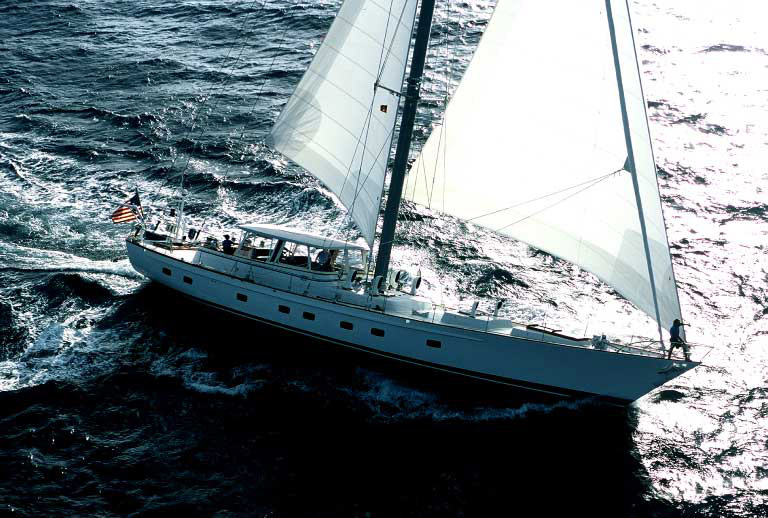

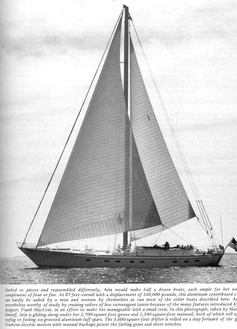

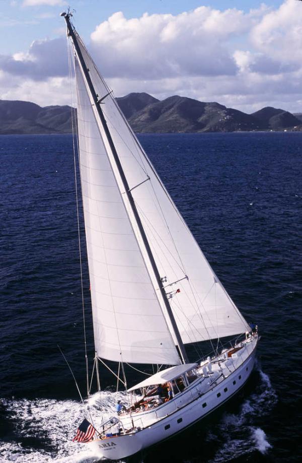

To get back on track with A Frame rigs, Frank MacLear designed some beautiful rigs back in the early 70' but of course didn't have the advanced rig materials, lightweight sail materials, advanced roller reefing technology or IT programmes that we enjoy today. Just imagine ARIA a Palmer Johnson 87' yacht with an A Frame. Despite being built in 1975, (40 years ago!) she had 14 electric engines running the furling systems and primary winches enabling her (as much as possible) to be sailed by a couple.
Frank MacLear was years ahead of his time.

Thanks for posting those photos RHP.
Don't know what real benefit those rigs would have with an wishbone mast over their existing configurations?
But I can see what he (and the others) were striving for with that bigger headsail and boomless/roller furling mainsail configuration,...simplicity and single-handed capabilities.
Perhaps with their more aft placed mast (central), and emphasis on the roller furling aspect they belong in the aft-mast discussion (I'll place a link there)
Regards, Brian
Nice pictures, but none of them are an A-frame.
Were you getting back to A-frames or was it I "wish" it was a wish bone rig?

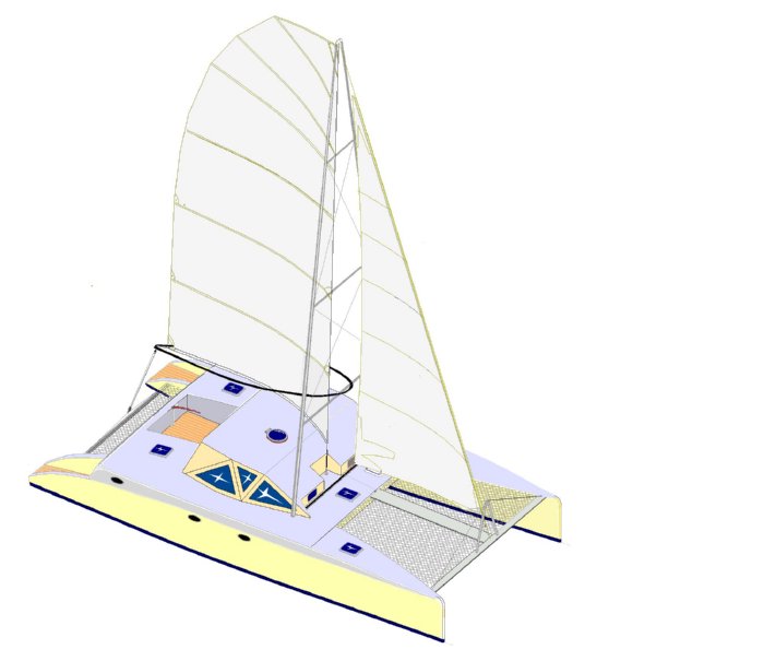

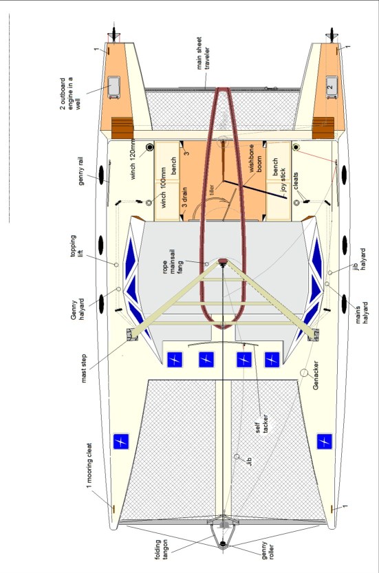

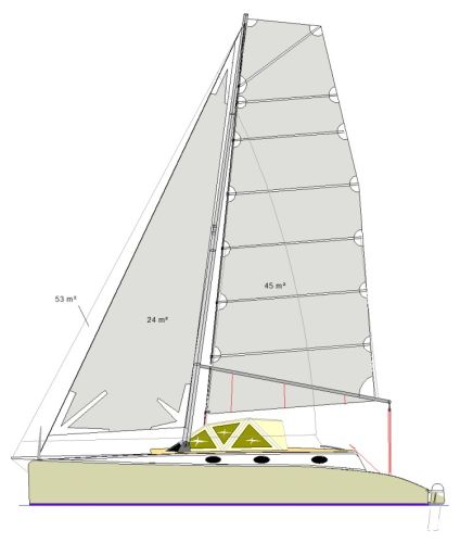

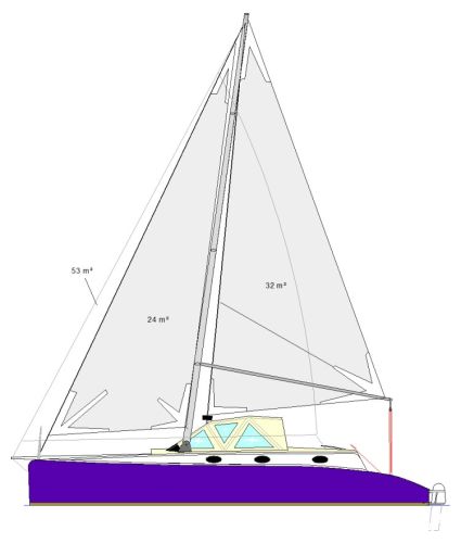

Voyager cat design
Hi, I am the designer of the Voyager (cat) with the A-frame mast.
Cheers, Bernd
The attached photo shows an A-frame mast on a tri. I made the photo last Sunday in Sete/France
Thought it would be interesting to post a few more details about Bernd's Voyager cat design.
http://www.ikarus342000.com/VOYAGERpage.htm
http://www.ikarus342000.com/VOYAGERpage2.htm
...posted some dwgs in case the website disappears (as seems to happen often these days)
