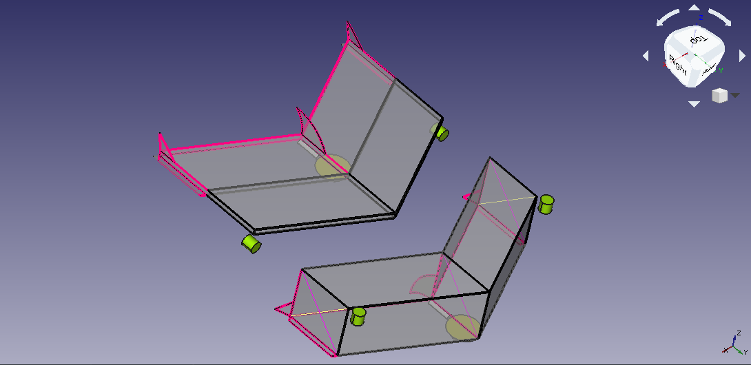

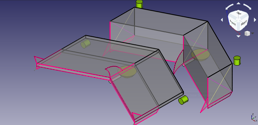

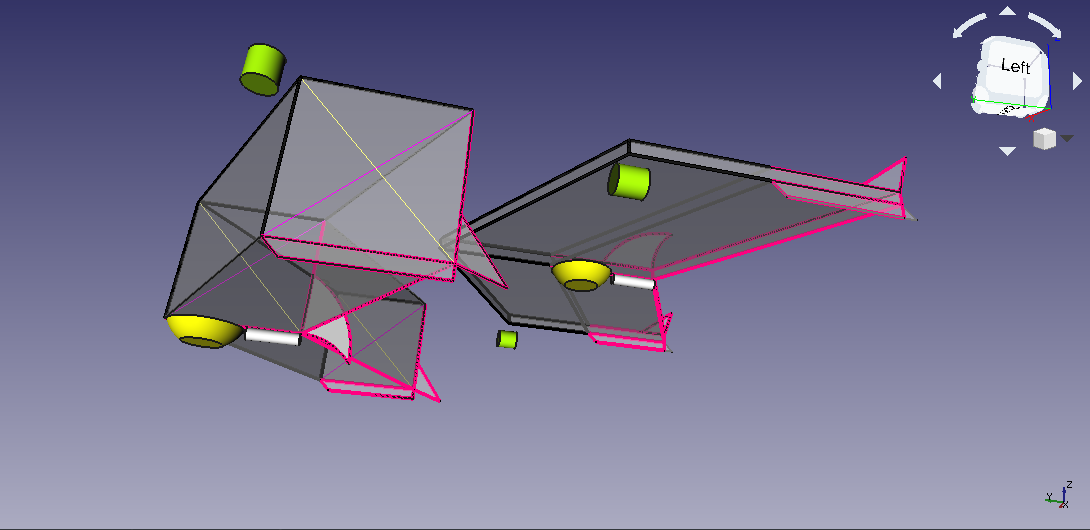

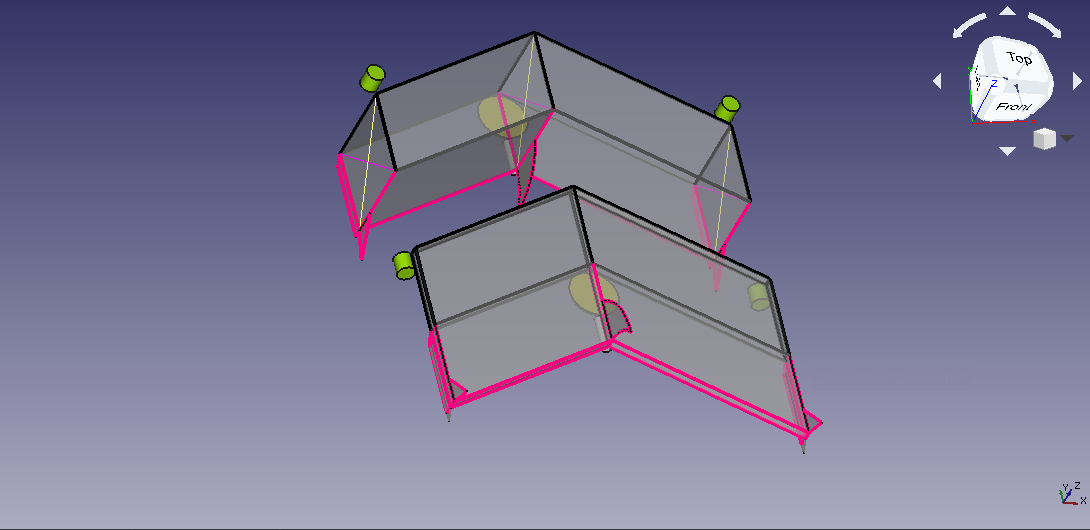

    This is result of a "brainspiral" from another thread here:
    Exofish!....a WIG canoe https://www.boatdesign.net/threads/exofish-a-wig-canoe.65590/page-3
    It's just a dreaming. But I thought might as well make the sketch look a bit more like a concept. The concept is a balloon can transform into a wing and a wing transforms to a balloon. The purpose? Perhaps getting to a fishing spot quicker, and has a boat (/ hover-boat) platform.
    Since I don't know of anything like this yet, I'm calling it a winglloon.
    • All the gray volumes are filled with helium, and the gas reusable, with a tank for the compressed, and to supply when transforming to the balloon form.
    • Shifting the shape changes the volume and can control the buoyancy. It's done with an internal strap system coupling the helium supply/compress system. So this should be easy to adjust to weight of loads.
    • Definitely has to be light weight & strong. Maybe CF frame structure, Hypalon, nylon string reinforce...? Let's just say this is not specified...
    • EDF, so placements are easier and system is easier.
    • There are lots of surface for solar cells, but weight penalty definitely need consideration.
    • A small generator to supply more power or to charge battery as necessary, and for emergency.
    • No, I don't know if it will fly. But if cardboards can fly this probably can too. It's just how stable. Anyway, don't ask.
    • Yah, this is definitely strictly for fair weather only.
    • Why is this a boat? Not sure. But it has a sea anchor or a few. So it can stay still at a fishing spot. It can hover just above the waves, but probably shouldn't be a problem if dip in the water either.
    I think that's as far as this dreaming goes for me. I don't think I will or have the resources to test this. But if anybody happen to be interested enough to take on this concept, should be exciting to see how it can be done.

    It took me a while to figure out what I was looking at, but it seems you've built a box that bends around a corner in the middle ... and then you expect it to fold flat. I don't think that's possible. You'd better make a little cardboard model with tape hinges and try it.

    Thanks for pointing out. Yah the center will need a triangular cut & join with more pieces. So the tail fin will definitely be higher & further back when folded down. There are lots more missing details. Like elevator will definitely need. And I was thinking at both front & back, on the surface rather than at rear edge (so 4 piece (front & back) on upper surface, 4 pc (front & back) lower surface). And don't think need rudder, since the EDF can do differential thrust to achieve yaw.

    After you get done fixing that hinge problem you might consider the fact that neither of these shapes is the least bit aerodynamic, and the unsupported skin would flap and flog itself to ribbons. Also, unless the expanded version is roughly the size of a small office building, filling it with helium is going to be pretty disappointing, although it would tighten the skin, as the pressurized containment tries to assume a spherical shape. You'll need to substitute Cavorite, or perhaps unicorn farts--but once it's big enough for helium to lift it, plain old hot air would work almost as well at a fraction of the cost.
    Here's an idea: consider the old WWI aircraft--biplanes. Now delete the fuselage and just keep the wing assembly. As a starting point, that gives you two perfectly good airfoils, and you can play around with simple hinges to fold them against one another (though I'm not sure there'd be any advantage in that). You can easily build a scale model to play with.

    There isn't enough volume of Helium to lift the square "balloon" which needs to be very rigid to keep the shape you designed (= very heavy), the compressor, high pressure tank, boat, crew, etc. Do the numbers for the volume of Helium you would need to lift all the stuff.

    No it's not meant to 'strictly' stay square, what shape the balloon form assumes really doesn't matter. Shape, or maybe rigidity, during wing form matters more. But soft wing like hang-gliders should work just fine, using frame to more or less keep it a wing. Keeping some helium pressure in the wing will help the frame a lot. Reinforcement fiber strands will also help. If the dimension is for example 10m x 10m x 20m x 2, it's ~4 tons lift; 15m x 15m x 30m x 2 you get ~13.5 tons. So if the math for the structure, tank & pump can float, other loads can just cover by size. Weight of the tank is major issue indeed. 400 bars is already pushing the envelop even for composite. Hot helium could help to boost the performance, and reduce the amount of gas needed, but then it becomes even more tricky to keep it in; and to compress.. Definitely a lot of devils in details, but still think it's plausible.
    Or alternative design can be just make two of the wing surfaces and expand vertical to get the balloon. Will need a bit more frame & stiffer frame, but for twice the volume (& size), probably well worth it. However, it means the z aspect is shorter to both the x & y, rather than just one. So not sure if that matters until it's tested. (Normally balloons are taller than wide, even airships are not completely flat..)
    I should also add this is not a design sketch, it's just a rough idea sketch; or so called concept sketch.
