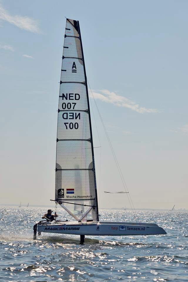

In the this years Little America's Cup and in the previous version of that race the winner, Groupama, sealed their wing to the tramp. In AC 34 Oracle did the same with their wing on the AC 72. This year the A Class featured two of the top guys using a rig that sealed the main to the tramp-both are convinced that it helps a lot.
A Class rig by Mischa Heemskerk:
(Henk de Grad picture)
