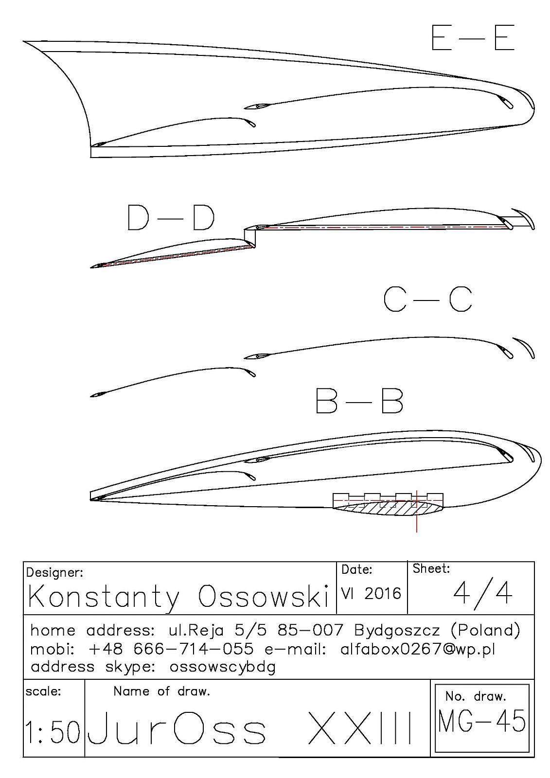

    Reefing sail type kasperwing
    Super. Even slot has. I will try to insert sail type kasperwing in my drawing proa. It should be able reefing.

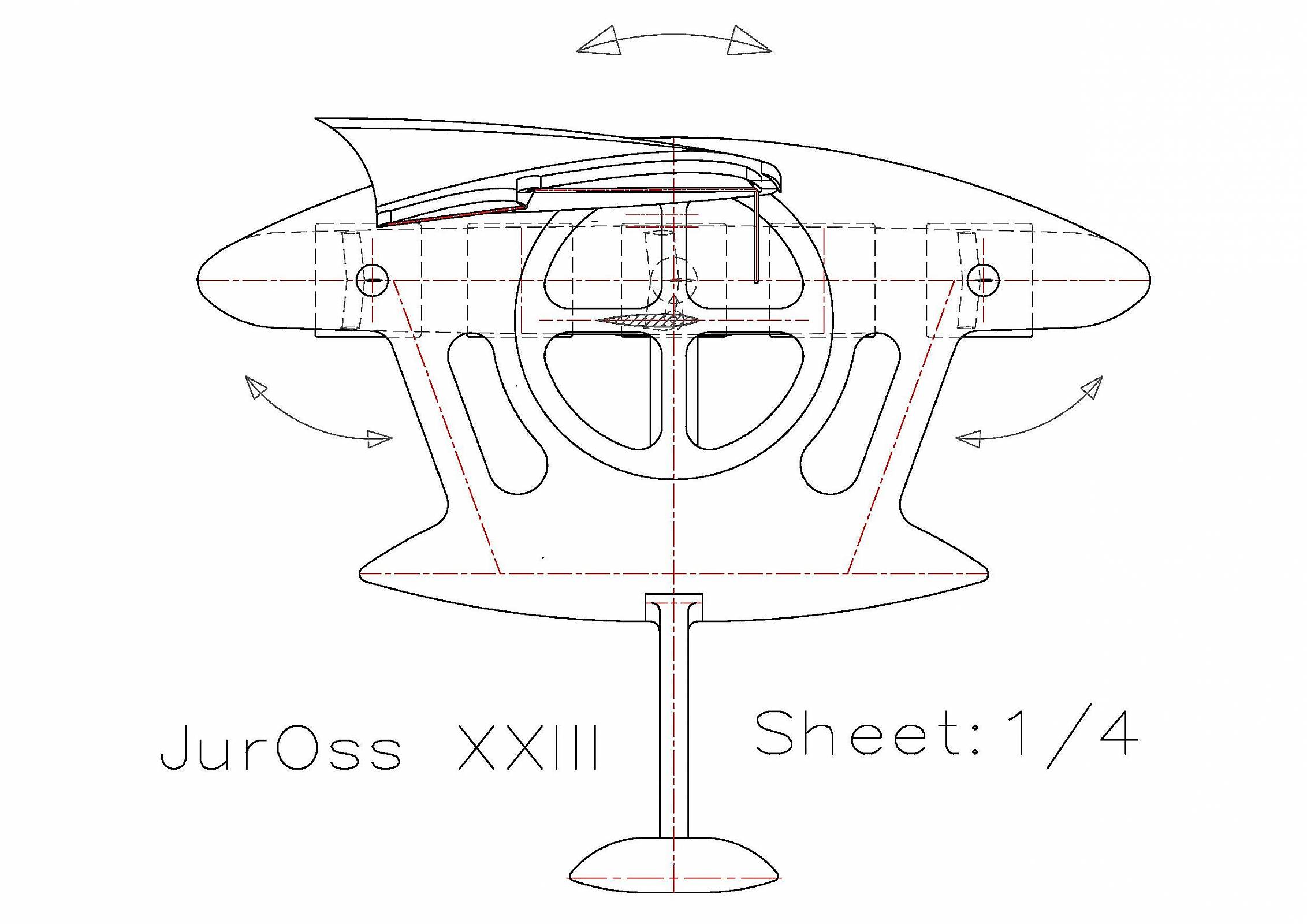

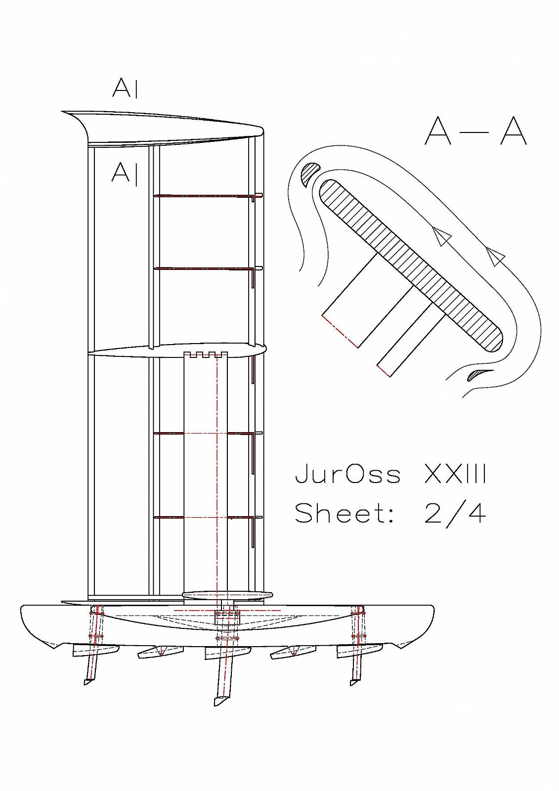

    Canting keel and canting wing sali.
    It was supposed to be kasperwing sail, but done the slot - wing - flap sail.

  13. Konstanty
    Joined: Mar 2016
    Posts: 95
    Likes: 4, Points: 8, Legacy Rep: 10
    Location: Bydgoszcz Poland
    Konstanty Junior Member
    Sails at last drawings not caming from kasperwing. That is tradicional STOLD type slot - wing - flap.
  14. Petros
    Joined: Oct 2007
    Posts: 2,936
    Likes: 148, Points: 63, Legacy Rep: 1593
    Location: Arlington, WA-USA
    Petros Senior Member
    yes that is true, and it appears to be a wing shape designed to be used as a sail. Something like that can be made to work reasonably well.
    The title of the thread is to use a Kasperwing as a sail, that would be a wasted of time and effort.
