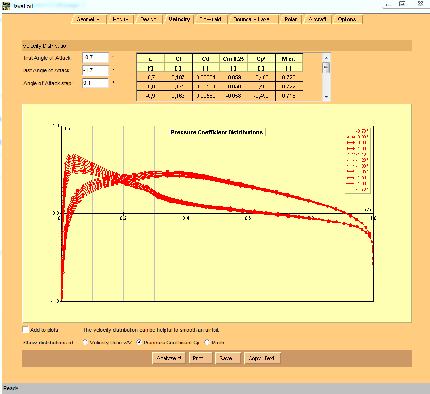

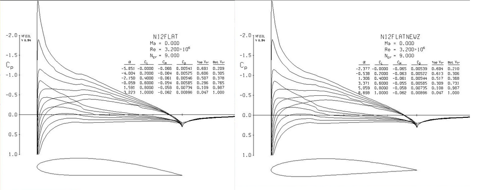

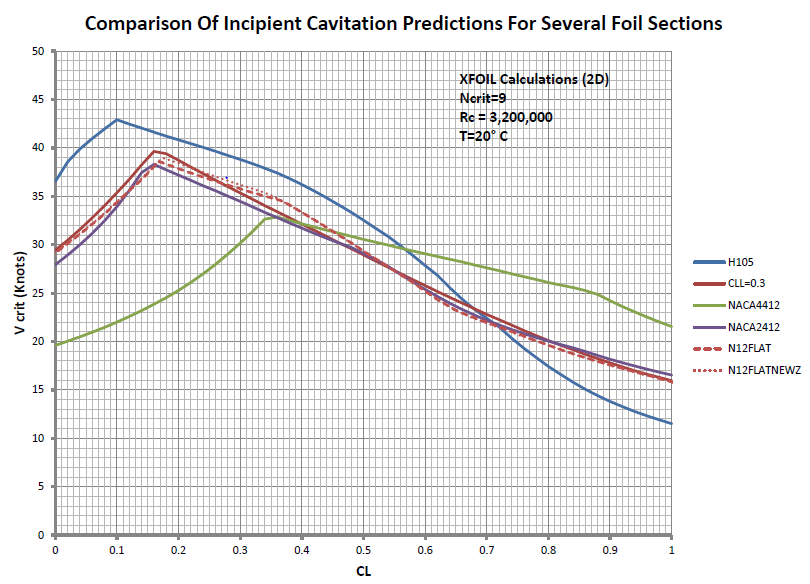

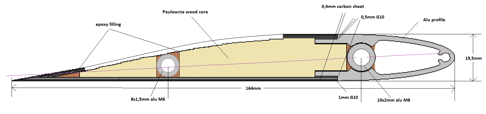

    Have fine tuned the foil section, with Doug Halsey helping me doublecheck it in XFOIL.
    I have also made the router file for the paulownia core.
    Think this is as good as it gets for a DIYer, using the Foil Nose for the first 27% and a flat bottom. The new N12FLATZ still uses the added +/- coordinates from NACA0012, where I have slightly manipulated the thickness from 27-46% chord length in Excel. Used the Pressure Coefficient Cp function in JavaFoil, to visually check the result and tame the irregularities.
    The first two XFOIL graphs was kindly supplied by Doug H.

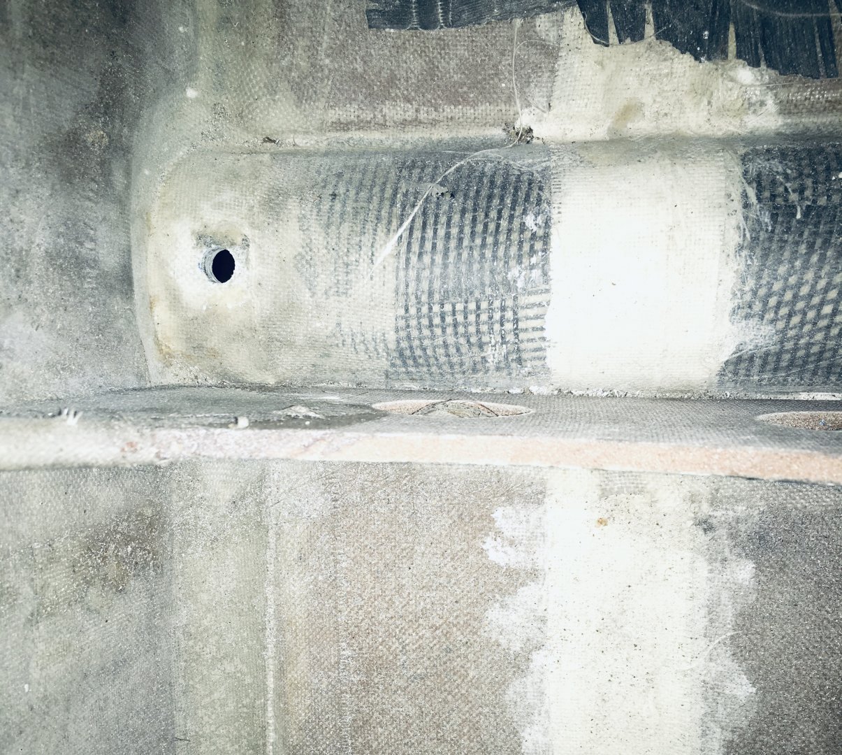

    Sorry Jim, had to read your reports again. I understand it foiled well with only you on it, found the image below. It would probably only have needed more SA for two persons to foil earlier? Get the impression that you couldn´t adjust incidence on the rudder foil and because of that had to stand to balance it lengthwise?

    It foiled well with 2 people, only took about 12-13 knots of wind too. It just was weak in some critical locations. The final straw was a big crack in the junction of the forward aka and one of the side plates that were welded on the ends to attach the amas. The main foils' angle of attack were adjustable via 3 bolts per foil. You had to go to shore and use wrenches to do it. The rear t-foil's angle of attack was adjustable via a pin that went through the rudder cheeks and through various holes in the top of the rudder. You could do it while sailing, but you had to stop to do it. So no, the foils were not actively adjusted like a moth, with the feeler out front. That's a very hard problem to solve. I actually enjoyed "riding" it by moving around to change the angle of attack. You could instigate getting up on a foil that way and then leveling it out once you got going. Very exhilarating. I windfoil (windsurfer with hydrofoil) too, and you need to weight shift on that too to maintain level flight.

    These are the N12FLATZ section coordinates.

    You might want to run those Xfoil analyses again using 1<Ncrit<3. I don't think you'll ever get the kind of laminar flow in water that is predicted using Xfoil's default Ncrit=9.
  10. revintage
    Joined: Nov 2016
    Posts: 424
    Likes: 107, Points: 43, Legacy Rep: 10
    Location: Sweden
    revintage Senior Member
    Thanks for pointing that out. Anyway this might be of less importance as the analyses are just for comparision between sections?
    Adding a *.dat/txt file if you wish to check it, I would really appreciate if you did, makes me curious and eager to find out.

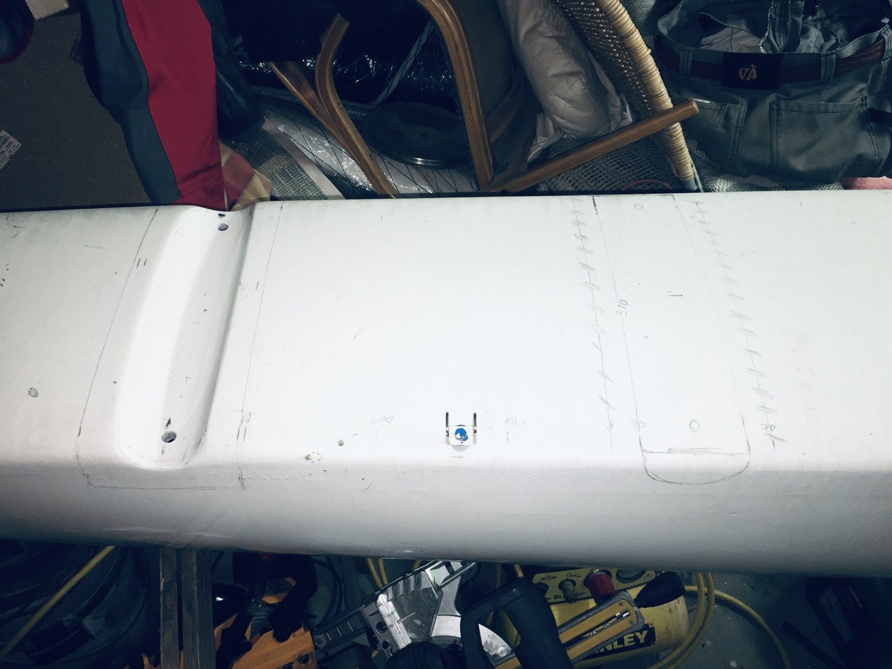

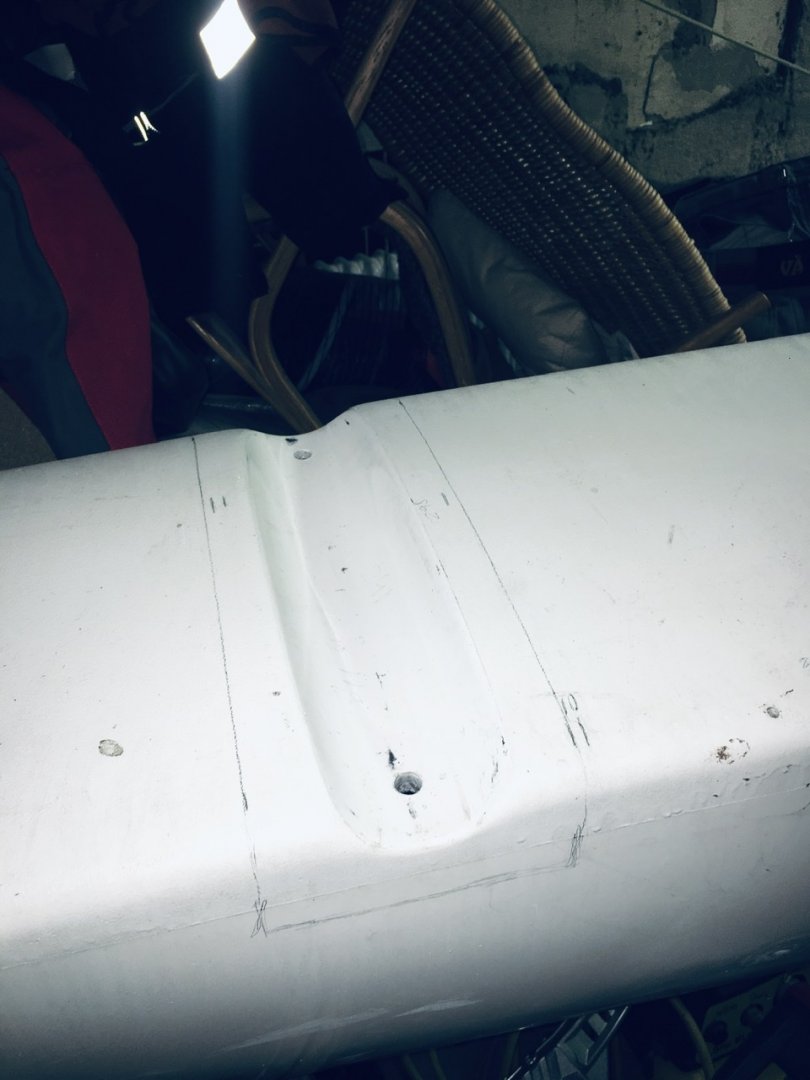

    Have been working on the A-cat center hull and realized the rear beam pocket is far to much to the rear. Instead of adding fittings on top of the deck, my idea is to cut out the original beam pocket including reinforcement and mount it from the underside a little further forward. This should be doable as the hull is ca 1.5cm wider if moving the pocket 0.5m forward where a smaller slot is cut. Building up new surfaces where the original pocket was, should not be a big problem.
    054C16F1-F843-4785-AE9A-638234CEB7D2.jpeg 3F36A3ED-37B0-4FA1-ABEA-ACCAA84819B4.jpeg 1AAB1636-42CC-4AE4-8B15-BC47CA74C3D1.jpeg 243EFE92-7993-4FCC-8FA2-C658C9EB268A.jpeg

    Cut out the pieces and will now fit the beam pocket under the forward slot. The rear beam will now sit perfectly to be sheeted from.

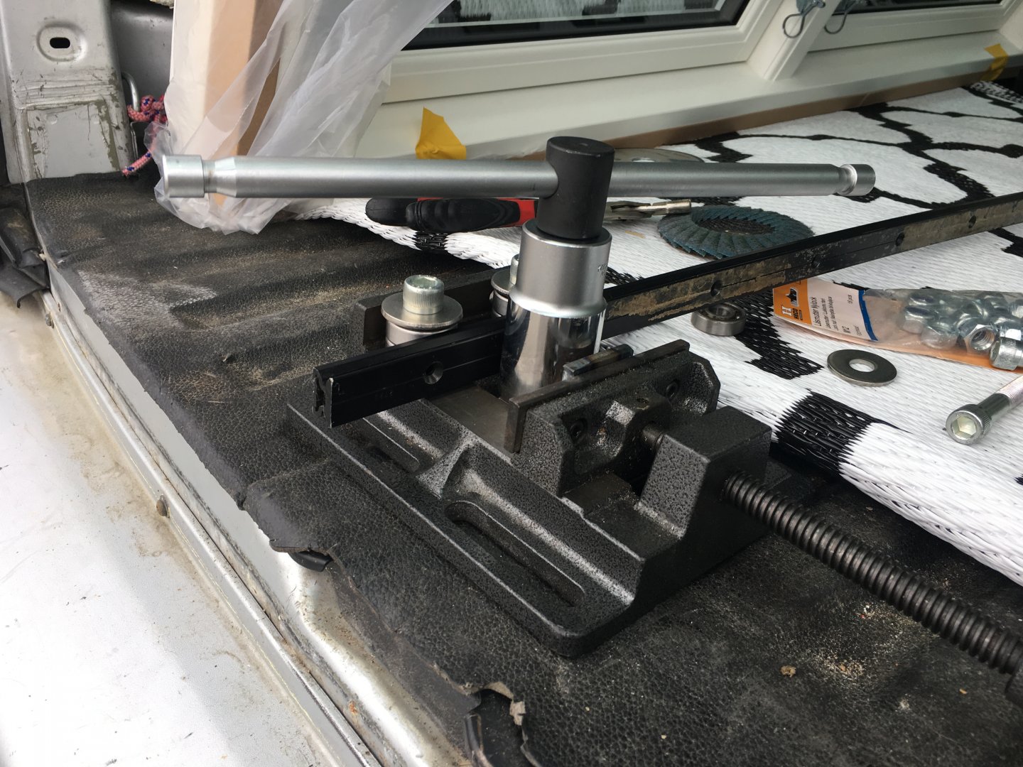

    Settled for this version, where I will use the roller bender I built last summer, to make a 20x20mm square alu rod be inline with the waterstays. The "striker rod" will be 15mm round alu. M6(M8?) eye nuts on the outside.

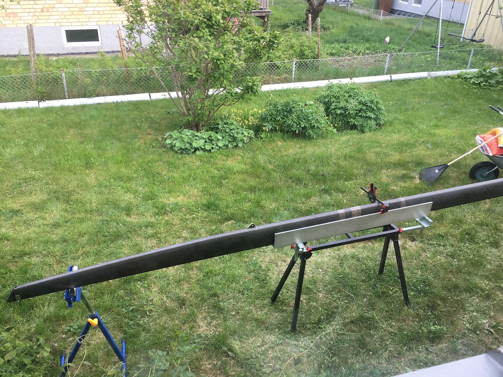

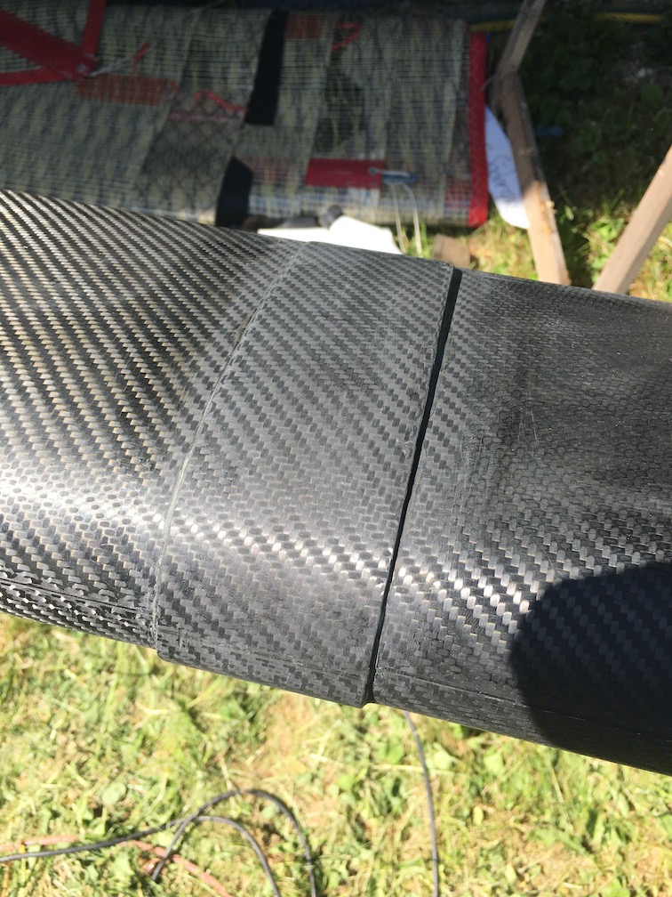

    Quite a while since I updated. Have found a broken in two Flying Phantom Elite carbon mast with 76x180mm section and everything is ready for epoxying. The mast was 9.6m and I managed to get the necessary 7.9m plus 0.6m sleeve out of it. Instead of messing with an inside reinforcement for the spreaders, I took the easy way out and opted for an outside sleeve.
    Just waiting for the PRO-SET ADV-175/ADV-276, recommended by Hamish at Wessex for the job, to arrive from abroad.
    The epoxy comes in 400ml cartridges to be mixed 2:1. Anyone who has got an idea how to use the cartridge without the far to expensive dispensing gun? Should be doable by modifying a std single cartridge gun.
