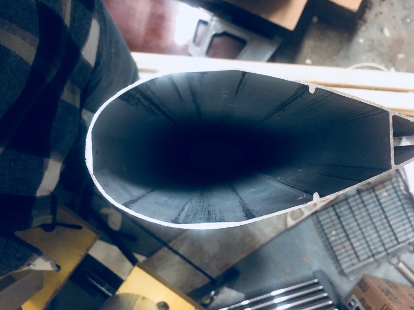

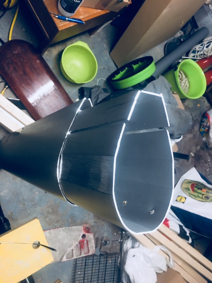

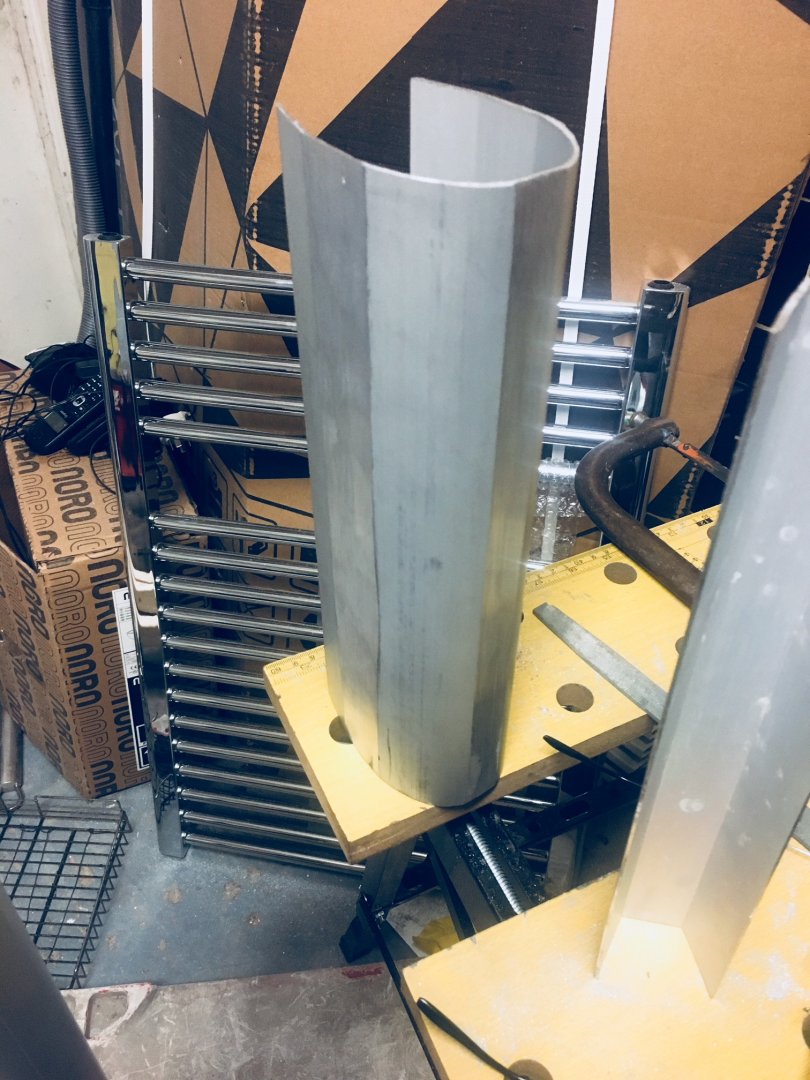

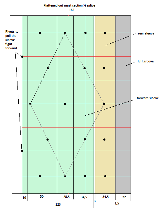

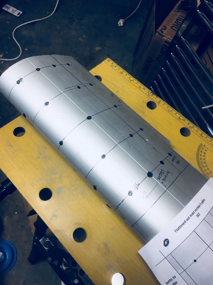

    Until recently I was into using an old T-mast, but decided to use it as flag pole in my garden instead:D.
    Bought one and was given three broken Goodall F18 masts and will instead splice two pieces from them, to make the 8,2m mast. If this works out as it should, I will also build a 9,5m mast for my widened Nacra 5.8 Frankencat with Inter 20 main. Got tremendous help from Canadian Tornado-guru Geoff Dobbs with the blind rivet diamond pattern and the splicing/sleeving technique.
    Made short experimental sleeves, the ordinary will be 60cm long when splicing the mast. The sleeve is made in two pieces due to the internal webs. Lots of grinding also needed on the forward sleeve.

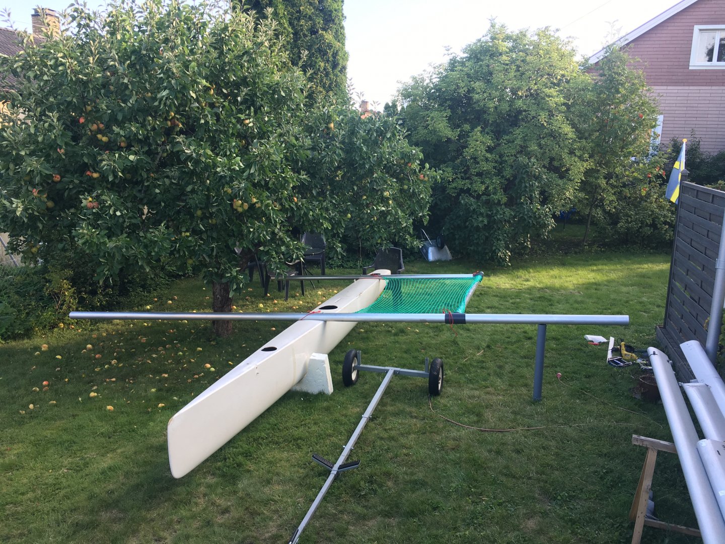

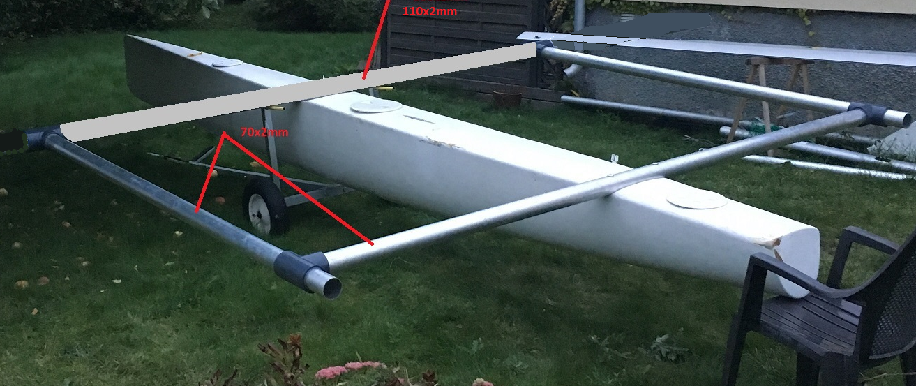

    To get grip of the beam configuration I laid the parts out on the lawn. Decided to go from 6 to 5.5m main beam. About the water stays I will go for 1.5m from center, the same width as the 3m rear beam.

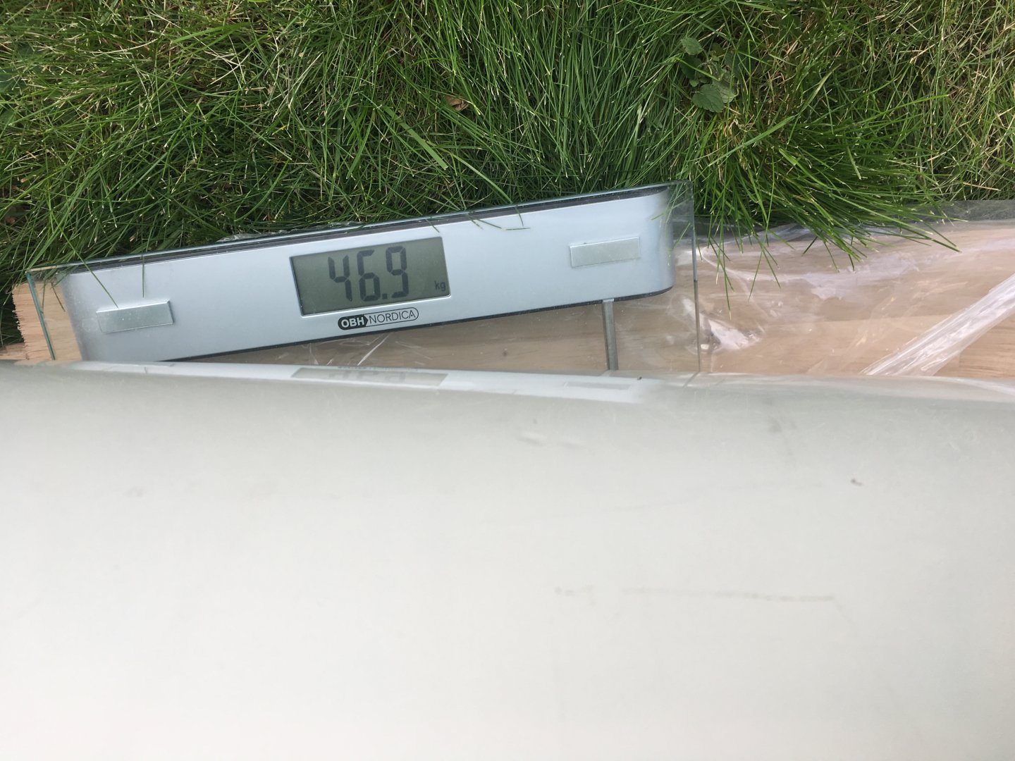

    Step by step..........
    As the aluminium tubes are notched to the diameter of the tube they meet, they interlock perfectly in kombination with the PVC fittings. This solution also makes it easy to dismantle the boat for transportation. Have not found out how to fix the nets to the gunwales, but thinking of epoxied Dyneema soft eyes every 10cm along it. The green nets will probably be substituted with a heavier quality in black or with the same polyethylene fabric as used in beachcat trampolines. With the scales at 46.9kg including the right side PVC fittings, tube and net, the goal of sub 50kg will still be reached with the forestay bulkhead and carbon rudder gantry in place.

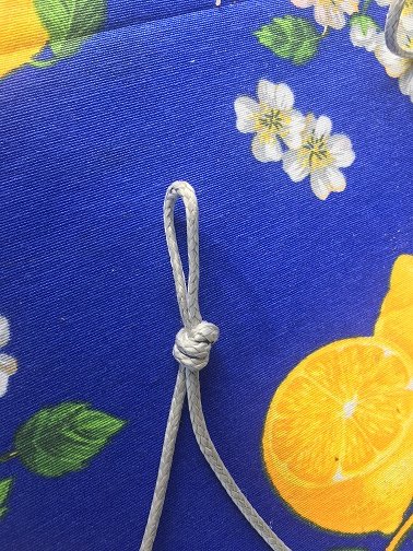

    On the nets, you cannot just use Dyneema as you plan, it eventually wears away and will cut though ( been there, done that and it does fail pretty quickly ), epoxying the fibres will actually make it worse. I would suggest you use what is effectively a soft shackle but put a SS thimble in the eye and the Chinese knot as the preventer from pulling through the hull. Simply take the thimble out, pass the eye through the hole in the hull, put the thimble back in and pull it all tight and snug. You will need to fill the foam around the hole, drill a 8 mm hole through only the outer layer of glass, use a small 90 degree bend on a piece of 2mm wire on a drill ( use several different depths so that only a few mm is taken off each time ), angle the wire through the outer skin into the foam, get the bend perpendicular, give the drill a quick whizz and the foam gets munched the depth of the 90 degree bend, fill with thickened epoxy, put a piece of gaffa tape over the now filled hole to stop it sagging, wait until set and then drill your 4mm or what ever size you need through both inner and outer layers and voila you have a fully filled and hardened area around the hole.

    About Dyneema eyes, I have already tried this, when fitting the corners of the nets to the wings I use on my widened Nacra. They where made with the eye coming out of a single hole with a knot and a SS washer on the inside. No epoxy used as the wings where aluminium. Of course a thimble can be added, not a bad idea, even if I haven´t experienced the wear you mention. I have made a few experiments with 3mm Dyneema and West G/Flex and I trust this to work in combination with the knot in the image, maybe with your suggested thimble added.

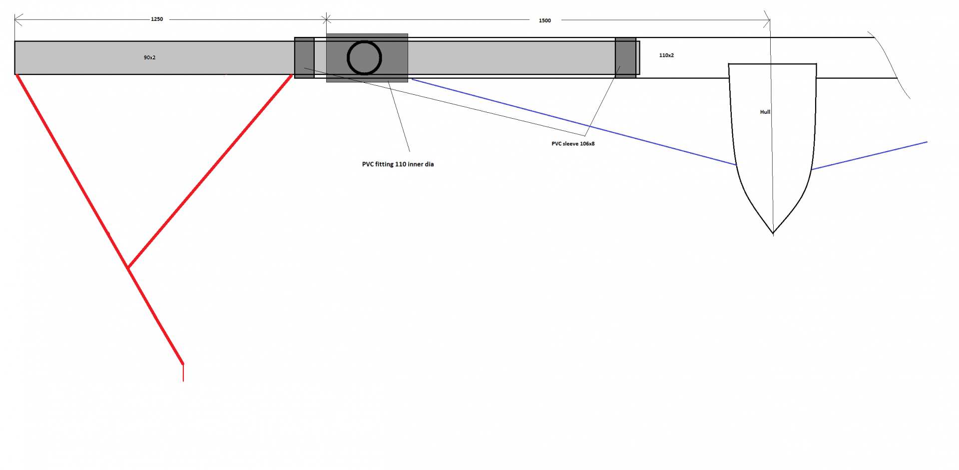

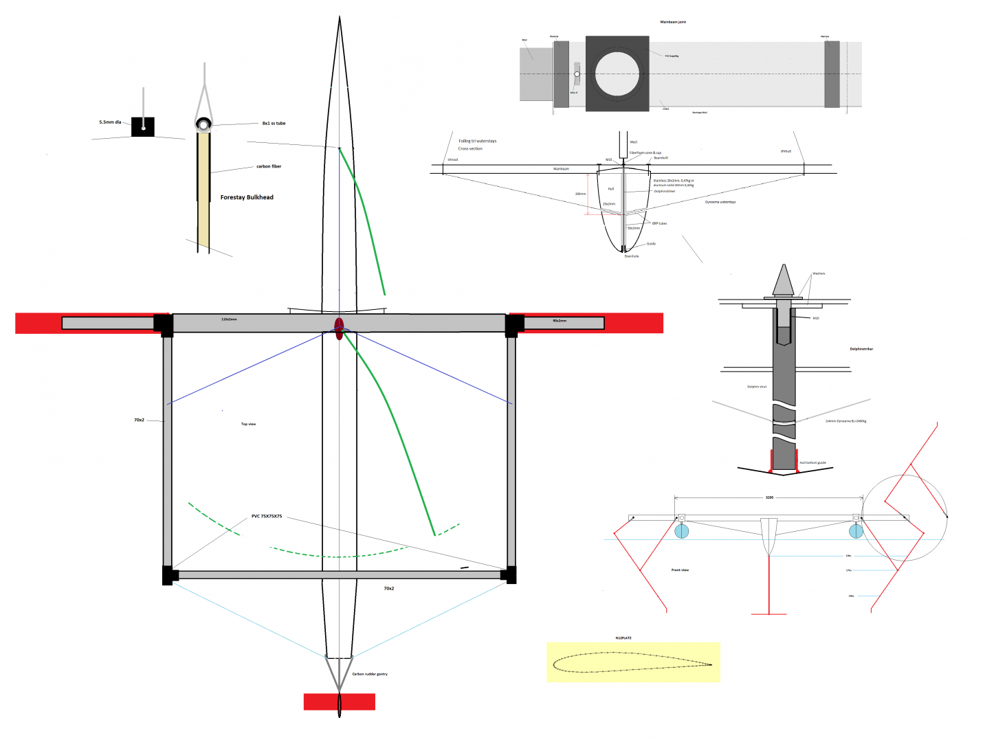

    Since August there has been some development on the platform since I realized how wide a 5.5 t0 6m tri is IRL. Have ordered a 3m 110x2mm alu tube to use as center on the main beam with the existing 90x2mm tube as telescoping outer ends with the foils fixed to them. This way I can have the main and rearbeam together with sidetube permanently fixed to each other. Have not decided whether to use clamps or bolts for locking the outer and inner tube against each other. The penalty of this arrangent 2-3kg, which means I need to add 30sqcm for the same lift.
    Manipulated the first image to show the new platform.
    Question is if the waterstays can be dumped, as the 110x2mm has 2x the torsion and 1.85x the bend figures compared to a 4"x0.049" tube? The 90x2mm outertube has 1.08x the torsion and 1.2x the bend figures of a 4"x0.049" tube.
    Have also decided to fix the foils to the outer end of the beam and pivot them around this point when leaving or approaching the beach.
    This makes it necessary to fit the akas inside of the foils at 1.5m from main hull center, which I guess is about the same width as Wayne Marlow has on his boat.
    All in all this means, the tri will be easily transported on a normal trailer, with adapters to tilt the boat. It also means, it will be so much simpler to try different foil alternatives.

    Redesigned the platform some more. Will pick up the tube for the new main beam and also receive the new PVC fittings next week. I want to do a provisional mounting of the new main beam, before we go below zero centrigrade and the snow is falling. Want to mark up where the waterstays should be fitted to both hull, beam and dolphin strut, to be able to fit everything when moving into the basement, where a carbon rudder gantry, moth style, will be built during the winter.
    Unfortunately to small area to assemble the whole platform inside. The hull is even to long to fit, had to cut a whole in the door to the next room in the basement, to add more length. I now have 11m available to even do some rig work. As the door has to be closed to keep dust out, the bow will be taped in.

    Things are going a little slow, but I was anyway a little to fast with the last post;). Had to refine the telescoping beam with possibility to fold up the foils(down to the right). Will probably go for the left option to get a stable rest for the foil. Have collected most of the part solutions in one picture.
