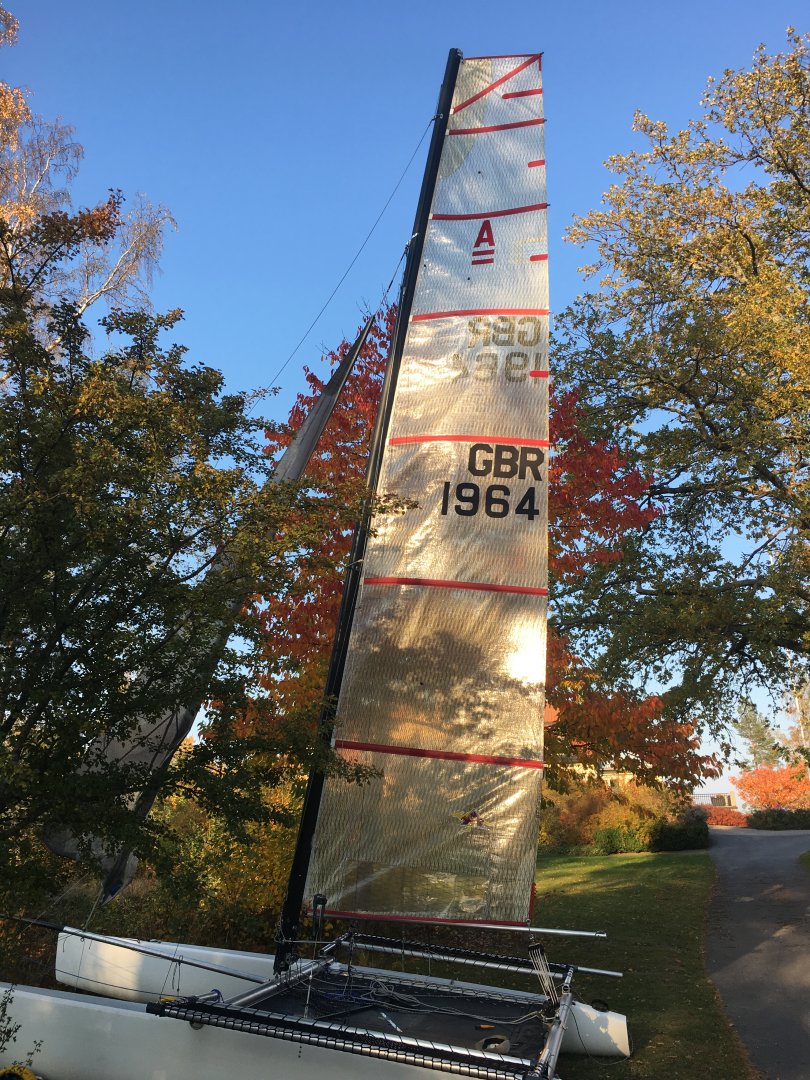

    Unfortunately the budget does not allow for a carbonfiber mast. Will start with a cut down old Sailspar Tornado mast, that has a surprising resemblence of todays A-class mast bend characteristics. The image shows the sail hoisted in my Frankencat1 F18 mast.

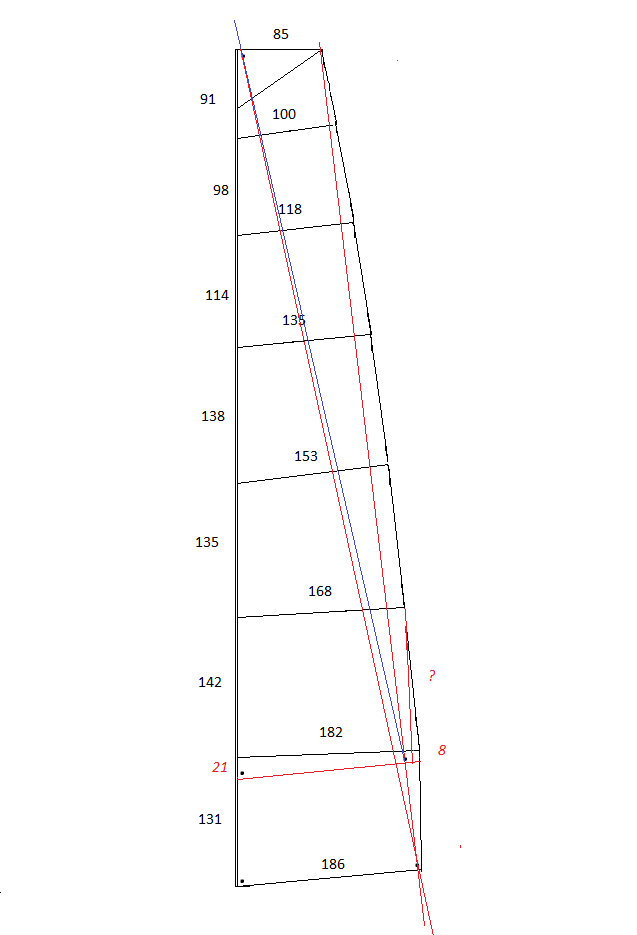

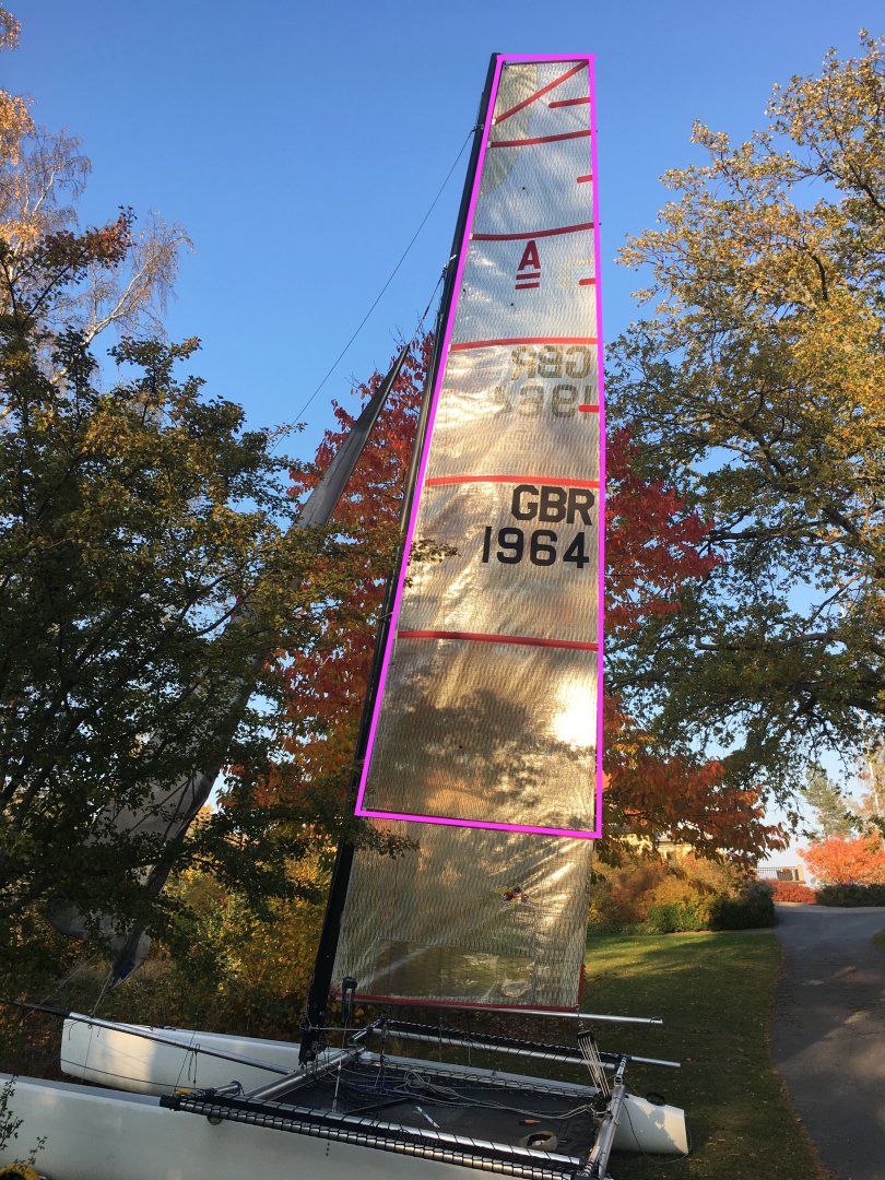

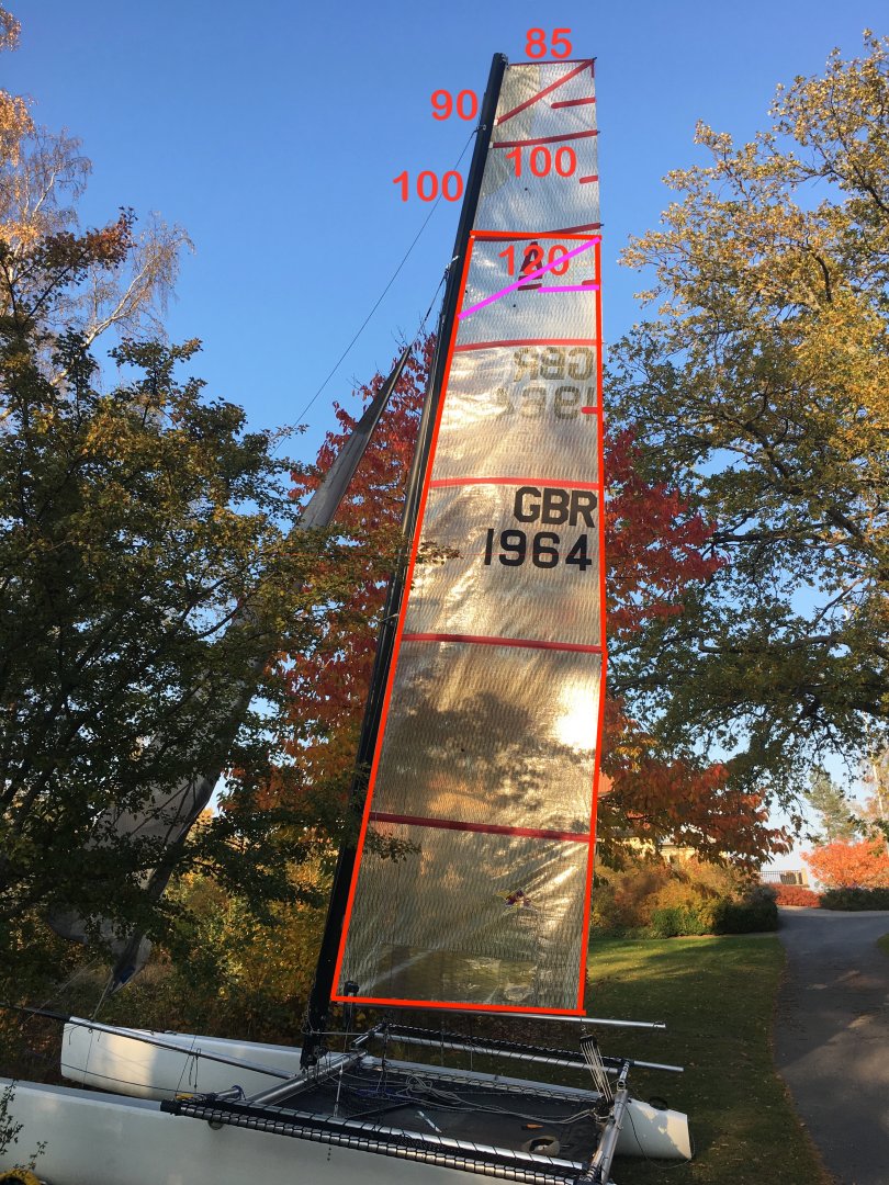

    Intend to cut down the A-class sail and instead add a 2.5 sqm jib as CoE needs to be lowered ca 1 m. Was first into cutting off the lowest panel, but Grant Piggott recommended me to cut the two top panels instead(blue batten). A little worried as the square top will then be almost 1,2 m. This will shorten the luff from 8.5m to 6,6m(1.9 m) and reduce sail area with 1.9 sqm.
    If cutting the bottom panel instead, the area will be reduced by 2sqm, when only 1.1 m is cut off.
    Any preferences?

    Decided to cut at the bottom like in the photo edited image. Cutting just under the first batten pocket removes 2sqm and also makes it possible to try boomless with a stiffer batten.

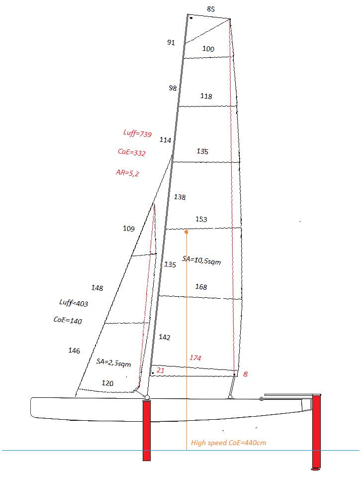

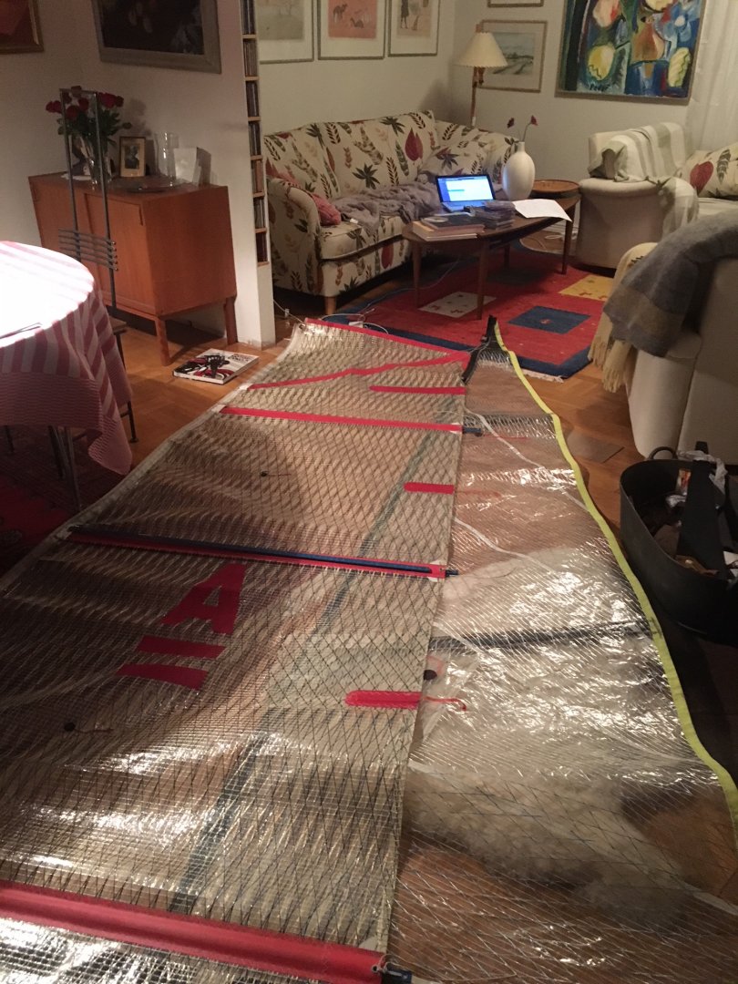

    Just began to cut down the main. The area at the end of the first batten pocket was heavily delaminated and damaged under multi layers of tape. It felt good to remove it by moving the leech 7cm further in.
    Two options of the rig, as shown or moving the forestay to the bow and run a full 4.7sqm 49er jib instead of the radically cut down at 2.5sqm. The latter will be just OK when the winds blow, though.

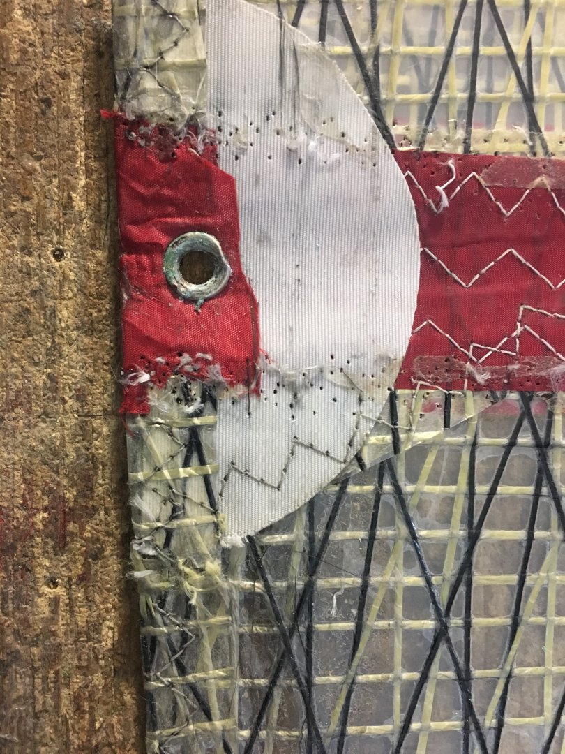

  9. revintage
    Joined: Nov 2016
    Posts: 276
    Likes: 48, Points: 28, Legacy Rep: 10
    Location: Sweden
    revintage Senior Member
    The old patches are reused and taped.
    Just some minor taping needed, before going to the sail loft to get the seams and the tack and clew eyelets done. IMG_2205.jpg
