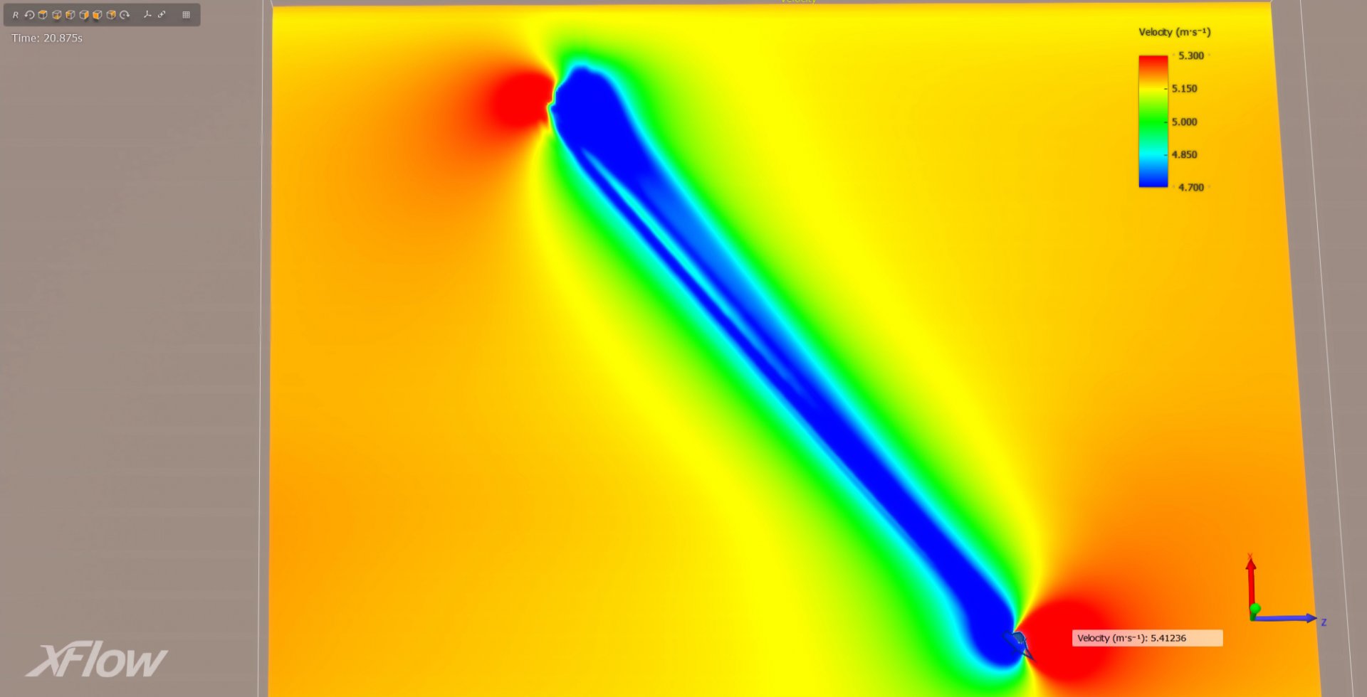

    I added a simulation in Youtube around the topic:
    Upwind, there is not that much difference to the sub-wind speed case, even if the bad air zone is wider and lasts longer behind the boat. Downwind, however, the bad air zone is totally different: When foiling at several times the wind speed, the wind shadow is left in the wake as a persisting wind shift, extending nearly right behind the boat and for a long time. There is no effect to the side or to downwind of the boat, as would be in the case of a traditional yacht, sailing at sub-wind speeds. You cannot speak at all of a wind shadow in the traditional meaning.
    In both cases, the influence of the bad air on the wind speed is small, while the influence of the direction of the wind is significant, nearly 30 degrees.
    The performance data courtesy of AC36 telemetry https://ac36.herokuapp.com/map. The simulation was performed by WB-Sails on Dassault Systèmes XFlow XFlow | High Fidelity CFD - Dassault Systèmes® https://www.3ds.com/products-services/simulia/products/xflow/.
    Comments/critics/interpretations/explanations are most welcome :)

    Nice simulations indeed. I am surprised that the reduction in wind-speed was only 3% at 45° true wind-angle. I would have expected some 20% reduction in the upwind case.
    Did you also try 100° true wind-angle? There one can expect much more reduction in wind-speed as the major effect.
    How fast is the wake-wash zone propagating downwind in your simulations?

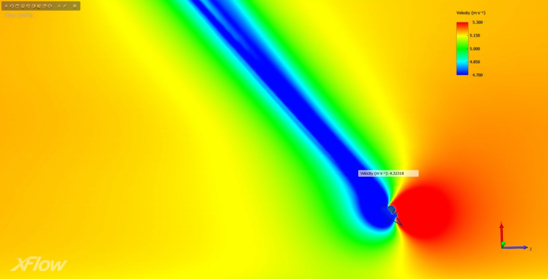

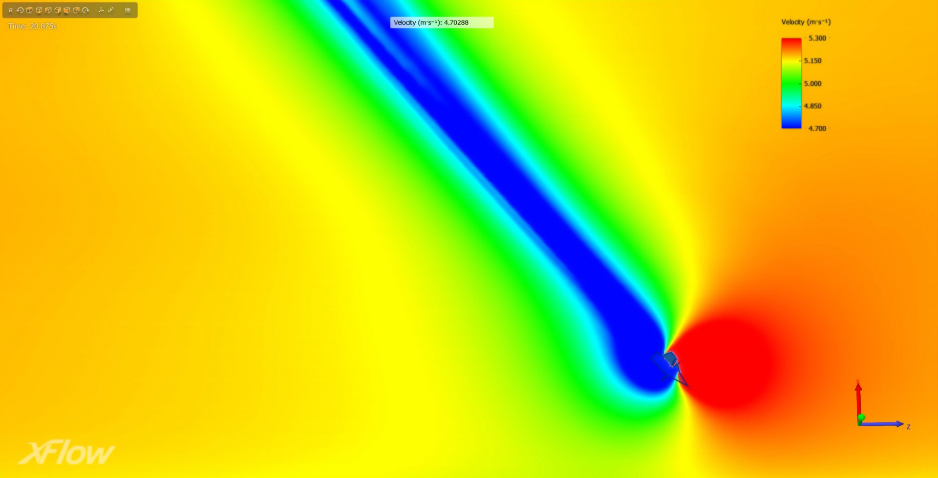

  12. Mikko Brummer
    Joined: May 2006
    Posts: 541
    Likes: 66, Points: 28, Legacy Rep: 258
    Location: Finland
    Mikko Brummer Senior Member
    Well it is, or nearly, 16% closer by and 8% further away. My reference velocity was 5.144 m/s, or 10 kn. In the video, I think the lower scale was at 4.9 kn, so all the blue is not really the lowest value there. Attached probing in the velo field shows how you are right.
    AlexanderSahlin likes this.
