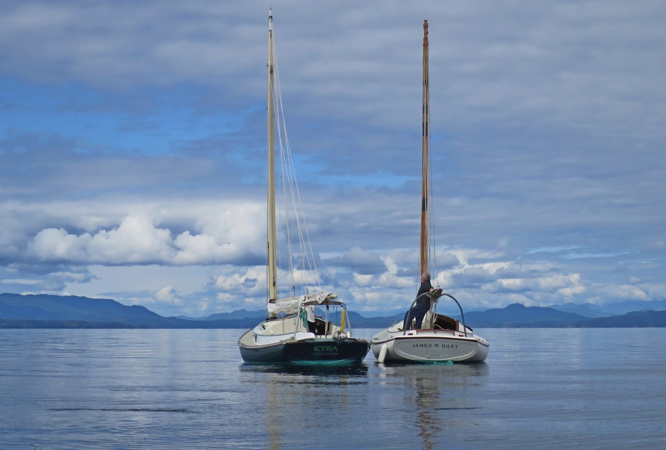

    James W Hart
    This year the catboat actually named James W Hart came up for sale near Courtenay BC and I talked some friends into buying it, and I helped in the transition of getting the boat to Cortes Island, where my boat lives.
    Here's a picture of the two boats rafted up halfway across Sutil Channel on a very calm September afternoon for a lunch break. Later on the breeze came up and the JWH won the race to Baker Pass because it's at least 600lb lighter in ballast.
    Next year, another Family Cat - Saoirse - will join us at the Shark Spit Regatta, full moon in August. Any other cats from Bill Boyd's shop up for a rendezvous?

    Beautiful picture, congratulations. Summer days......

    If you are going to talk friends into something, at least you talked them into buying a beautiful boat. I usually talk my friends into doing back flips off the second story balcony into a pool. You seem to be a much better friend that I. Nicely done!!
