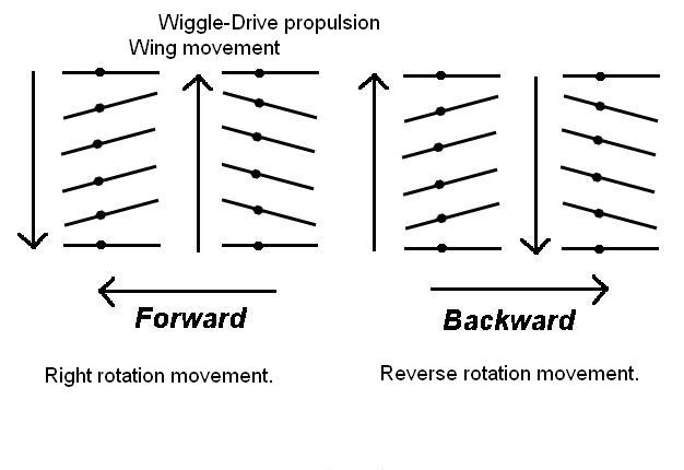

    The main differences are that the mechanical load in the Kjell-Wiggle-Drive is supported by Sealed Radial ball bearings and the Wiggle Head is not touching the rotating plate. The load in the Swashdrive is supported by Axial ball bearing touching the rotating plate. Both are moving the fin in the same way.

  5. kjell
    Joined: Aug 2005
    Posts: 271
    Likes: 5, Points: 0, Legacy Rep: 31
    Location: mallorca
    kjell Senior Member
    The thrust is produced by the “Kjell-Effect” produced by the angular movement.
