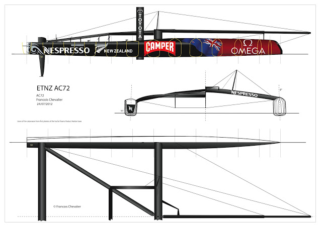

    I noted that the AC72 also had what I would call essentially square bottoms (hadn't seen that before either, thank you).
