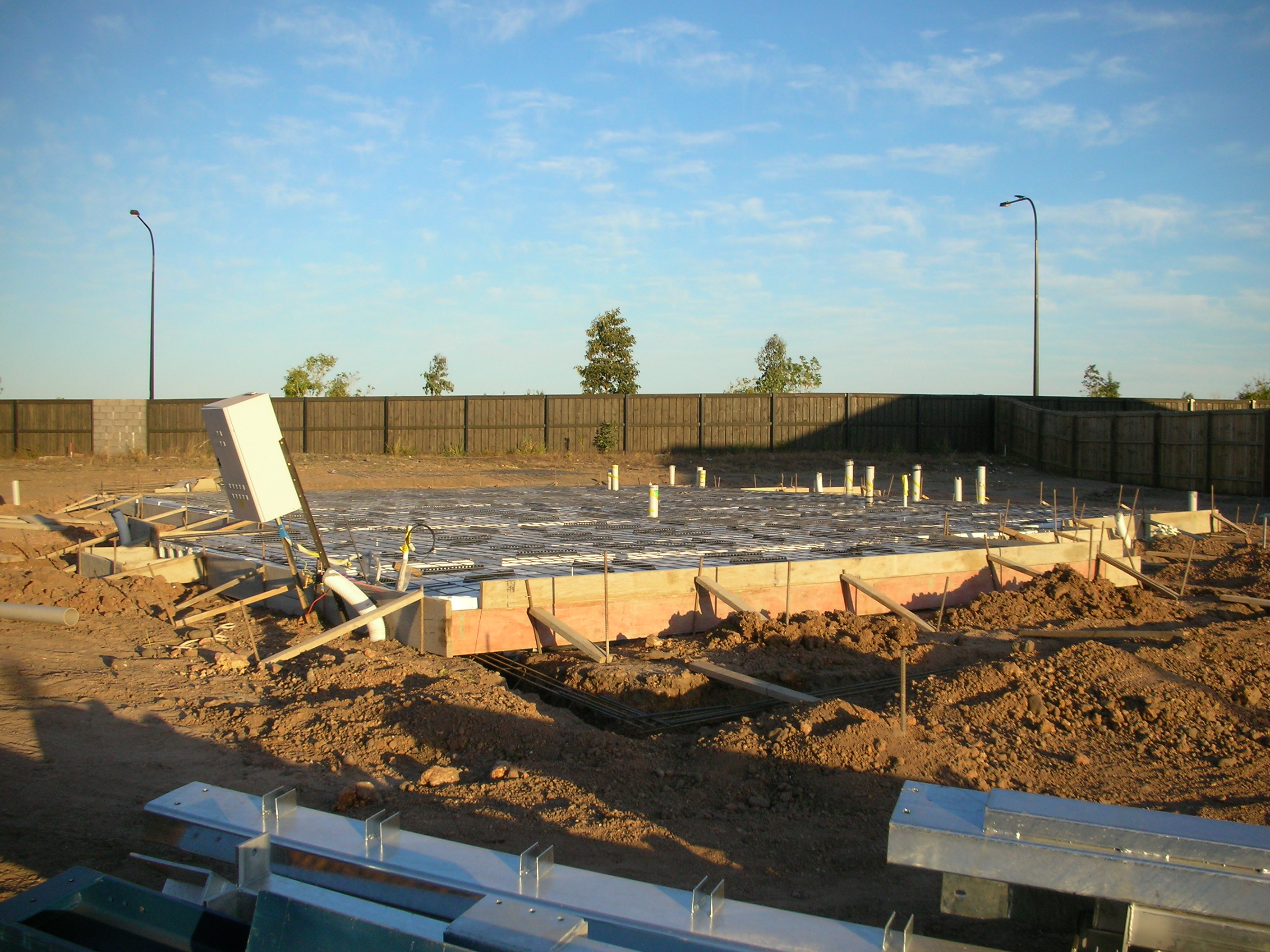

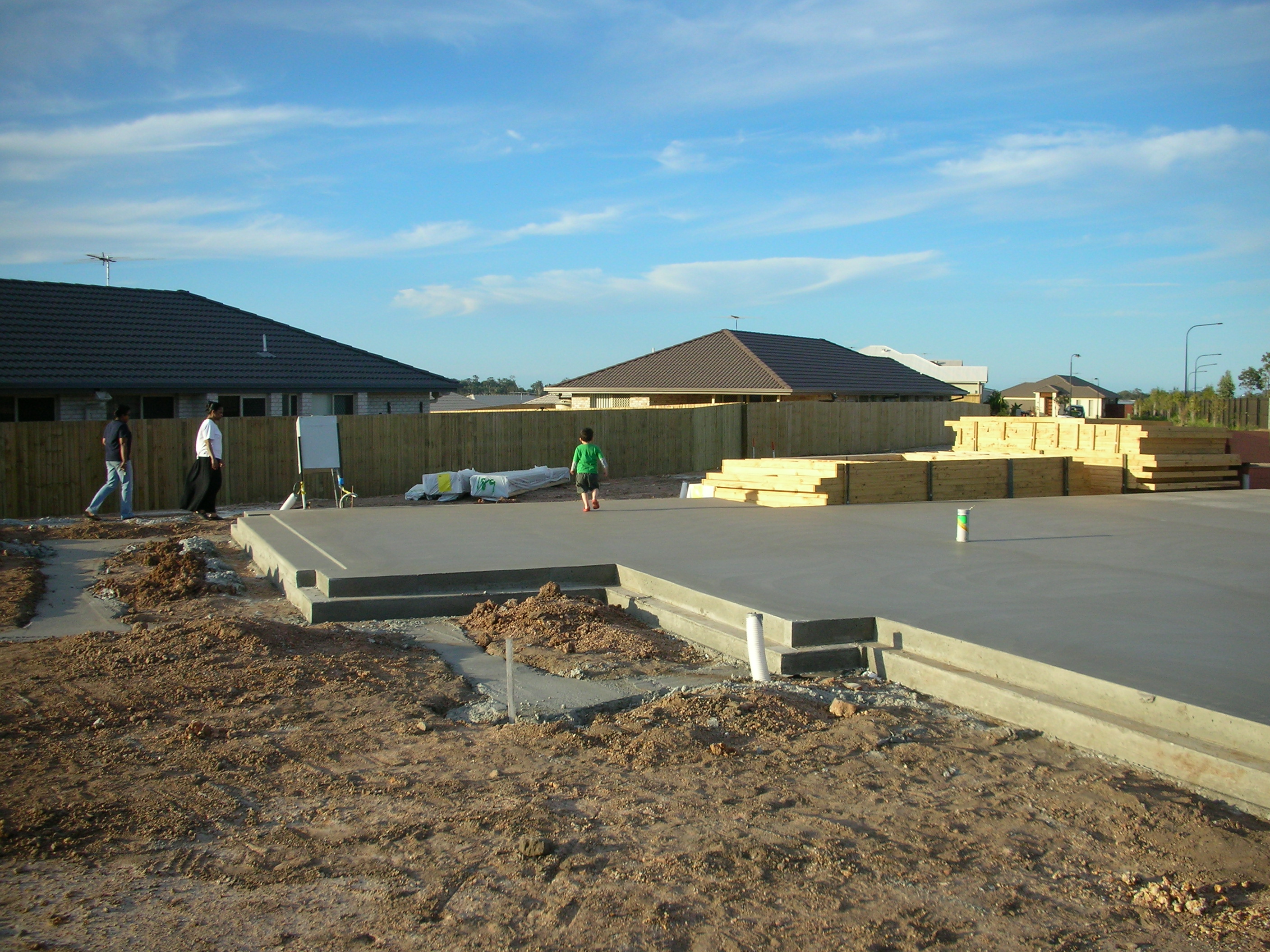

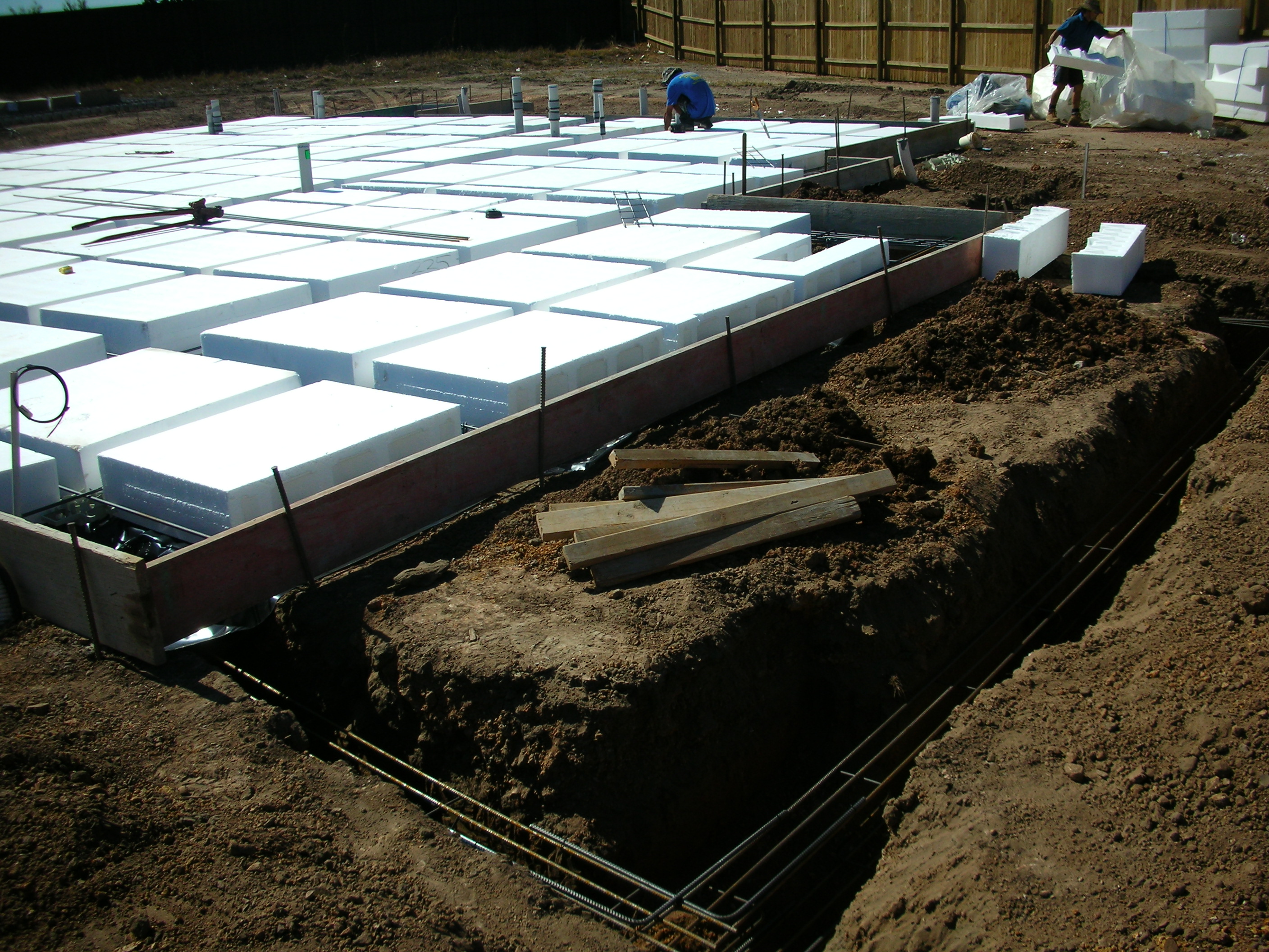

    Widen the footing and use lots of reo - you may have to do the whole house as on clay they usually set the foundations up to float as it moves over time with moisture content and a rigid "floating" foundation leads to a more stable structure...
    In this illustration, the footings go down about 3 feet, there is more reo to go between the foam panels and heavy mesh on top of the foam - here they are still fixing and tieing the reo-bar... The foam just reduces the volume of concrete in the pour, - which covers the foam by 4 to 6 inches - - see the second image... Apart from the footings, the slab sits on top of the ground (no one in Aussy seems to do "basements" as basements are bad news in a termite zone and bloody expensive to build down when going up is easier and catches the view and cooling breezes)...
