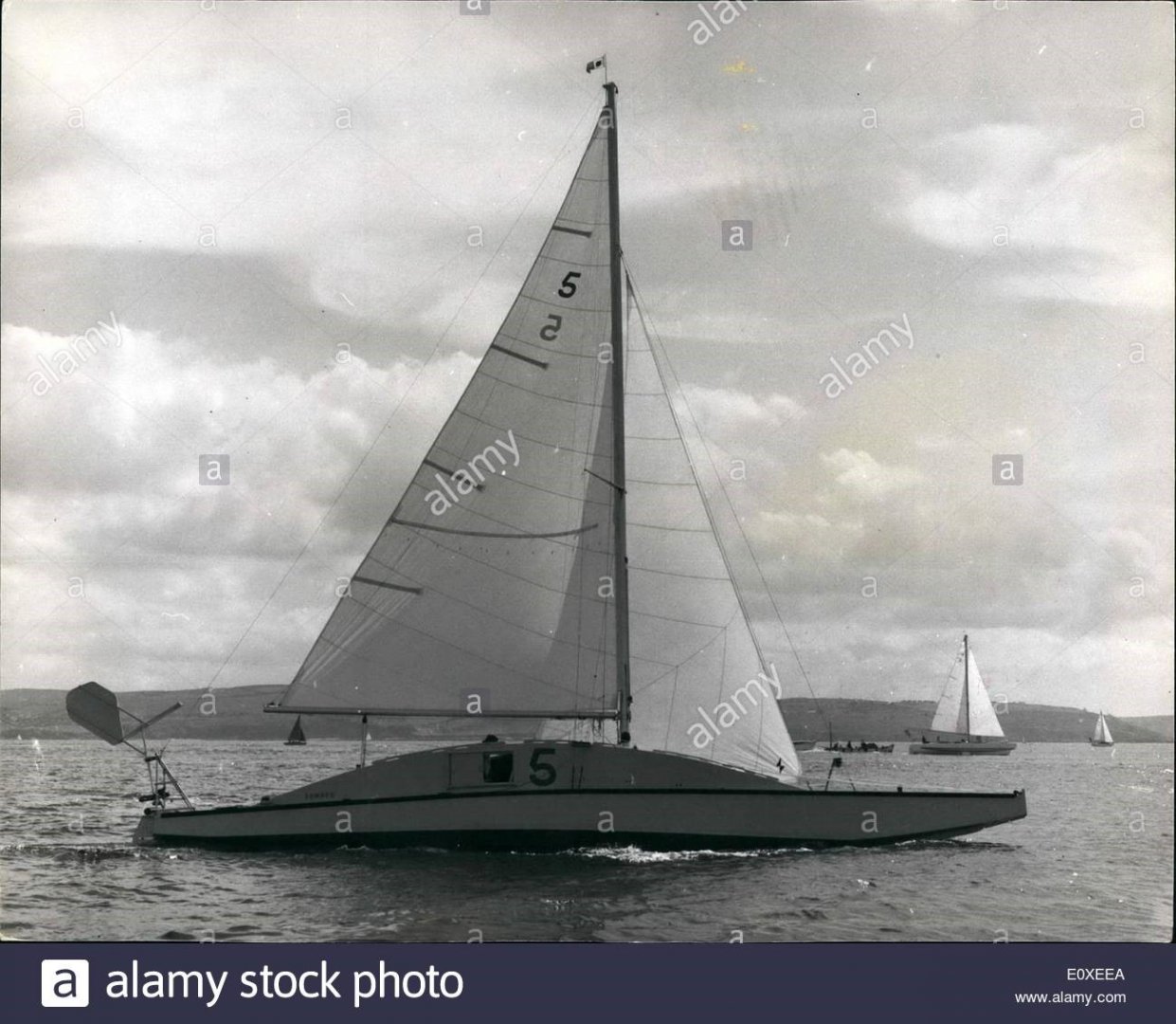

  15. Dolfiman
    Joined: Aug 2017
    Posts: 1,341
    Likes: 553, Points: 113
    Location: France
    Dolfiman Senior Member
    Good question. At first we should agree on a definition, what is the minimum requirement to call it an "ocean going sailboat" ?
    In my opinion, it is to put a frontier between poor sailing/drifting versus real sailing with upwind capability.
    For me, an ocean sailboat should be able of 4 knots minimum when upwind in force 3 to 5 wind, meaning a good enough hull design with a Lwl of ~ 5m at minimum (at Froude ~ 0,3). That could be done with a relatively short mast, here we can make a little sacrifice on performance by wind force 1-2 , very little sacrifice if you can put also a light gennaker from true wind angle 60 deg. So just 4 sails : main, jib, gennaker, stormy jib.
    The second point is the stability, in particular the ability to recover from an upside down roll, meaning a high AVS and a high ratio positive area/negative area under the Gz curve (i.e. poor stability upside down) . Anf of course, the boat should be seriously watertight when necessary.
    The minimum comfort you are ready to accept for a several months crossing, could be resumed by the cross section : minimum headroom x minimum beam. Something like 1,4 m (to sit with comfort) x 2,2 m (two berths 0,7 m + corridor 0,6 m+ margin)
    The maximum leg envisaged and the related payload : an ocean crossing could be 3000 to 6000 NM, let'us consider 6000. A circum navigation is 4th time this length. The boat length (from the minimum 5 m Lwl) derives from this choice : here, one can consider Froude ~ 0,2 as the average speed made good :
    5 m >> average ~ 2,7 Knots made good >>> duration ~ 92 days
    6 m >> average ~ 3,0 Knots made good >>> duration ~ 83 days
    7 m >> average ~ 3,2 Knots made good >>> duration ~ 78 days
    Again, the length is an important figure, contributing to reduce the payload for a given crossing, not to mention the fun to sail a real sailboat. The "small is beautiful" appeal can be misleading if small applies to the boat length only, better for a cost or weight approach.
    I remind you the Blondie Hassler approach with his Sumner (Loa 46 ft x B 6,75 ft, photo thanks to Alamy) , underrated in my opinion, a modern low cost version would worth to be designed.
