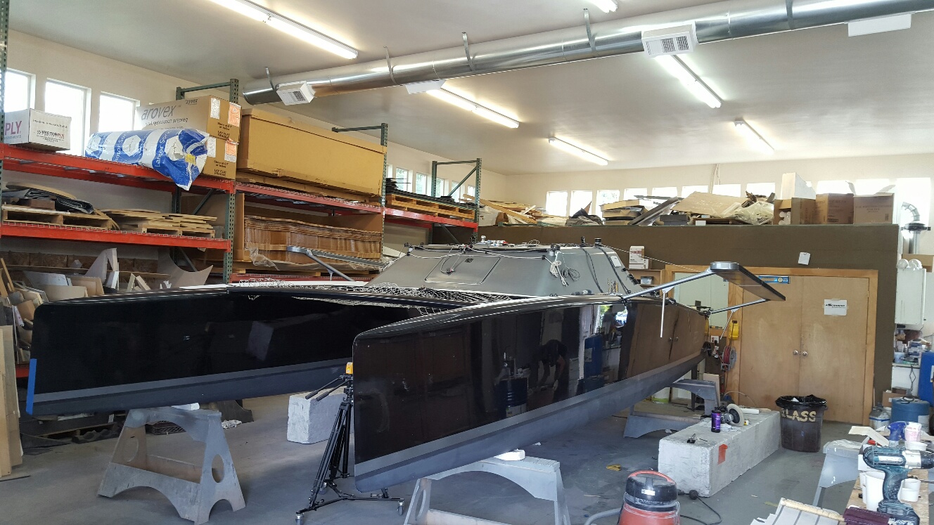

    would love some detail as to how you created the stem. Formed it on the bow in place or infused a flat profile and inset it into the bow? Photos much appreciated.
  10. Turnpoint
    Joined: Jun 2011
    Posts: 46
    Likes: 6, Points: 8, Legacy Rep: 10
    Location: Port Townsend
    Turnpoint Junior Member
    We built the hulls in one off female molds from Carbon prepreg and Nomex---the hulls split down the centerline. We included a tapping rebate along the seam and terminated the molded bow shape as a rounded 1/2" radius. Once the two hull halves were bonded together and the seam was taped, we then started laminating the bow edge by hand. The outside layers of the laminate tied into the rebate that was molded into the bow, while we clamped on a piece of Melamine to act as a temporary mold surface. I think I would have to sketch something up to explain this more clearly.... but here are some pictures of the boat and in one you can see how fine the bow shape is.
    fallguy likes this.
  11. UpOnStands
    Joined: Nov 2015
    Posts: 681
    Likes: 15, Points: 18, Legacy Rep: 16
    Location: Sydney
    UpOnStands Senior Member
    Thanks for info and the photos. That is one wicked-fast looking boat. The melamine temp mold makes sense as does the centerline split. Bows that fine would almost impossible to infuse reliably w/o the split. This is more for another thread, but what did you use for foils? I assume daggerboards but you have hidden them well. edit: found port board up in racing photo.
    Zero powered winches, you have foot power for winching. Lots of good stuff.
  12. Turnpoint
    Joined: Jun 2011
    Posts: 46
    Thanks UpOnStands,
    We put in all the bulkheads while it was still in the mold and then lowered the other hull half onto that to insure everything stayed true... with such sharp bows it is very easy for them to wander-- both pulling to one side and or having a ripple across the centerline. This makes glueing them up in a precise jig extremely important
    (The boat is only 24' and 750 lbs ready to sail...so just need two tiny winches for halyards and 10:1 on main sheet. We designed and built her for the race to Alaska...so the pedal drive is for propulsion which is allowed in the race. The boat has high aspect ratio foils all around. The first year we had straight foils, last year we had curved foils with AOA control, and right now we are building some z-foils that will get her completely flying. Rudders have always had t-foils on them for pitch dampening which can be a killer in a small cat like this in big seas...but this year the t-foils get a little bigger to help stabilize the boat in flight. Sorry about the drift)
