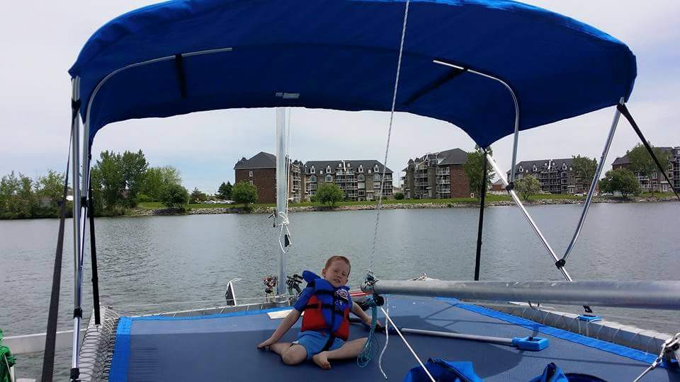

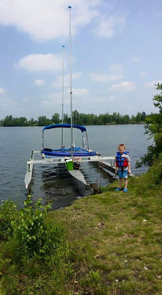

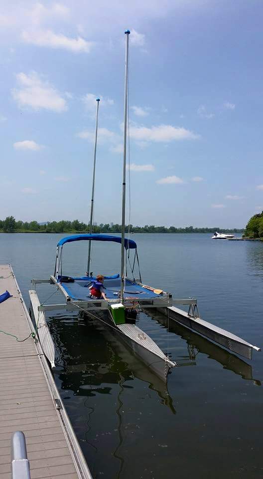

  9. valery gaulin
    Joined: Jan 2017
    Posts: 177
    Likes: 4, Points: 18, Legacy Rep: 7
    Location: Montréal
    valery gaulin Senior Member
    @Corley: Look dude my first intention was only to ask if someone as tried Round blunt bow hull shape for a catamaran. I am intrested in learning from others good and bad design, before trying it myself. Where else do you want me to ask this question than on a boatdesign forum???
    Second when the time will come I will try a model to see if it coild be a reasonable compromise with all the pluses and minuses of such a design. But if someone has the experience with this shape I would like to know.
    Third, It did built a trimaran. The design needed to be capable of sailing in a bay where there is only 2 feet of water, single hand, capable of trailering and putting in the water by myself in less than 30 min. Capable of going 8 knot with a minnkota 12vdc 55 lbs trust. Relying only on hull shape for leeway because of the shallow water and the single handling at the same time being responsible for a 3-4 year old son while sailing. All this was achived with this design. Also it needed to be built with aluminum, with simple tool, for strenght if it hits bottom, and for weight, all this was done without being welded with very simple tool in my Garage.
    It is not a perfect design but for where I am using it and for my need it is very clise ti perfect for me.
  10. valery gaulin
    Joined: Jan 2017
    Posts: 177
    Location: Montréal
    Here are some pictures i found on my cell.
    @Corley: Before being rude to someone for asking questions on this design forum website ask yourself if it is a constructive comments or not. If your answer is no than keep your comments to yourself.
  11. bjn
    Joined: Jul 2014
    Posts: 135
    Likes: 8, Points: 18, Legacy Rep: 16
    Location: Stockholm
    bjn Senior Member
    Very nice boat Valery.
    Impressive!
