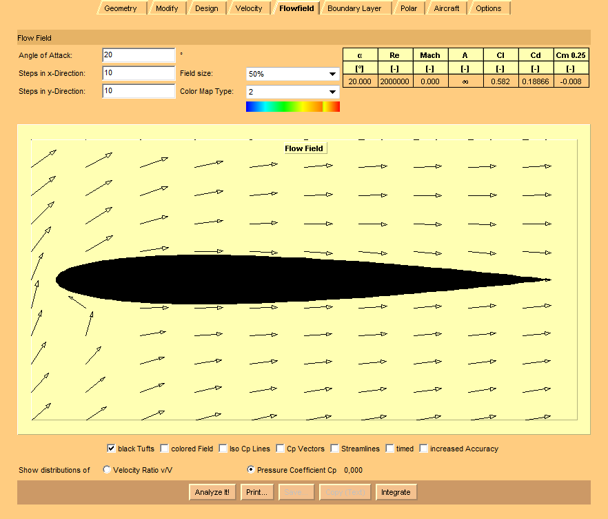

    Wouldn't it be better with a more rounded bow than the typical pointy bow?
    Like a NACA 0010, on a hull with 10:1 slenderness ratio, for example?
    Im suspecting a pointy bow is creating drag from detached flow when the hull is making leeway?
    That would be the case with a foil with a too small leading edge radius.

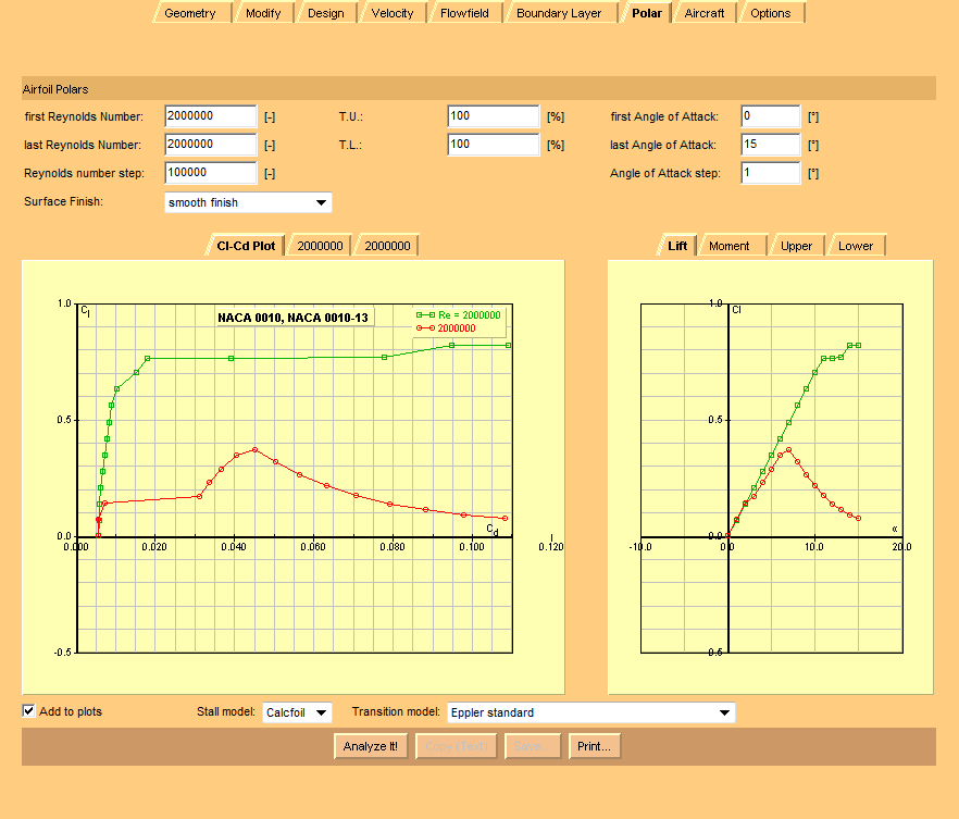

    I had never thought about it that way, but I think it's not only about angles. The foil has to have a significant leading edge radius. Otherwise the "backflow" from the high pressure side to low pressure side, which is flowing in the opposite direction of the fluid and back around the leading edge of the foil, will cause the flow on the low pressure side of the leading edge to separate, if the radius is too small.
    See attached pictures. Last picture shows the "backflow", at an exaggerated 20° angle of attack to see the effect more clearly. The NACA 0010 has a 1.1% leading edge radius. I compared it with 0.11% leading edge. As you see the in the polar diagram, drag increases a lot at 4° angle of attack on the pointy foil, which I assume is because flow separates. This doesn't happen until 10° on the normal foil. When I tried with a smaller radius, it happened at 2°.
    But I understand from the replies that the shape of a hull is much more complicated than a foil in 2D shape. The flow is 3D, because is moves also under the hull. And the volume distribution is an important factor. So there are more things to consider than the shape of the hull when seen from above.
    The tornado has a leading edge radius though. 30mm or more, from what I recall. It might be enough for the leeway angles it has when sailing, as you suggest.
    The reason I started to think about these things is that I made a hull (proa) with very sharp bows. And now I'm afraid it will be draggy when making leeway.
    Picture:
    Thanks for a good reply! good points!
    I'm not sure I understand or agree with the bold part though. I understand the NACA foils are used as rudders and centerboards, even though they have this blunt leading edge. Airplane fuselages aren't pointy, except the hypersonic jets.
    Could it be that when swimming fast, fishes are using short strokes / low angle of attack?
    That sounds very plausible, thanks. So the bows on my hull is actually very good?

    When the hull is acting as a foil and generating lift it's extremely low aspect ratio, so it's water flowing under and around it that's going to do most of the equalizing, not backflow forward past the bow, unless it's an extremely narrow beam deep draft hull, in which case excess wetted surface area is going to be a bigger concern (also lack of righting arm in a monohull). Leave the lift to appendages under the water, they are much better at it than hull form.
