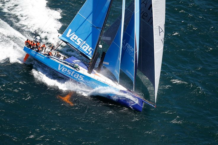

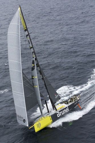

    I don't think observations of racing rigs is very valid. There are so many design and operational issues that drive the optimal racing rig.
    A racing boats SOR and design is driven exclusively by the lightest rig that will drive the boat with the most power to suit the righting moment. Around the buoys the speed of sail handling is also critical. Also a buoys racer isn't interested in the best long term SOG, just the fastest direct buoy to buoy route.
    Long leg racing boats as you say use multiple headsails very effectively and for good reason. Ditto for cruising boats.
