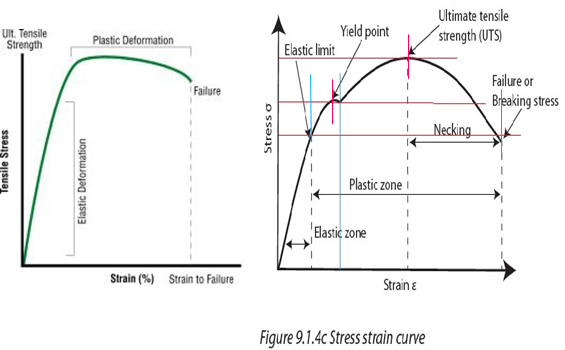

    Fair enough although you directed it to me. But as requested by others, I am attaching the source.
    The stress/strain curve is what you will see from a typical coupon test. The curve reaches a point at at which the resin cracks, goes up a little then goes down again before going up. This is the "knee" where the resin cracks and reaches its equilibrium. Note that this is far from its ultimate strength, and far from rupture. This is proof stage where the stresses normalyses.

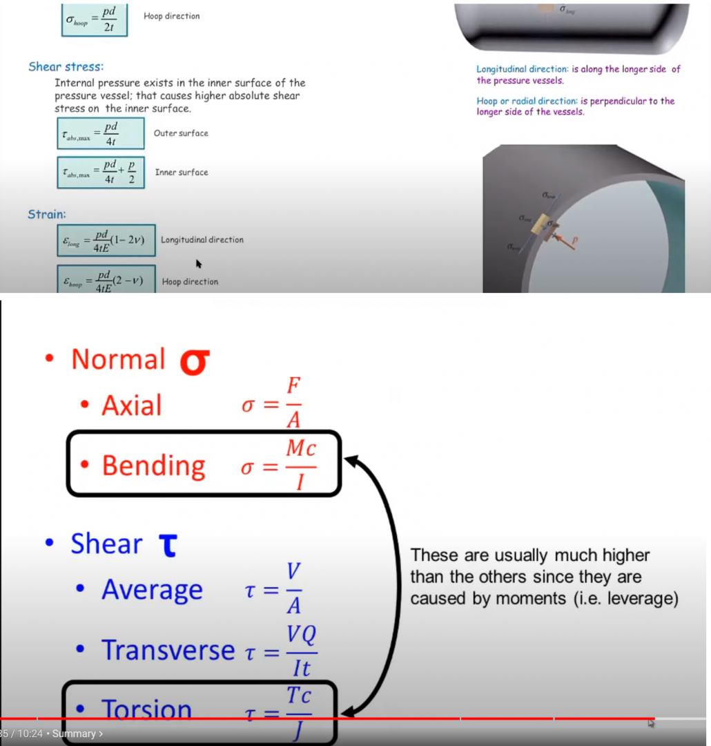

    Victor Vescovo and James Cameron seems to have the same apprehension about the use of CFRP and the Hydraulic engineers seems to confirm this compression/decompression "dieseling" effect about trapped air bubble.
    Following S Mayer's walk thru analysis of design, I did some analysis. It seems they did it correctly with 5" wall thickness with High Modulus CF. However the video showed only the cylinder being wound with radial/circumferencial/tangential fibers. Following S Mayers data, seems the shear strain is very low.
    It is further aggravated that the form is a cylinder and have a much higher stress calculation requiring helical or polar winding to be included. Using standard engineering formula, it failed in the shear analysis if only hoop winding was used. The data I have is only 10-11 kpsi for hoop shear strength for a HSCF and I am getting 26.6kpsi calculated stress. A certain percentage of helical fibers would solve the problem.
